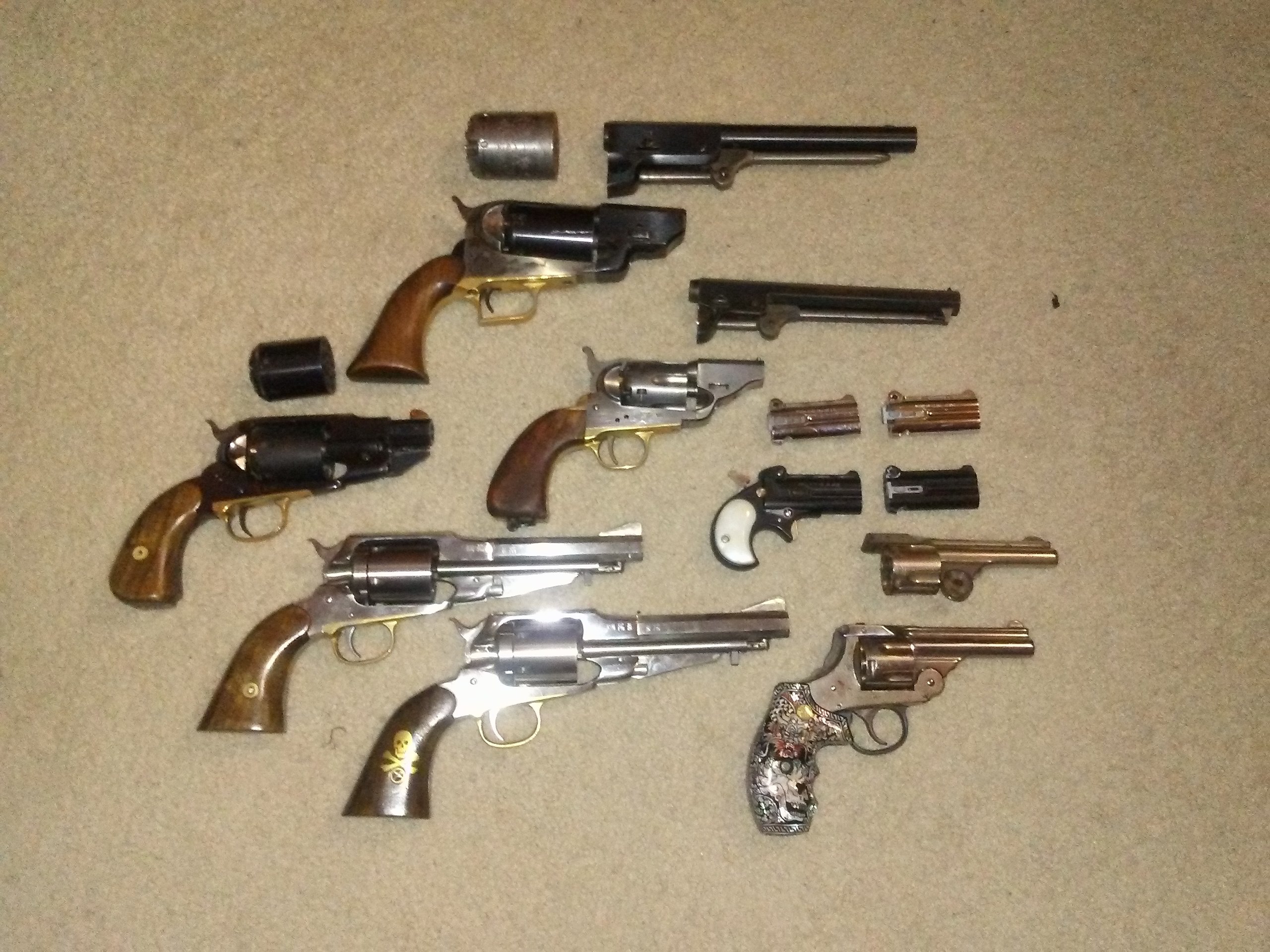

Boomstick Bruce Posted July 11, 2019 Posted July 11, 2019 Did someone say "frankengun"?!?!?!?!?! Here's my collection of what I would have built back in the day... Top: my snubbie Walker with a 45 Colt conversion and original 9" barrel. Under that my snubbie .36 colt 51 "Navy" with fluted cylinder and standard barrel. To the left, my snubbie "belly gun" 58 Remington with custom birdshead grip and 45 Colt conversion cylinder. Far right my Cobra derringer with .22lr, .22mag, .25acp and a 32acp barrel I modified to chamber 32 s&w. Under that is what I actually call "the frankengun". I built it from spare parts I've accumulated over the years. It's an h&r top break with a 38s&w barrel and cylinder fitted to it and a 32s&w long cylinder and barrel fitted to it. It also has some s&w j frame grips fitted to it. Take out one screw and I can quickly change calibers. It's my side match gun. And lastly, my pair of stainless 5.5" Uberti 58 Remingtons with gated Kirst 45 Colt conversions and Mason style ejectors. Fitted to them are front sights for a hawken rifle I reshaped and fitted. They also have Wolff mainsprings for a SAA installed. Those are my main match guns and my pride and joy. Next guns I build for main match guns will be octagon barrel 5.5" 75 outlaws... In 45 Colt, of course...

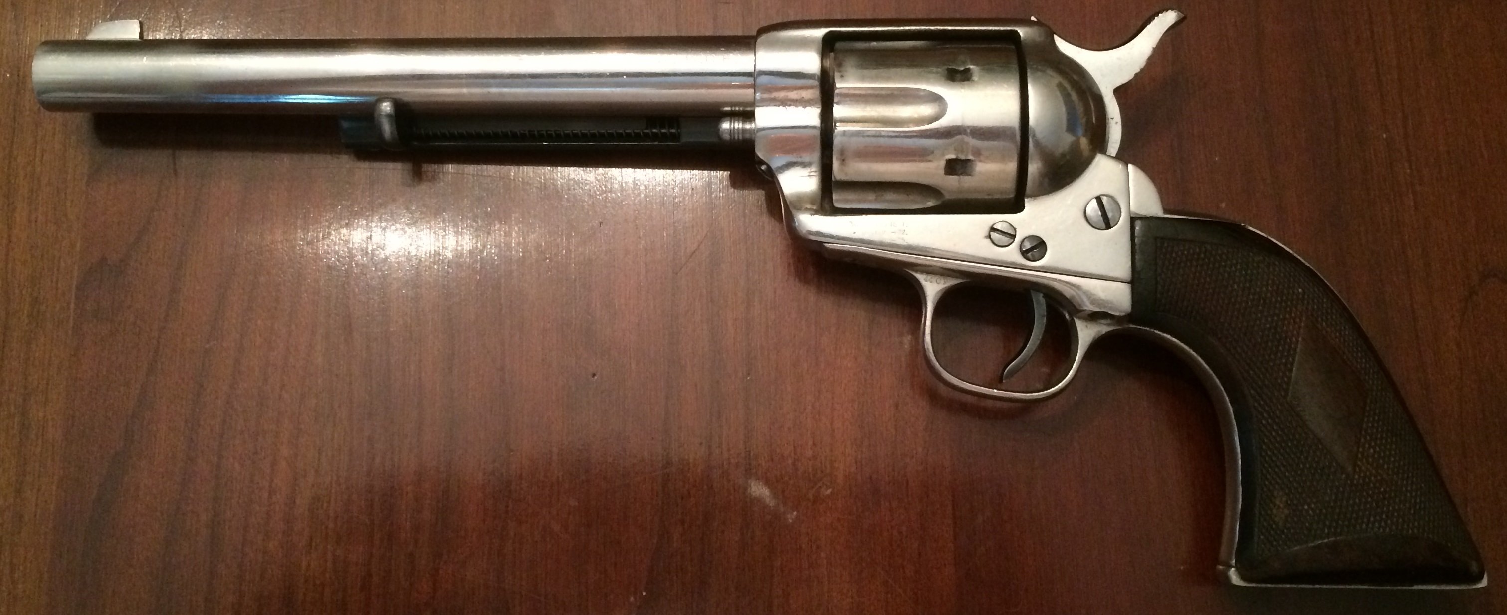

H. K. Uriah, SASS #74619 Posted July 13, 2019 Author Posted July 13, 2019 And speaking of .32-20's... According to its factory lever, it left the factory in 1881 as a .44-40. It is currently a .32-20. Colt has no record of the change, but one gunsmith I showed it too, said it has the loo of something done in the 1920's. I have no idea. Not super Frankenish, but it's clearly not in its original configuration.
