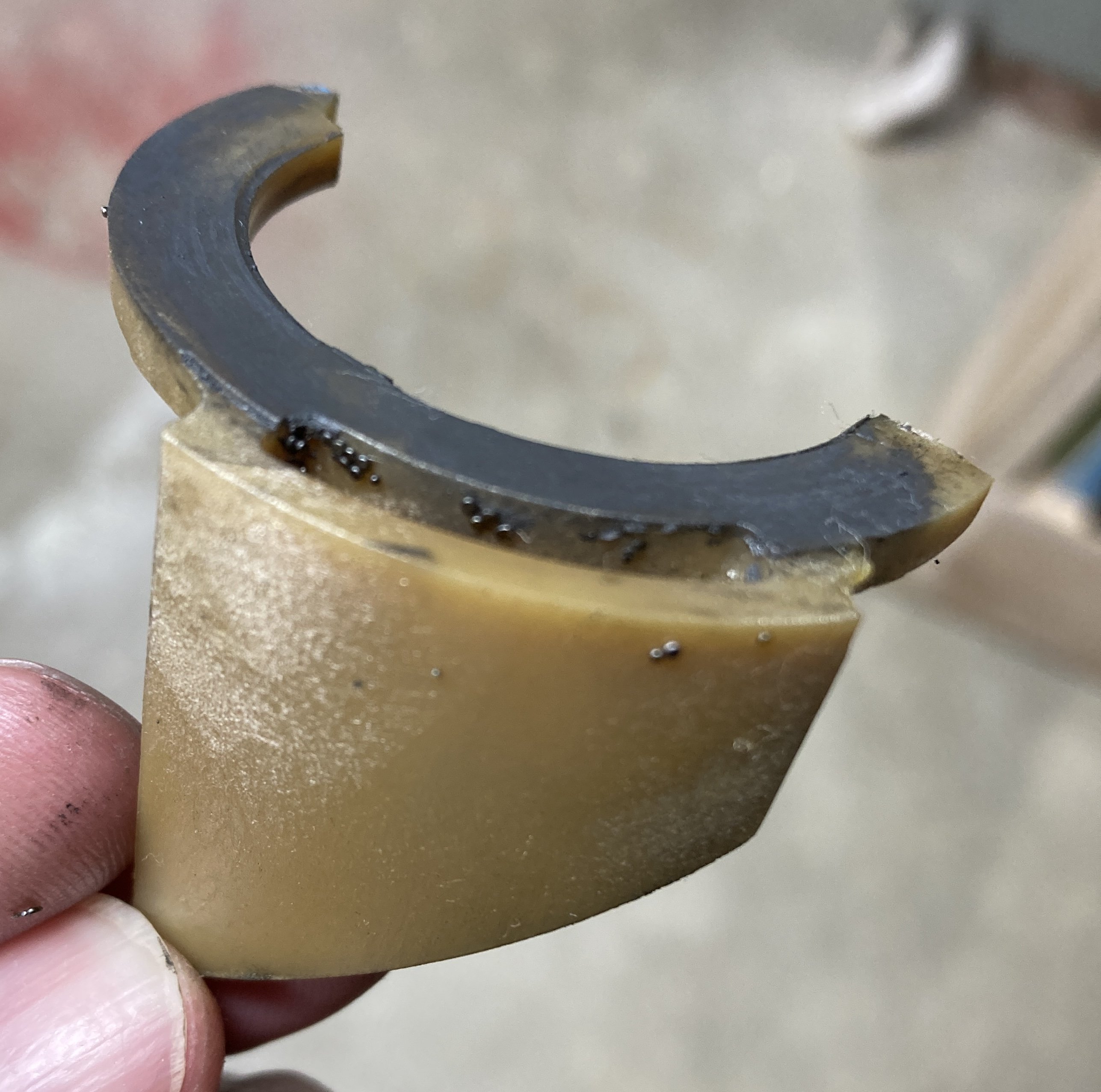

Matthew Duncan Posted February 20, 2024 Posted February 20, 2024 Reloading some 223 this morning when I got a double case feed. How did that happen? Shell plate didn’t index. Why didn’t the shell plate index? Further investigation revealed a half of a plastic ring laying at the bottom of the press. Bummer. What was an auto indexing press is now a manual indexing. Fortunately I have 45 Colt reload for most if not all of this year’s SASS season. Emailed Dillon of the situation requesting #13677 Ring Indexer. I just love life time warranties. I got mixed emotions IF I’ll need to shipped it back to Dillon. I’ve got the 650’s original shipping box, not looking forward to having tear the press down to ship it back. Dillon website said up to three days for a reply. Patience pilgrim. Patience.

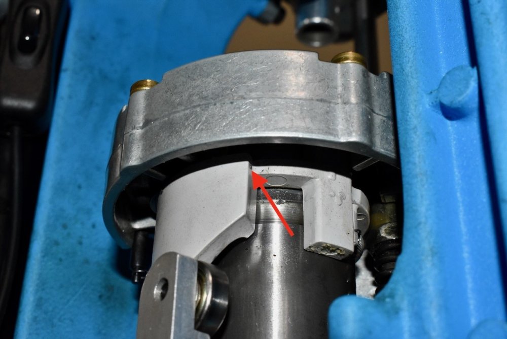

Larsen E. Pettifogger, SASS #32933 Posted February 20, 2024 Posted February 20, 2024 The most frustrating problem I have ever had with my 650 involved the ring indexer. I was getting some cases that the primer was getting squashed going into the case or turning sideways and getting mashed into the primer pocket. I fooled with the machine for hours trying to find the problem. Took apart the machine to examine the parts above and below the tool head. Everything looked OK. Then when putting the ring indexer back on the ram I noticed it spread apart just a bit. Turns out it had broken right where the thin part of the ring joins the ramped section. It was opening and closing at random and was not visible just looking at the ring indexer. You could only see the break when you pulled on the ring on either side of the break and it spread out. Broke right where the red arrow is pointing. Fortunately I always keep some spare parts on hand and Dillon is just down the road.

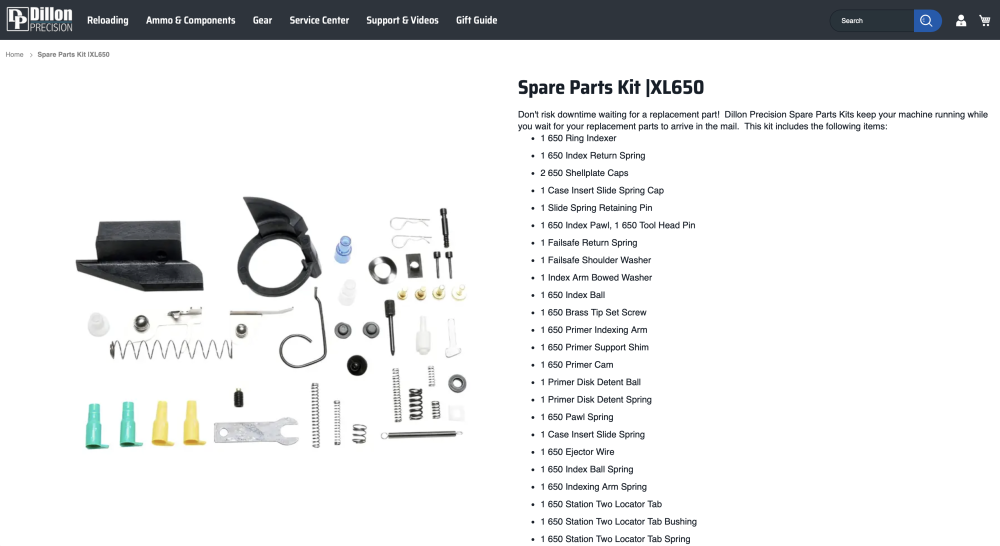

TN Mongo, SASS #61450 Posted February 21, 2024 Posted February 21, 2024 Larsen's advise on having the spare parts kit is right on the money. Having the spare parts ready to go have saved my bacon several times. It seems like something always breaks while I'm loading for a big regional shoot and I need the part immediately.
Dusty Devil Dale Posted February 21, 2024 Posted February 21, 2024 Dillon's new 650 Ring Indexers are, sadly, not what the old ones were. They appear to be made by 3D printing, and the material is very brittle. My older ones were a fibrous plastic, like the one in your image. The new ones break much more easily, even with a roller bearing cam, so I've been buying them 4 at a time. The warranty won't cover more than one at a time. There is no need to ship the press to Dillon. They come with full installation instructions and they have a video online. Easy peasy! I found a couple after-market aluminum indexers online, but one was a company in Slovania that I don't trust to give credit card info to. The other was a CNC machined one made in Washington State. I ordered one, but I do have some reservations that Dillon may intend the indexer to be a sacrificial easily replaceable (weak link) part to prevent other major damage. I think there will be risks using the aluminum one, so I'm still thinking on that before I install it. The first rounds will be VERY light- handed. My particular problem is that my wife shoots .32 H&R Mag in her revolvers, so it occasionally happens that with my ageing eyesight, a .32 case hides inside one of my .38s and when I deprime, the force bends the deprime pin and snaps the indexer.
