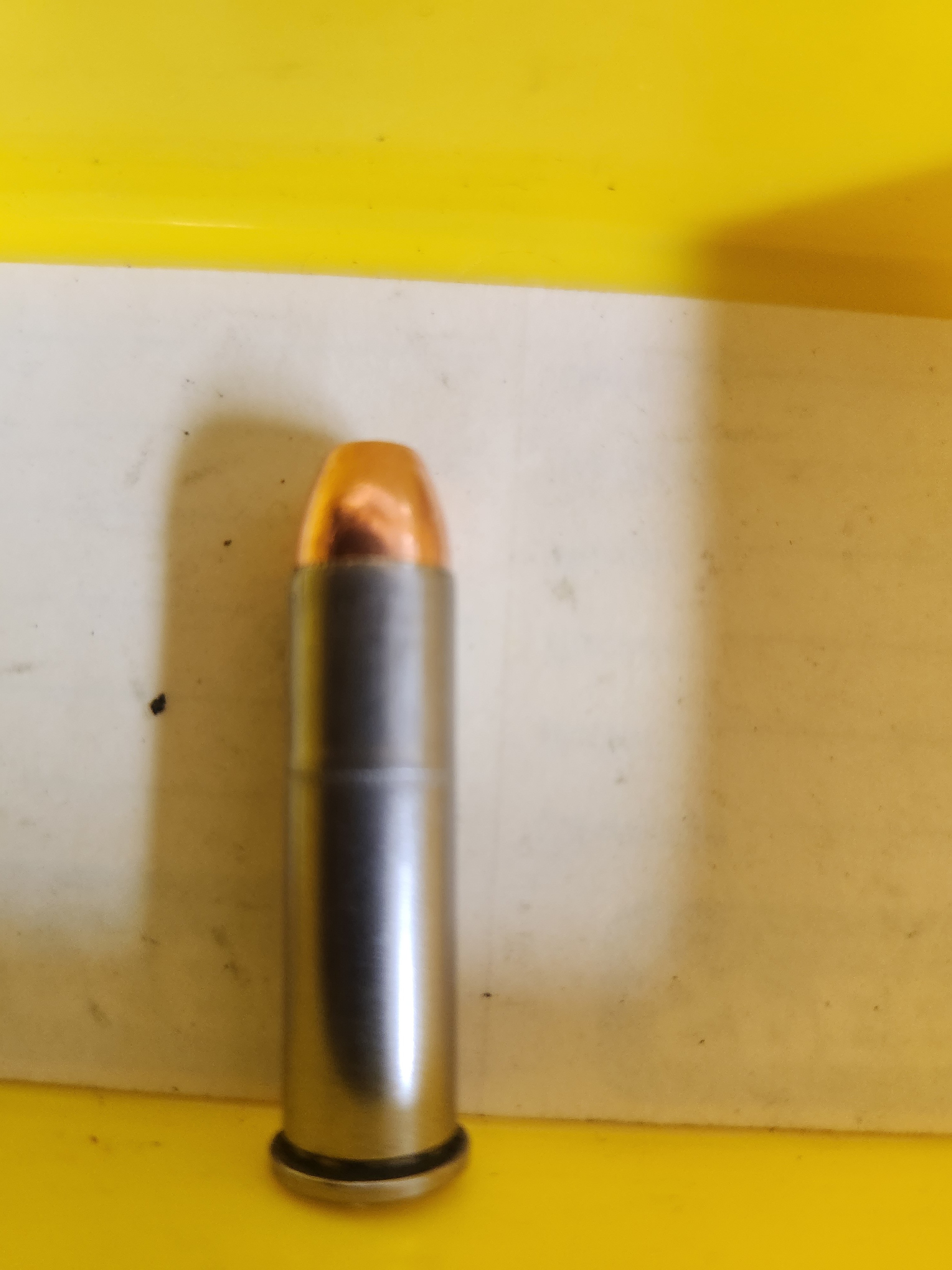

Wait... What ?? Why can't I use these in My Henry Big Boy ?
Sudsy
Bought these quite a while ago, finally cracked the box open to whip up some 38+p's
When I opened the box saw the "Don't use in a tubular magazine" warning
They're not round nose, not pointed, so why not ??
Just a guess, but looking at the bullet, it appears to NOT have a cannelure.
Therefore, bullet recess down in the case is a possibility when put in a mag tube under strong spring pressure.
If that bullet were to be pushed down inside the case, pressures will spike...... and the results might not be to nice.
..........Widder

If you want to play on the safest side, shoot them in revolvers.

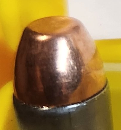

Look at the photo and then open it in a separate tab so you can see a larger version.  The crimp looks about right then.  As mentioned, the nose should be fine since it is relatively flat and has rounded edges.  So they may be fine with light loads, but as others have noted below, the harder surface would increase the risk over lead.
If you have a reloader, you could re-crimp them just a tiny bit tighter to have a little more confidence.
With TMJ bullets, they won't crimp as deeply as they would with softer lead but will still have very good tension on the bullet.

Could this be a generic sticker that goes on all their boxes?
@Sudsy
Those are your hand loads, correct?
What you bought were just bullets, not cartridges, correct?
If so I would go ahead and shoot them, though I prefer a heavier crimp.
My uninformed WAG - There is no guarantee that the cartridges will line up exactly as shown in the patent drawings.  A slight misalignment MIGHT cause an edge of that flat to rest on the primer.
Looking at ALL the pictures, the round(s) have sufficient crimp.  The flat point is sufficiently "flat."  I use to source a  130Gr Truncated Cone shaped exactly like that.  Fed thru my .38 rifles like grain thru a goose.  All that said:
The Mfgr. of the subject bullets is applying some SOA notification.  The way .38 cartridges "tilt" in most tubular magazines might/could allow sufficient angle of the dangle for the nose to impact a primer just right with sufficient recoil.  The result would not be fun at all.
