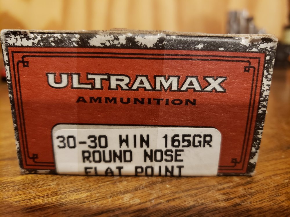

Dantankerous Posted September 16, 2022 Posted September 16, 2022 I've shot this off hand out to 100 yards and it works great if you can find some.
