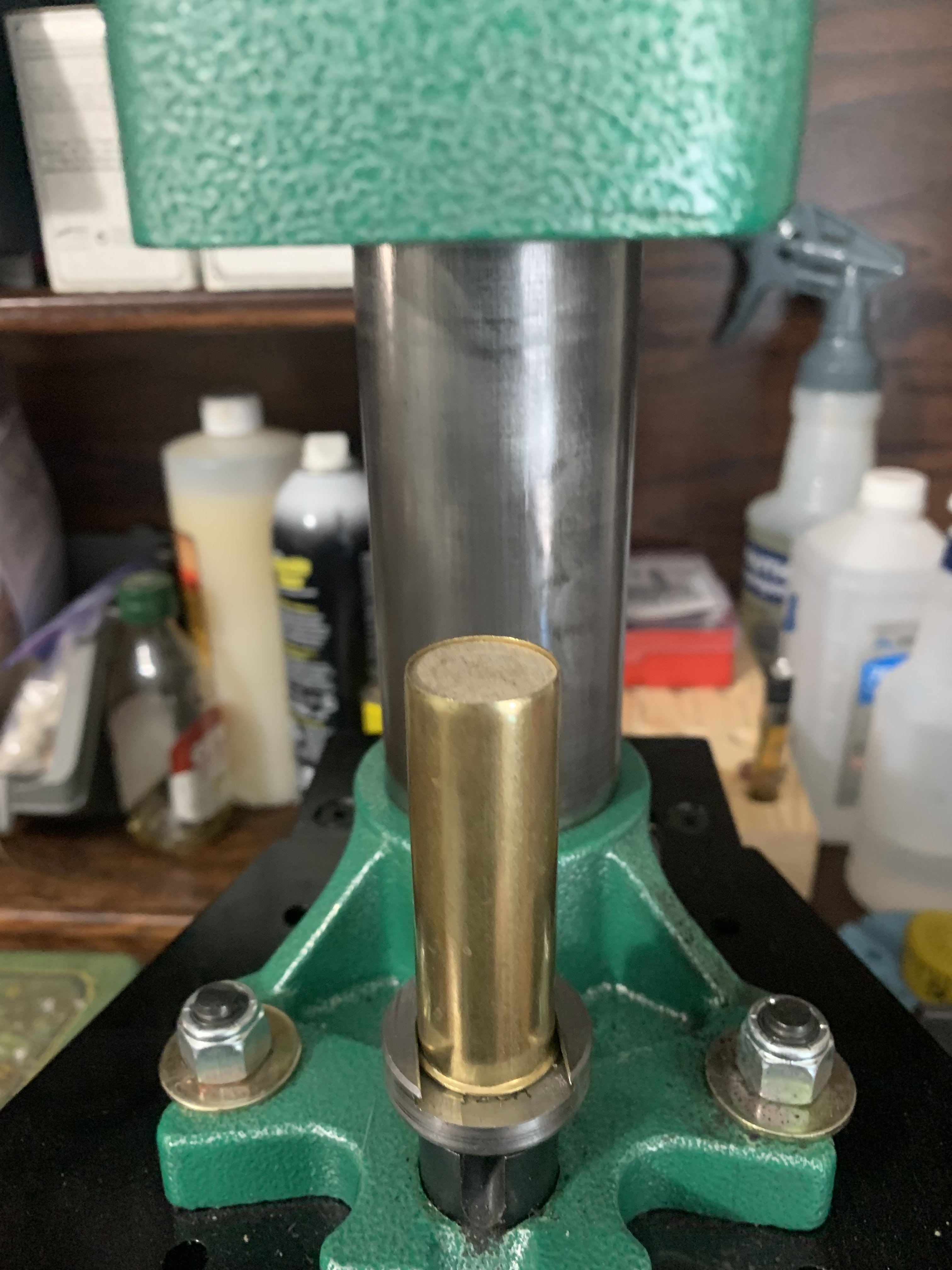

  13. Maybe a dumb question, but are you compressing the load far enough before you seat the bullet, or are you compressing the load with the bullet? I use a compression die to set the depth of the charge and wad stack, then seat the bullet by hand down against the stack.

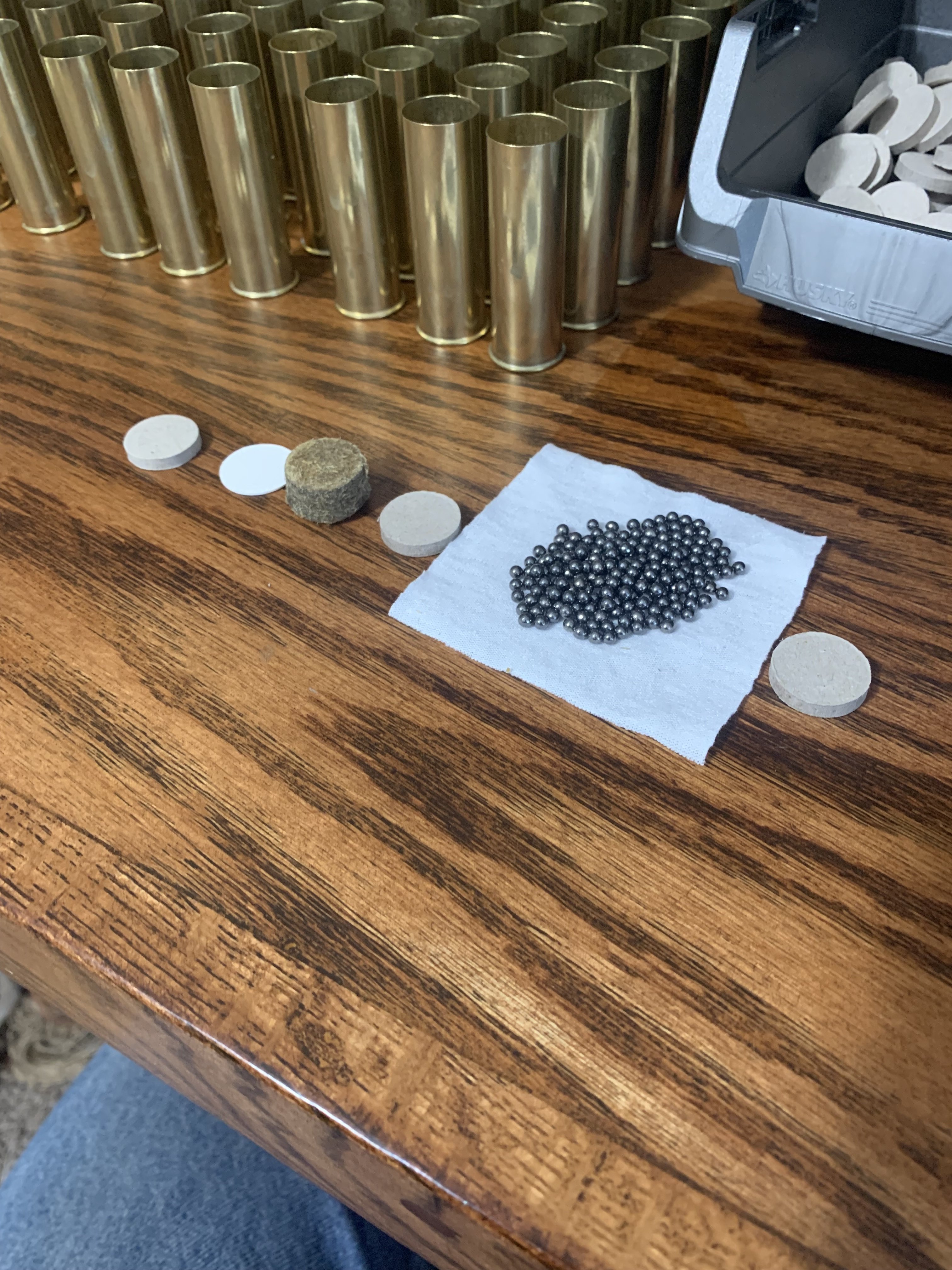

  22. I’ve left fiber wads stuck to targets more than once. 90gr of Fg Black under 1 1/4oz of 4’s or 5’s doesn’t leave much doubt if the knock downs will go.
  23. The crimp on those may very well need to be worked out. On the Magtec brass I use a light roll crimp with a nitro card at the top of the stack. The fiber and cards wads will go past the roll crimp with little issue. With the fiber wads I found my pattern improved a fair bit by going slightly larger on the shot size, and going with a heavier shot load as well.
