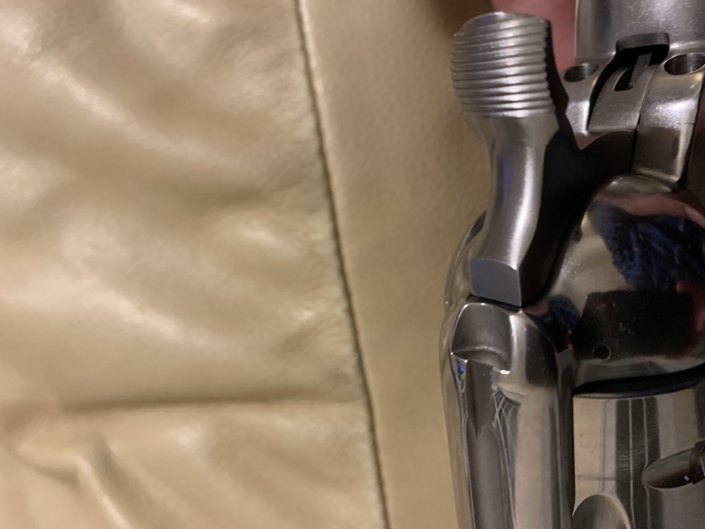

Captain Bill Burt Posted November 16, 2021 Posted November 16, 2021 About six months ago I bought the Iron Cowboy a set of Ruger NMV that had an action job from a fairly well known gunsmith (retired). He shall go unnamed as that isn't the point of this post. The round count on the Vaqueros was reported to be very low and the guns were spotless. I have no reason to doubt the round count. For the first several months they shot fine, until the Southeast Regional. Of course if a gun(s) going to break it will be at the worst time. In this case it was the first stage of the match. Both guns stopped popping primers. It wasn't the primers because I was shooting the same ammo and had zero problems. I took a close look at the guns and I noticed two things. One, the firing pin was only coming about half as far out of the frame as the firing pins on my NMVs and Sharyn's Single Sixes. My first thought was the spring is to light. Two, I also noticed that when you pull the trigger and the hammer falls, it doesn't quite fall all the way. There's a slight gap between the frame and the hammer. Once you take your finger off the trigger and let it reset, the hammer comes down all the way. I took the hammer spring out of one of the revolvers and replaced it with the stock spring (very heavy and not suitable for competition). Both problems went away. When fired the firing pin now protrudes all the way through as it should, and the hammer falls all the way. My question is, could it be as simple as needing a slightly heavier spring? Or is something else going on that the heavier spring is able to overcome? My preference would be to leave light springs in and fix whatever the other issue might be. My final question is, why now? They worked fine for a while.
Null N. Void Posted November 16, 2021 Posted November 16, 2021 I had one of my single sixes do the same thing. I put a washer under the spring to add a bit more compression, and the firing pin went back to protruding all the way and everything went bang. I think I was just a hair too light with trimming the original spring.

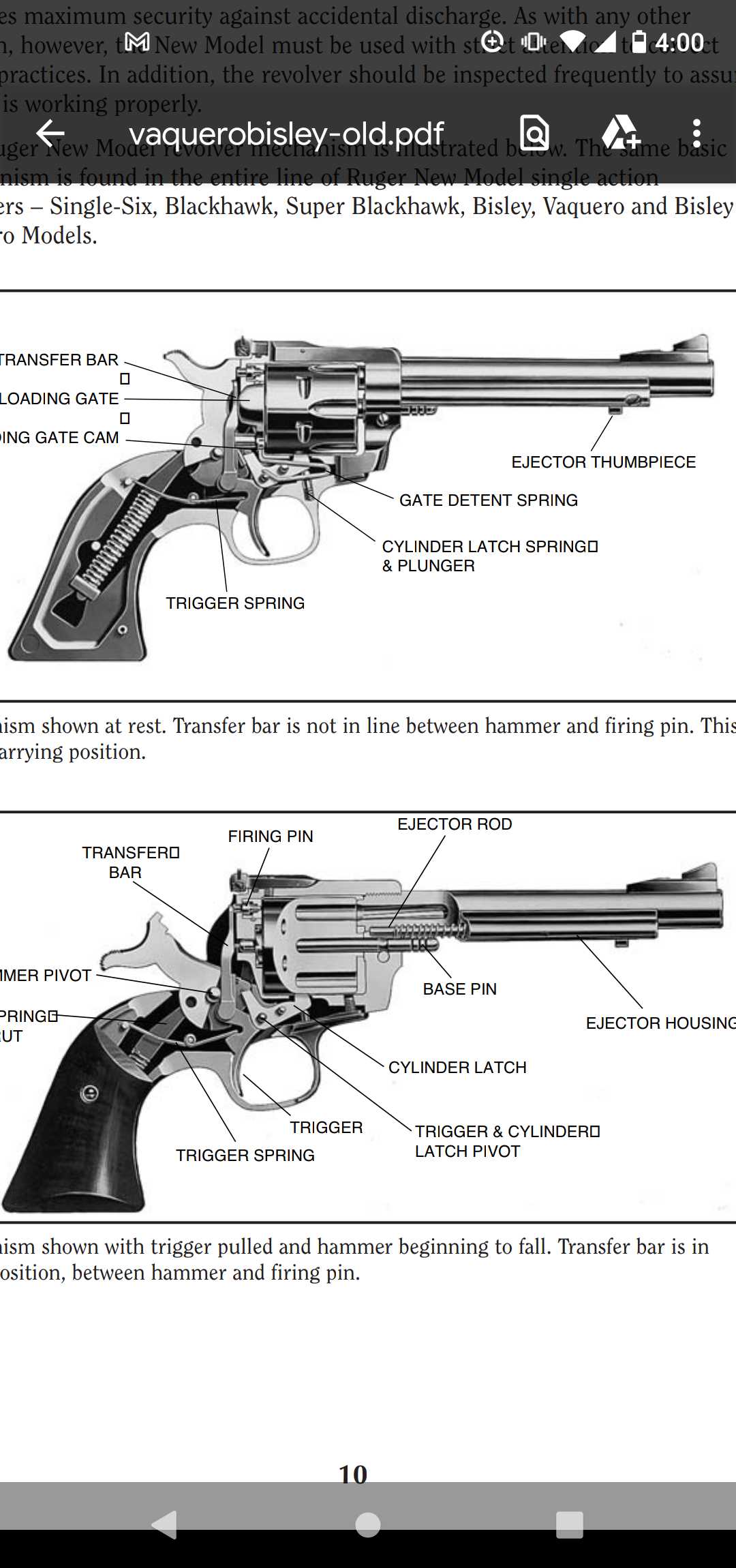

Cayuse Jack, SASS #19407 Posted November 16, 2021 Posted November 16, 2021 In my experience springs will take a set after being compressed awhile. That is probably why the guns stopped setting off your rounds. The gap between the frame and hammer is transfer bar pinch. Common on most New Vaqueros. Ruger doesn’t do any fitting in the transfer bars. It won’t cause miss fires but can cause the trigger pull to feel glitchy on reset.
Captain Bill Burt Posted November 16, 2021 Author Posted November 16, 2021 1 minute ago, Tyrel Cody said: Are the transfer bars still present? Yes.
Tyrel Cody Posted November 16, 2021 Posted November 16, 2021 1 minute ago, Captain Bill Burt said: Yes. Ok, was going to follow up with something similar to what Cayuse Jack posted. I'd take an extra look and make sure those transfer bars are good and smooth, as well as putting a thin washer under the light springs. It's also possible that some junk got in with the firing pin return spring or it wasn't lightened enough(or at all) with the action job. If that's too strong or dirty it can cause issues too.

Snakebite Posted November 16, 2021 Posted November 16, 2021 With the light springs in, and the gap is present, can you push on the back of the hammer and close the gap? sb
Captain Bill Burt Posted November 16, 2021 Author Posted November 16, 2021 59 minutes ago, Tennessee williams said: Obviously my chicken feet worked. No chance he'd ridden the hammer down, is there? No, I watched him shoot them slowly and get ftf. 51 minutes ago, Buckshot Bob said: If you’re willing to try it take one of the springs and give it a stretch . Try to do it evenly so the spacing between the coils stays the same . Then re install and see if your problems go away. If they do it’s still not fixed because the spring will just take a set again. But at least you’ll know I also like Lumpys suggestion about using some springs out of another of your competition guns unless there is some different set up being used I'm not willing to stretch anything just yet. I'll take my time and investigate, probably take one of them down later tonight. 26 minutes ago, Jack Spade said: If the base pins are pushed in too far they stop the travel of the hammer. This would cause the hammer to be back just a little and the firing pin to not strike the primer hard enough. There is a reason they make belt mountain base pins. Yeah, I had that happen to me back when I was getting started. Our pistols have increased power base pin springs and I check to make sure they're in and latched.
The Original Lumpy Gritz Posted November 16, 2021 Posted November 16, 2021 58 minutes ago, Captain Bill Burt said: The lighter springs are longer than the factory ones by about one ring, and appear to be thinner No, but my wife's are Single Sixes, so not really comparable, and mine are Jimmy Spurs, so again not really comparable. I'm not sure. What would it look like? Longer spring means nut'n if it doesn't have the 'smack' needed. Order new hammer springs from Wolff Gunsprings and flush out the insides with brake/carb cleaner. I now don't believe you have a trigger stop to deal with. You do have weakened hammer springs, that need to be skimmed with the AN washers I told you about or replaced altogether. Respectfully, OLG
Captain Bill Burt Posted November 16, 2021 Author Posted November 16, 2021 7 minutes ago, Snakebite said: With the light springs in, and the gap is present, can you push on the back of the hammer and close the gap? sb Yes. I can push it closed, or take my finger off the trigger and it will close.

Rex M Rugers #6621 Posted November 16, 2021 Posted November 16, 2021 I have a question from reading some of the replies here. Sorry to interrupt on your thread Captain Bill Burt. Anyway , how could a base pin be in too far and interfere with the hammer if it is latched in place, same as it has always been in the past ?? Curious , Rex
