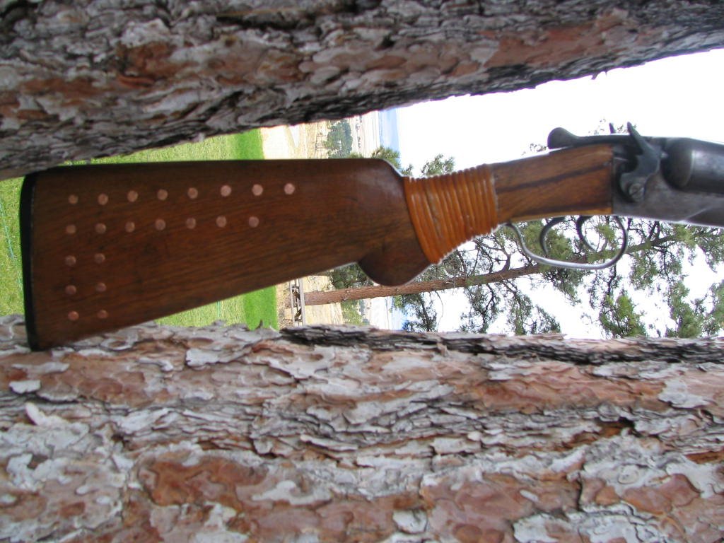

Three Foot Johnson Posted September 21, 2021 Posted September 21, 2021 Hardware store, hobby store, craft store. Pre-drill, yes. Cut copper tacks in a simple pattern on an old 235 shotgun stock, and a stylized arrow on a 10 gauge coach gun.

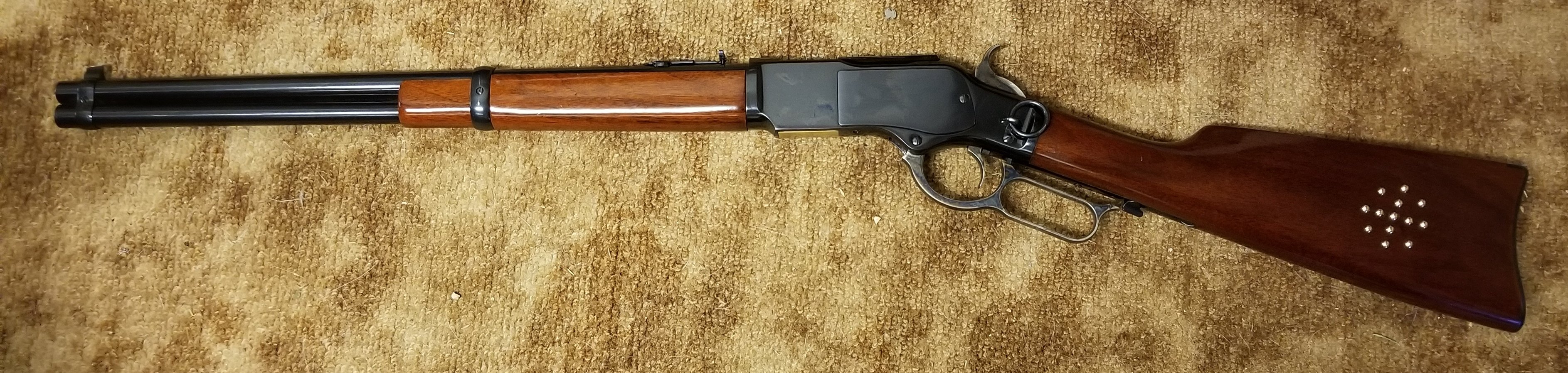

Warden Callaway Posted September 23, 2021 Posted September 23, 2021 On 9/21/2021 at 6:38 PM, Buckshot Bear said: They look damned good! I think it looks tacky! Just kidding.

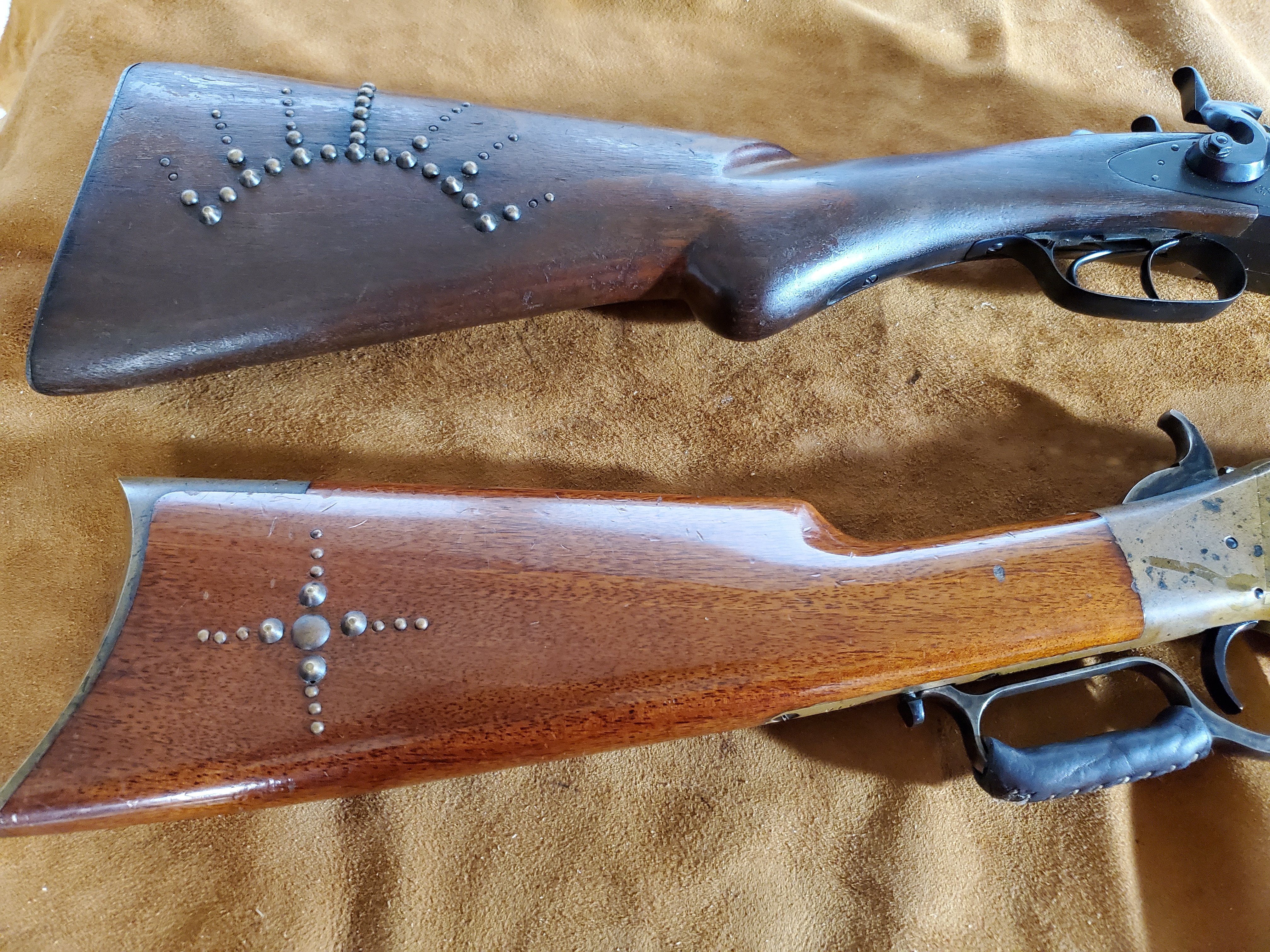

Sgt. Hochbauer, SASS #64409 Posted October 3, 2021 Posted October 3, 2021 Here is my 66 and hammered dbl....my 87 has not been touched yet.
