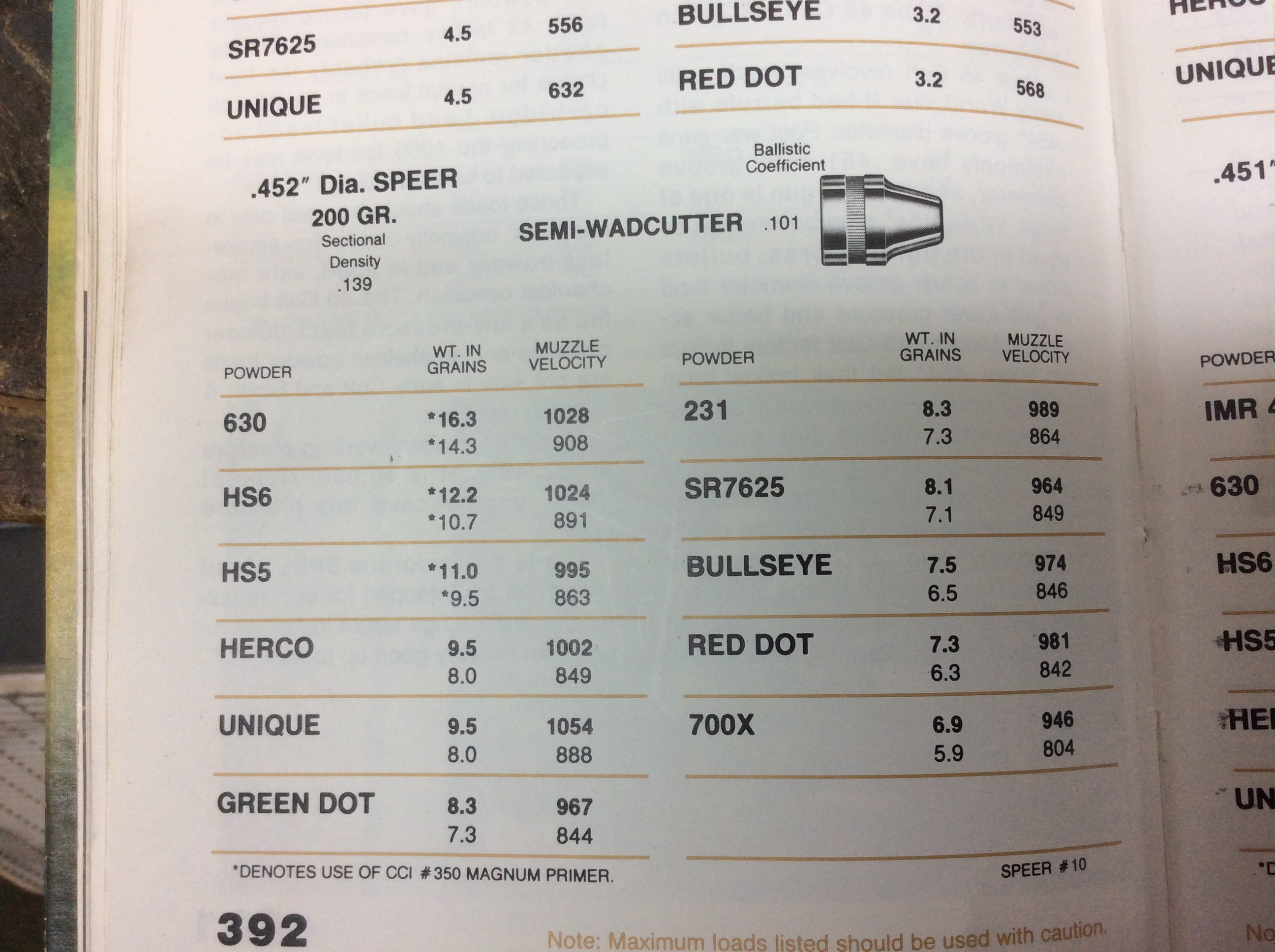

Crusty Knees Posted July 23, 2021 Posted July 23, 2021 This is what I have, Clays and Red Dot. I have 200gr RNFP Bullets and .45 Colt cases. Better still, I have some primers! I've been looking online and Alliant's website, and did a search here. I can't find any information on Red Dot .45 Colt loads for CAS. Anybody have any info they can share? The other powder I have is Clays. I found data on Hodgdon's site. I can go with that. But, thought I'd see if anyone has load data they'd share from experience. If it matters, I'm shooting Colt-like revolvers with 5-1/2" barrels. Thanks, CK
Cholla Posted July 23, 2021 Posted July 23, 2021 From the Lyman Cast Bullet Manual: From Modern Reloading 2nd Edition by Richard Lee :

Cholla Posted July 24, 2021 Posted July 24, 2021 5 hours ago, SHOOTIN FOX said: I use 5.5 gr under 200 gr rnfp. 1.57 coal. I recognize that manual! Speer No. 10. I bought my copy in 1983 and read it forwards and backwards. I still have it along with nine others in hard copy and another ten on pdf.

SHOOTIN FOX Posted July 24, 2021 Posted July 24, 2021 I bought that book in 1983 as well. Has served me well over the years. I use it for quick reference and then verify data online.
