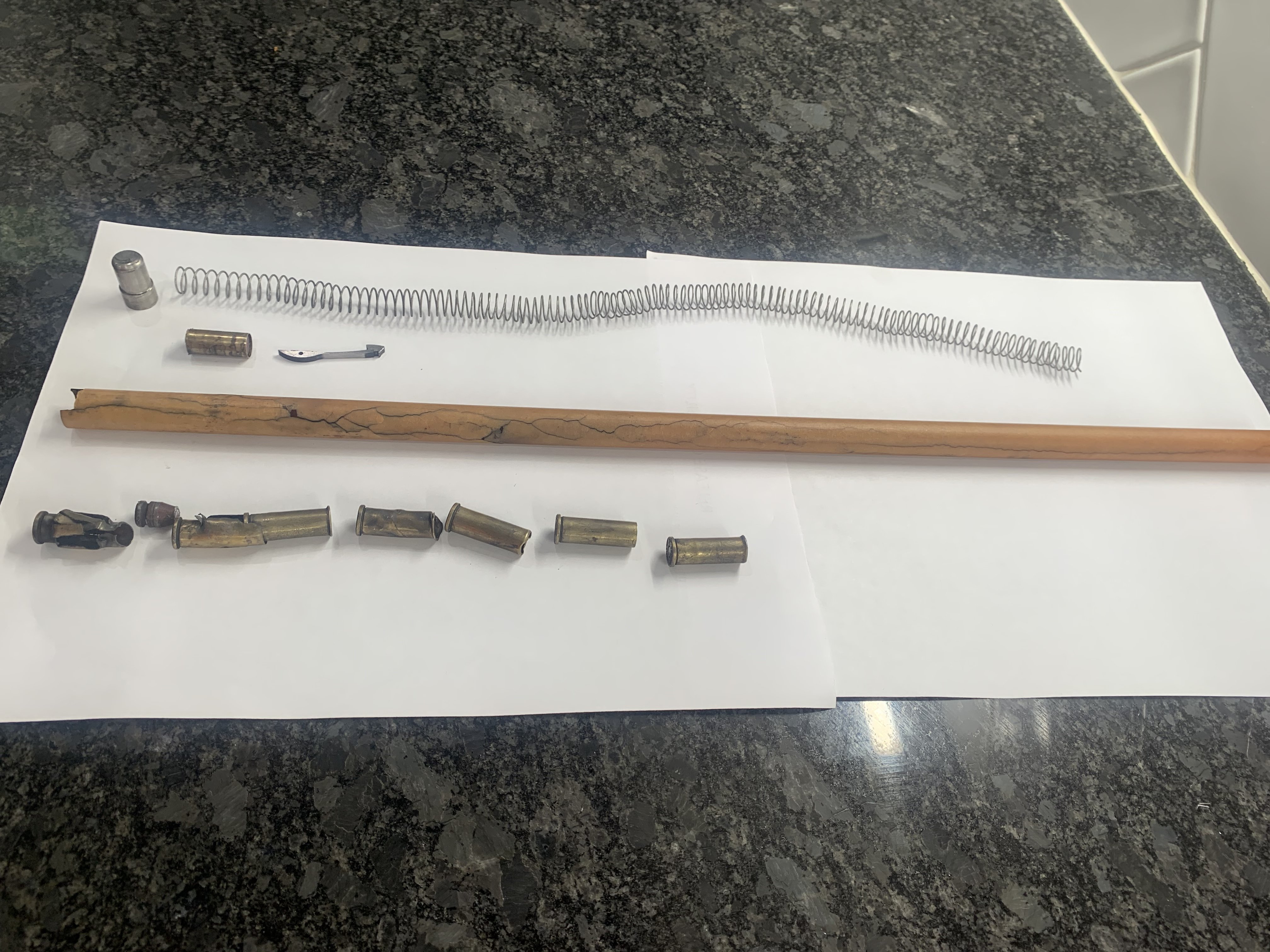

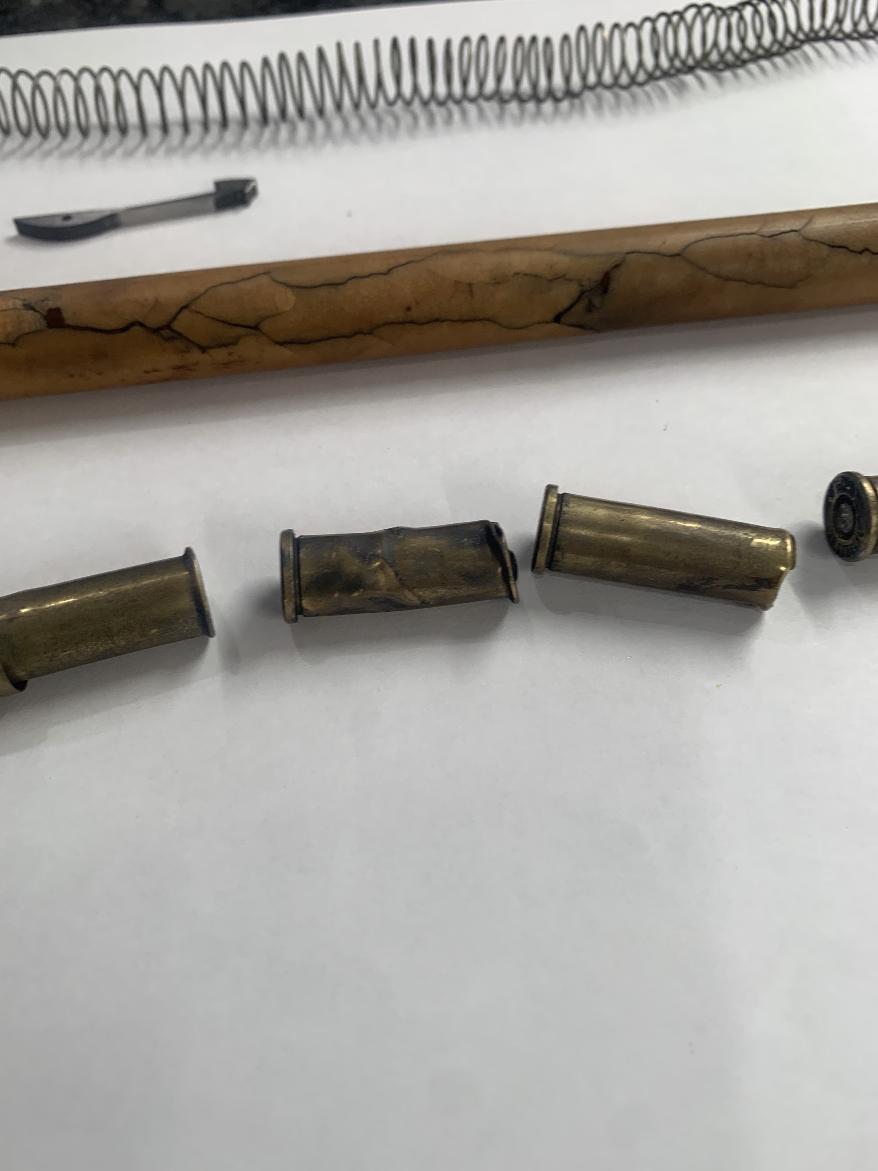

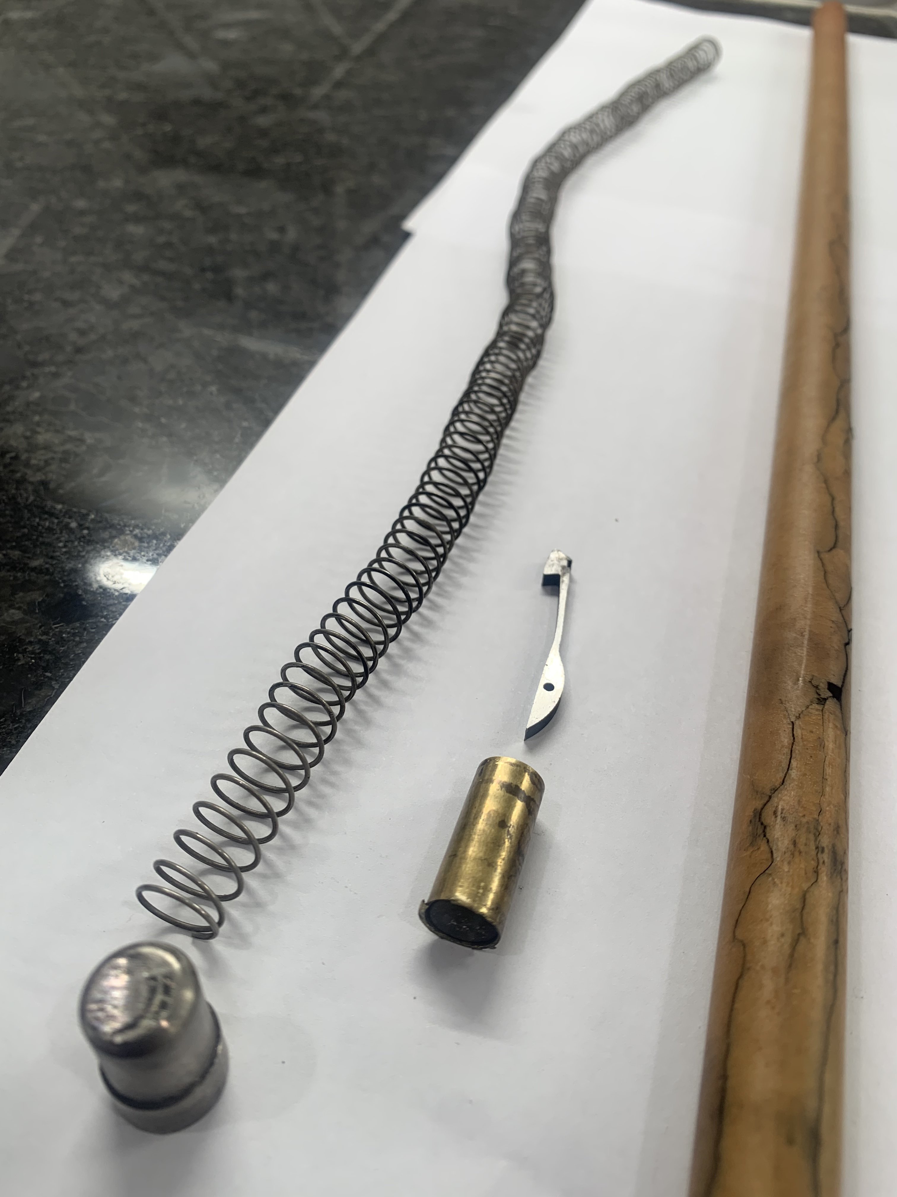

El Catorce Posted January 13, 2023 Posted January 13, 2023 I had a carbon fiber tube installed in my uberti when i had a magazine detonation …. I strongly believe that the carbon fiber tube helped contain the explosion and saved me further damage, not to mention possible physical harm. I think the aluminum tube i had installed as a replacement will do the same thing plus the inside diameter is a little smaller helping to further align the cartridges.

Lowdown Larry Posted January 13, 2023 Posted January 13, 2023 Unfortunately I had the same thing happen last year, I had the aluminum tube in mine, that saved the rifle, only thing that happened was the tube had a bulge in it.
Pb Mark Posted January 13, 2023 Posted January 13, 2023 Too many stories and pictures like that and I'll be wearing my Kevlar gloves... Did the seller send you a warrantee replacement? Just joking but bet they would with those pictures available. Never read or considered the additional protection that liner might provide.
Cold Lake Kid, SASS # 51474 Posted January 13, 2023 Posted January 13, 2023 El Catorce and Lowdown Larry: Would you care to let me/us know how that detonation came about?
El Catorce Posted January 13, 2023 Posted January 13, 2023 8 hours ago, Cold Lake Kid, SASS # 51474 said: El Catorce and Lowdown Larry: Would you care to let me/us know how that detonation came about? My rifle locked up on the second round of the rifle string…needed to hammer back a bent round at the fumble area… and made the rookie mistake of not emptying out the mag tube… so I learned to ALWAYS empty out the magazine if you need to pound back a squib or a bent round… oh! And also learned that a secondary benefit to having a .38 magazine alignment tube in your magazine is that they may help contain a magazine detonation and minimize damage and injury…maybe. They’re not designed to do that so maybe I was just lucky.
Lowdown Larry Posted January 13, 2023 Posted January 13, 2023 11 hours ago, Cold Lake Kid, SASS # 51474 said: El Catorce and Lowdown Larry: Would you care to let me/us know how that detonation came about? I'm not certain how it happened, was shooting the rifle stage and it locked up smoke came out of the receiver, I have to blame a high primer but more worried on how I missed it. I use two methods of checking and one got through somehow.
