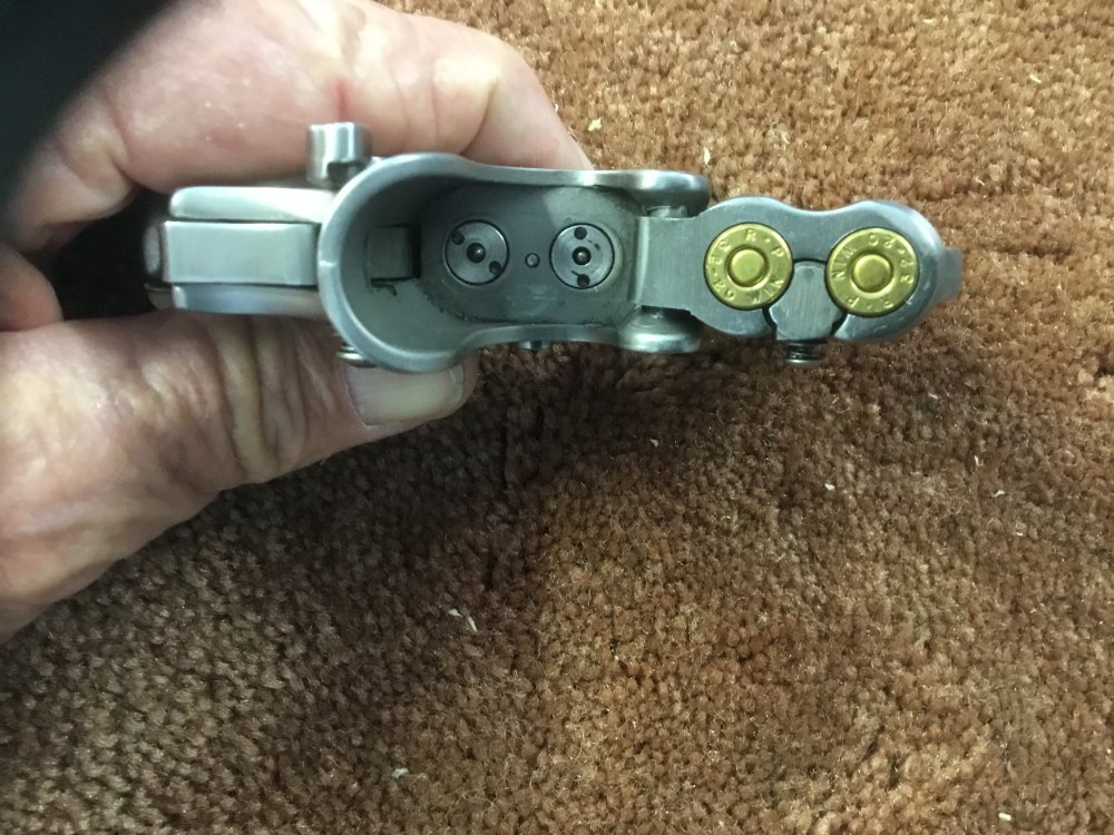

H. K. Uriah, SASS #74619 Posted October 26, 2022 Posted October 26, 2022 On 10/24/2022 at 12:11 PM, Cypress Sam, SASS #10915 said: 32-20 is my favorite caliber for CAS, the attached photos are my “accumulation” of 32-20s. Where'd you get a derringer in .32-20?

Cypress Sam, SASS #10915 Posted October 30, 2022 Posted October 30, 2022 On 10/26/2022 at 4:13 PM, H. K. Uriah, SASS #74619 said: Where'd you get a derringer in .32-20? I special ordered it from American Derringer in Waco Texas. Here are a few more photos.
