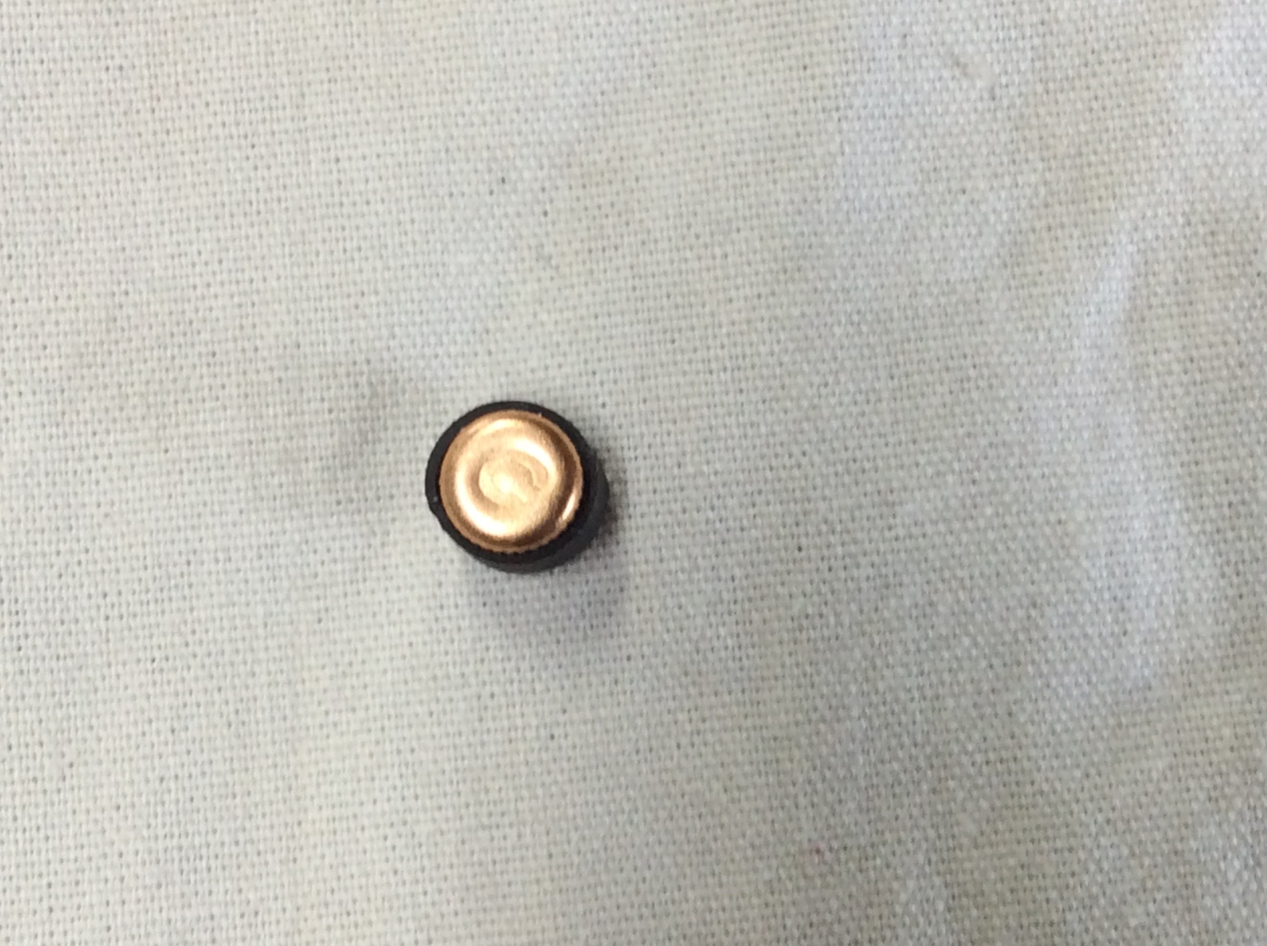

Make do Posted May 19, 2022 Posted May 19, 2022 Having been plagued with more cap jams than I think necessary, I recently embarked on a time intensive, possible dangerous method to prevent cap jams. Having no gunsmithing ability to install a cap rake or inclination to pay to have one put in I have tried various other solutions. Aquarium tubing- didn't work not enough room, tube too thick Cap guards - didn't hold together well still jammed. Different nipples and caps - still had the problem. Finally, I came up with a solution that is both possibly dangerous and taking an immense amount of time but seems to work. I found some shrink fit tubing that I cut into small slices and put around the cap, I then one cap at a time use a heat gun to shrink the tubing. I know what you are thinking that is not a good idea heat and a percussion cap but it seems to work. Although I do wear a face shield and gloves I have not have one cook off. It seem the heat shrink is more sensitive than the cap. On two trips to the range and of approximately 100 rounds total zero cap jams. Anyone tried this or have a better solution?

Make do Posted May 19, 2022 Author Posted May 19, 2022 Hi - I usually let them set about 1 min. I have purposely set off one of the caps with the heat gun to see how close it was to when the heat shrink sets and it is about 30 to 45 seconds with the heat gun till ignition and about 5 to 7 seconds to set the heat shrink. I use Treso nipples with the recommended #11 caps - Have smoothed up the hammer face and defanged the edges. Just looking for a fool proof way to prevent, mostly because I shoot gunfighter and it is a mess when you have a cap jam. I have noticed that jams are much fewer (one per two or three stages) when I push the caps down hard onto the nipple - Don't feel very safe having the gun in hand pushing hard on the cap. I know some people set the cap with the hammer, but I seem to recall that isn't allowed is SASS. I do use a wooden dowel to push with, but it seems to mush a bit too much instead of seating the cap. How hard do people push to seat the cap? I am thinking maybe a hard plastic rod of some type, pretty sure something made of metal would not be a good idea.

Make do Posted May 19, 2022 Author Posted May 19, 2022 Nope I do the caps at home one at a time keeping all other items out of the way, then at the range put the caps on like normal they will even run through a capper- Hammer springs are stock. Haven't run them at a match yet - just trying it out. Looks like I should save up for some cap guard work.

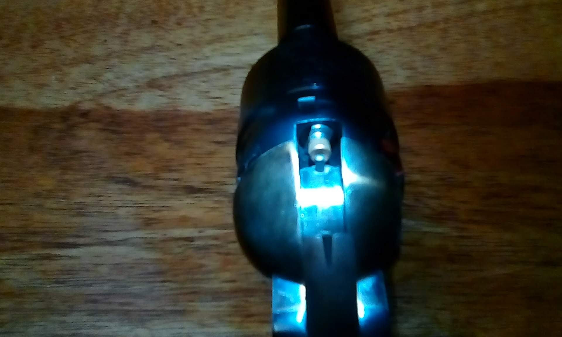

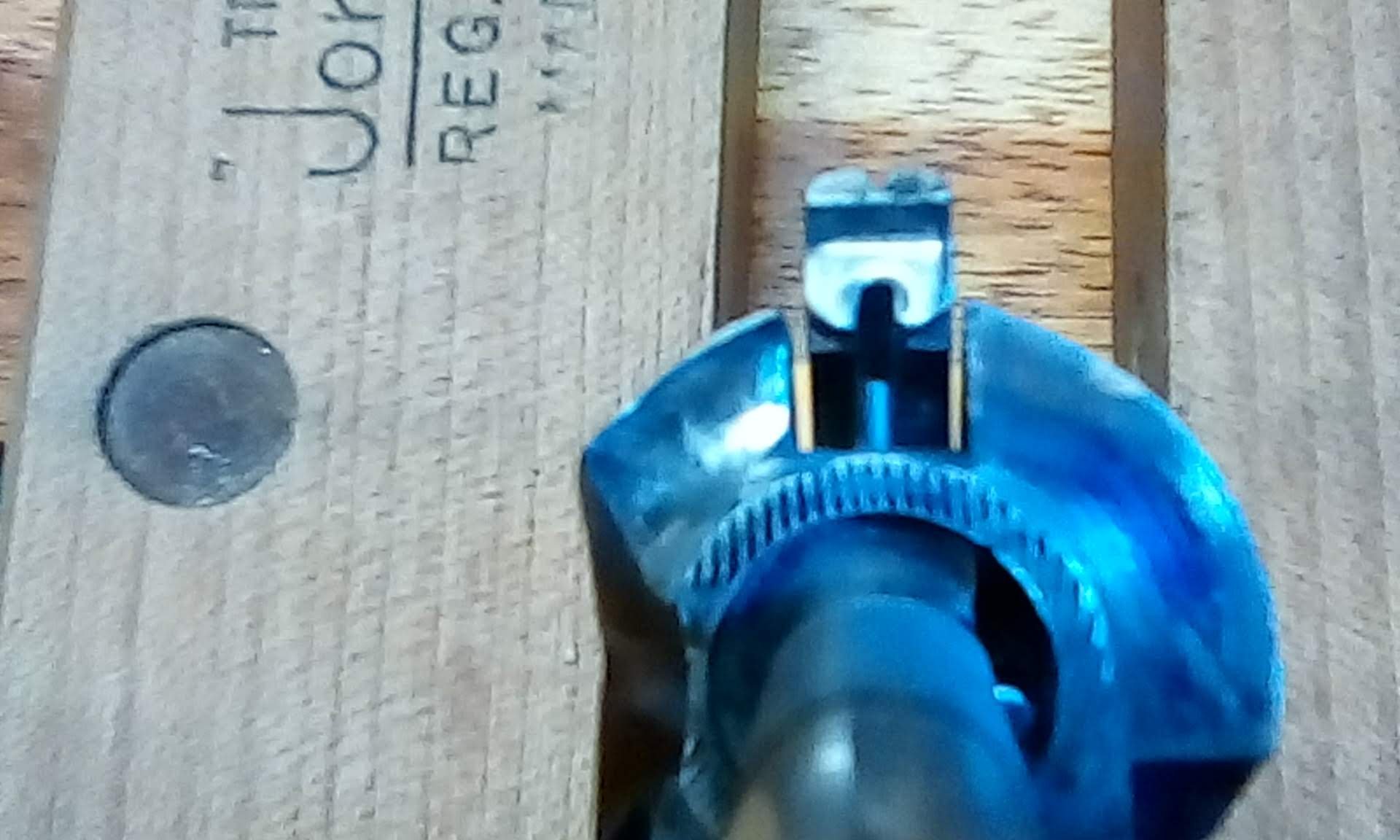

Make do Posted May 20, 2022 Author Posted May 20, 2022 I shoot a Pietta 1861 navy.. would love to see more of the first picture Prairie Dog posted it seems like a good solution. Which would be the best, easiest to attempt with a drill press?

Eyesa Horg Posted May 20, 2022 Posted May 20, 2022 21 hours ago, Make do said: I shoot a Pietta 1861 navy.. would love to see more of the first picture Prairie Dog posted it seems like a good solution. Which would be the best, easiest to attempt with a drill press? I did the post with a drill press and clamped the frame in wood Jorgensen clamp. After drilling, cut a piece of the shank and inserted with a little Loc Tite stud mount. Used a Dremel with a cutoff wheel to make the slot in the hammer. I believe the drill size was 3/32, recommended by Coffinmaker.
