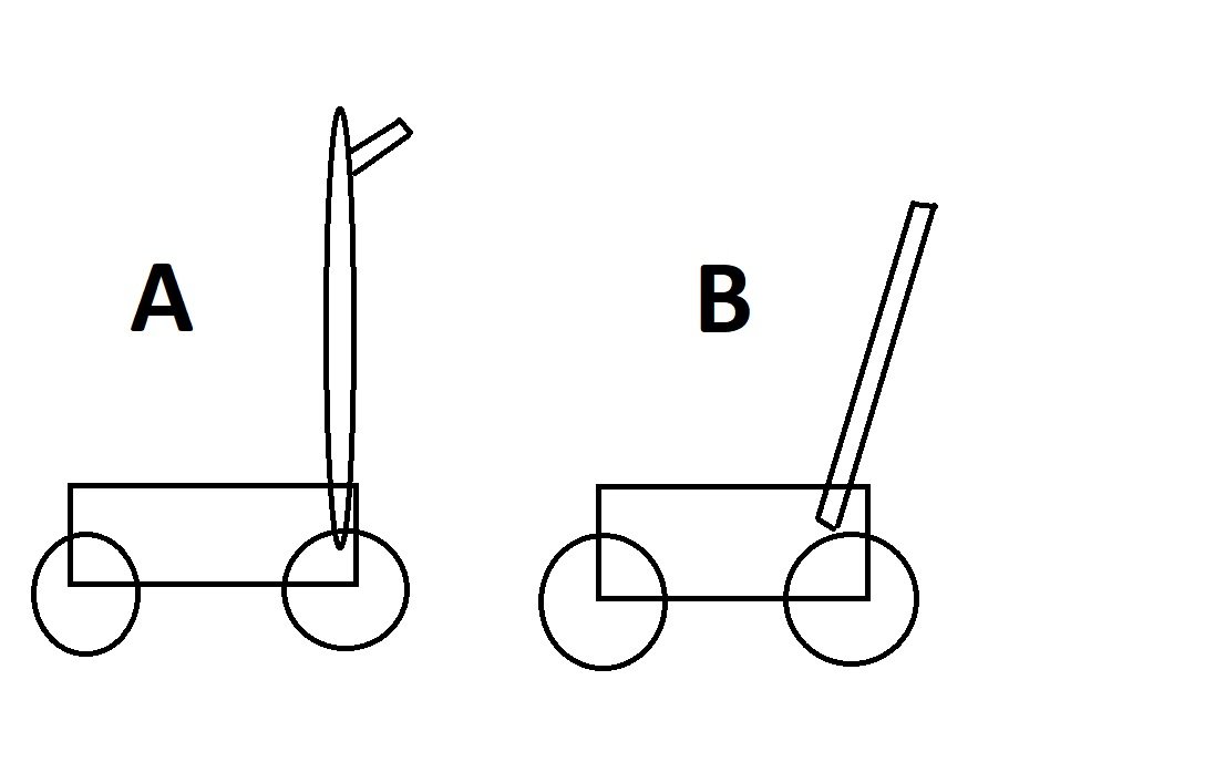

Buckshot Bear Posted January 21, 2022 Posted January 21, 2022 G'day all, Didn't think that a gun cart was going to be on the cards, but after a few shoots thinking now its not a 'nice thing to maybe have' but more under the necessity of a 'must have' there's lot of gear to move around for two people (myself and my wife Jenorado). The two clubs that we will be mainly shooting at have a lot of concrete pathways and concrete slabs before we get to the grass, gravel, sand and sometimes mud so I'm thinking of going for four wheels? Good idea or poor idea? These are the wheels I'm thinking of getting, they are just under 15" in diameter. Not sure about the angle to have the uprights and the handle. Which do you think is better Leonardo Da Vinci's drawing A or drawing B? Like all blokes I'm guilty of over engineering things and want to make this as physically light yet sturdy as possible. and try to stay away from 1/2 plywood and incorporate 1/4 ply and even 3/16th plywood with some strengthening stringers. I know a lot of you cowboys have made carts and more than one on your journey to the best one for your needs so if there's any hints that you could pass along it would, as always be really appreciated. I won't be going down the converted baby stroller method, I do want to make one from scratch out of wood. Thanks all, Bear

Imis Twohofon,SASS # 46646 Posted January 21, 2022 Posted January 21, 2022 Bear I have used several 2 wheeled carts and one 4 wheel in nearly 20 years of CAS. My current cart has 2 wheels. I have made a couple of wood carts, one was 3/4 inch marine plywood, no worries about rain but god awful heavy. I would suggest that if you are going with a 4 wheel design, you combine both of your sketches. A rack to hold long guns with the bores vertical and the handle further back to keep your feet from constantly hitting the cart. Also wagons are a lot easier to pull than push, so maybe a T handle. This then brings up casters instead of solid mounted front wheels. Since you are going to construct this from wood make the handle/LG support removable, both for weight and ease of loading/storage. Good luck and dont be afraid to re-do/rebuild more than once. Imis

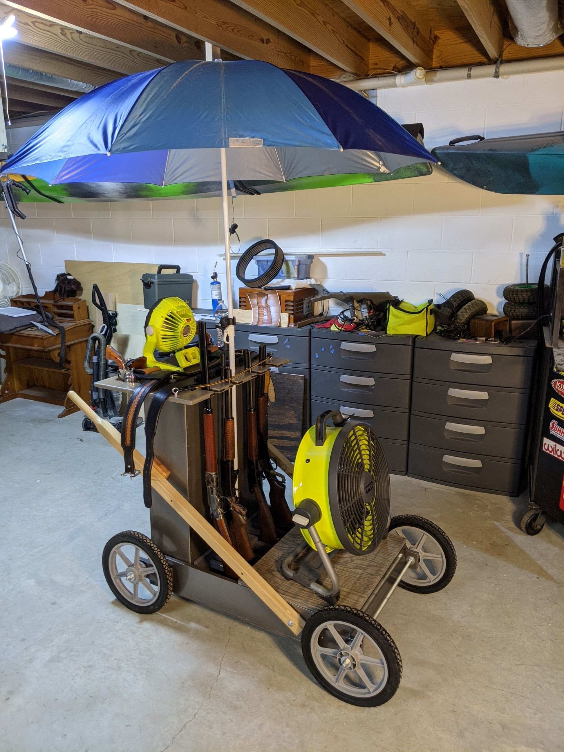

Mister Badly Posted January 21, 2022 Posted January 21, 2022 Comes apart without tools. The upright stores in the base.
Mister Badly Posted January 21, 2022 Posted January 21, 2022 It's sturdy enough to mount and use my cap and ball loading stand. The wheels are 14"

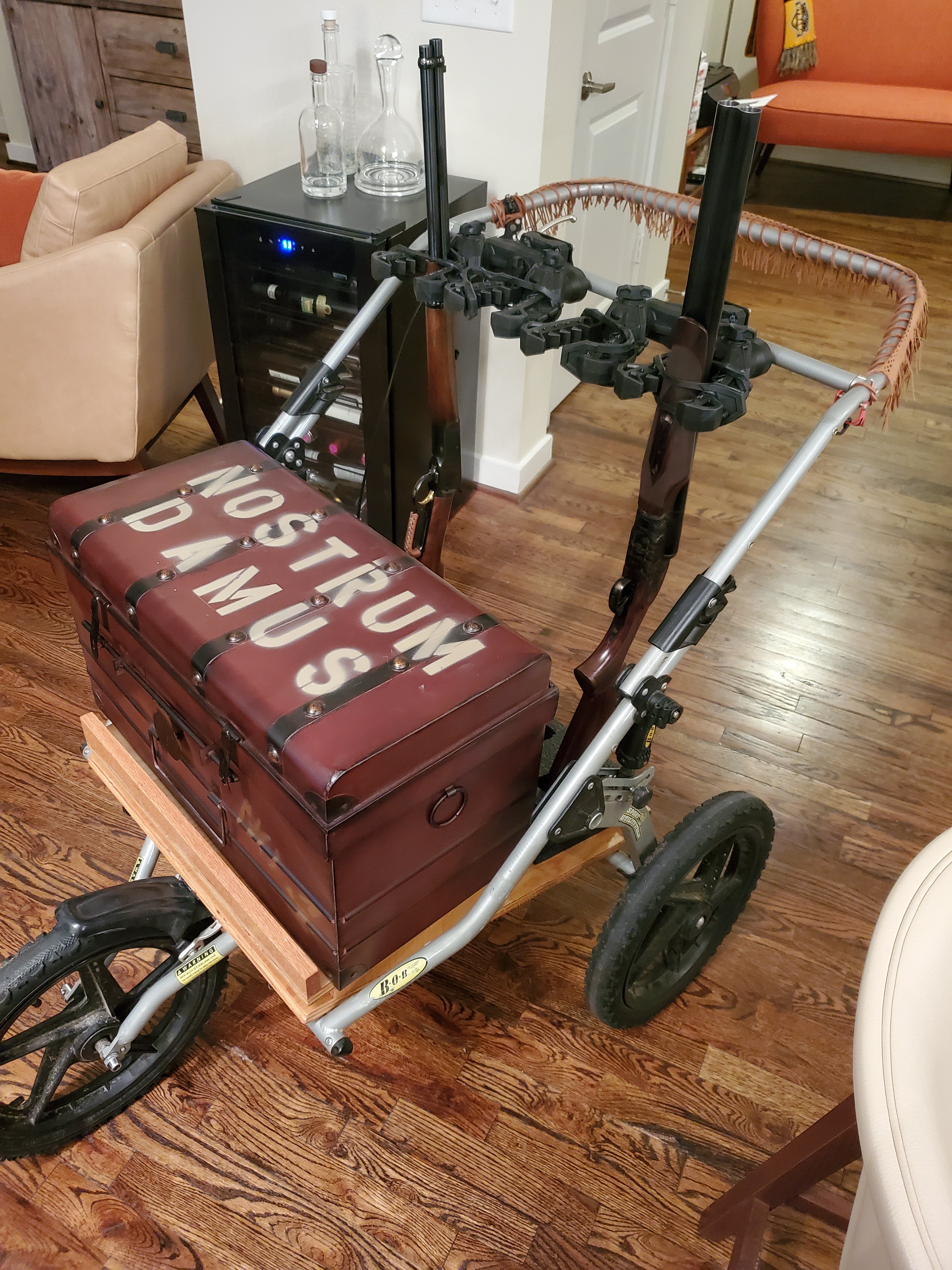

Nostrum Damus SASS #110702 Posted January 23, 2022 Posted January 23, 2022 All of those are good to great. But to my way of thinking, less wood is less weight. Here's my modular cart which started life (a very long time ago) as a double-wide baby stroller. I got it for free and stripped it of its baby parts to salvage the lightweight collapsible folding frame. The chest is light sheet metal and holds everything for me and Bullion Rose, and just sits on the shelf. Then, the shelf itself, with the gun butt slots, also just lifts off the frame. Easy to assemble and disassemble, easy to lift the three parts out of and back into my truck. And it balances fully loaded with the center of weight far enough in front of the rear axle so that there is no chance of it falling over, even when I hang empty shell bags or ammo pouches on the handle.
Slapshot Posted January 23, 2022 Posted January 23, 2022 1 hour ago, Nostrum Damus SASS #110702 said: All of those are good to great. But to my way of thinking, less wood is less weight. Here's my modular cart which started life (a very long time ago) as a double-wide baby stroller. I got it for free and stripped it of its baby parts to salvage the lightweight collapsible folding frame. The chest is light sheet metal and holds everything for me and Bullion Rose, and just sits on the shelf. Then, the shelf itself, with the gun butt slots, also just lifts off the frame. Easy to assemble and disassemble, easy to lift the three parts out of and back into my truck. And it balances fully loaded with the center of weight far enough in front of the rear axle so that there is no chance of it falling over, even when I hang empty shell bags or ammo pouches on the handle. I thought the shotguns had to be in the open position?
Nostrum Damus SASS #110702 Posted January 23, 2022 Posted January 23, 2022 12 minutes ago, Slapshot said: I thought the shotguns had to be in the open position? Not in my living room. But yes, of course, the rack holds the long guns with actions open when in actual use. The shotgun just breaks open and is held that way, and there's enough room (intentionally, by design) for the levers to be in their open position without hitting the back of the storage chest. Like others, I too am always looking at the cart to make improvements. I realize that the picture I posted is not its most current configuration. I'll post another photo later today.
