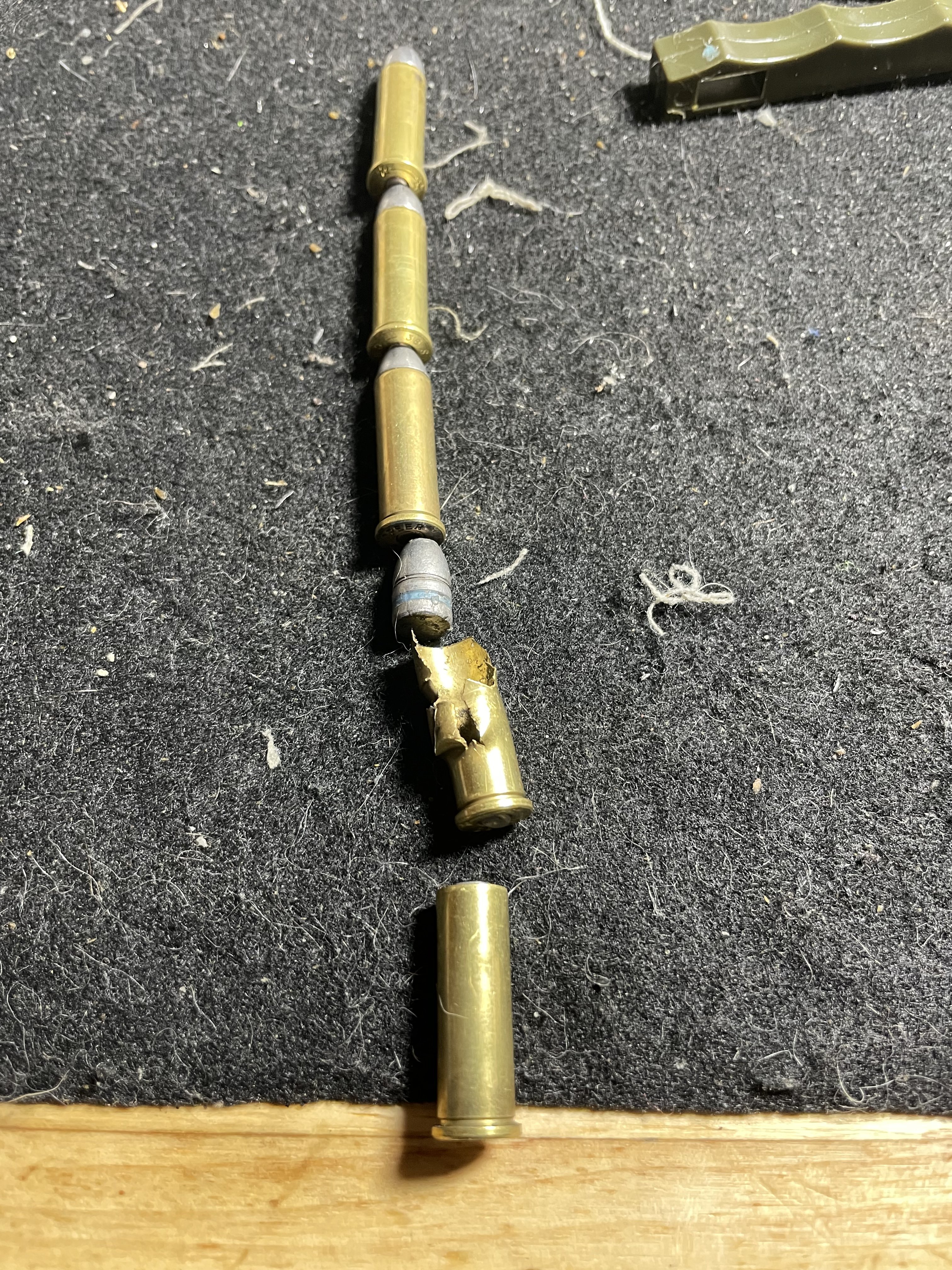

Hoss Posted November 1, 2021 Posted November 1, 2021 Uberti Win 73, probably 10K plus rounds on it. Short stroked, tuned etc. shooting 130 grn RNFP Bullets with 3.0 Bullseye. Loaded with Dillon 750 Fired 5 rounds. 5th round made an odd noise, normal sound plus a POP I did not feel anything unusual. Case ejected. Then rifle jammed. Looking in, I could see lead had pushed back into case. I figured “split case” tried to clear it, no luck. TO said sounded funny, you may have a squib. I grounded rifle, declaring “BROKE GUN”. Finished stage. back to rifle this is what I found Round 6 shoved back into case. Round 7 blown out. Round 8 lead set back a bit, rounds 9 & 10 normal. I suspect round 6 set off round 7. Don’t think I had a high primer but could have. The recoil drove the Bullet back into the case of round 6. The Bullet coming out of round 7 hit 8, driving it into 9, setting Bullet deeper in case a bit. Rounds 9&10 were unaffected. no damage to rifle. I suspect I was unluckily lucky! only lesson I can think of is double or triple check primers!

Tex Jones, SASS 2263 Posted November 2, 2021 Posted November 2, 2021 Glad there was no damage At first glance it looks like the 6th round may have had the bullet impacting on the primer of the 7th round causing the "pop". Perhaps a high primer on the 7th round? Just a WAG.
Lazy Eeyour Posted November 2, 2021 Posted November 2, 2021 My best guess, you had a magazine detonation which causes the shells to compress. It's a 38? If the magazine tube is oversize the shells line up something like this \\\\\\\ (not in a straight line). Someone sells a reducer to keep 38s more nose to tail. Here is an example: https://www.badmanbullets.com/OnlineStore/proddetail.php?prod=Uberti-Magazine-Sleeve-Kit

Garrison Joe, SASS #60708 Posted November 2, 2021 Posted November 2, 2021 I'd guess that there was a high primer on round 7. Round 6 popped out of mag tube onto carrier followed close behind by the rear quarter inch of cartridge 7. Since you seem to have cartridge OAL about 1.550 or so from looking at cartridge 9 and 10. With round 6 and a little of 7 on the carrier, round 5 was fired and the recoil slammed the 7, 8, 9 and 10 cartridges rearward and a high primer on round 7 impacted the nose of round 6. The force of round 7 firing collapsed the bullet of 6 into the case. And that blew open the brass of round 7, and pushed the bullet out at low speed to slam into the back of round 8. Which set bullet 8 back into it's case. If that is what caused the round ignition in the carrier, then no alignment tube would have prevented this. Because the head of round 7 is as free to move side to side (or up and down) as the channel in the carrier allows. Seating all primers to proper depth is REAL important. As is discarding any cases in which primer pocket is too loose to firmly hold the primer, in case the primer was rattling around in the pocket as the gun was being fired.. Answers to a couple of questions would help make a better guess, though. Where was round 6 found? Still on carrier? Or partially into chamber? Was the case on round 6 deformed (other than having a bullet shoved back in the mouth)? Does the carrier show any new burn or scratch marks in the cartridge channel? Did the cases from rounds 1 thru 5 all still have a fired primer in the case, or had one gotten loose to rattle around in the action? good luck, GJ

Hoss Posted November 2, 2021 Author Posted November 2, 2021 14 minutes ago, Garrison Joe, SASS #60708 said: I'd guess that there was a high primer on round 7. Round 6 popped out of mag tube onto carrier followed close behind by the rear quarter inch of cartridge 7. Since you seem to have cartridge OAL about 1.550 or so from looking at cartridge 9 and 10. With round 6 and a little of 7 on the carrier, round 5 was fired and the recoil slammed the 7, 8, 9 and 10 cartridges rearward and a high primer on round 7 impacted the nose of round 6. The force of round 7 firing collapsed the bullet of 6 into the case. And that blew open the brass of round 7, and pushed the bullet out at low speed to slam into the back of round 8. Which set bullet 8 back into it's case. If that is what caused the round ignition in the carrier, then no alignment tube would have prevented this. Because the head of round 7 is as free to move side to side (or up and down) as the channel in the carrier allows. Seating all primers to proper depth is REAL important. As is discarding any cases in which primer pocket is too loose to firmly hold the primer, in case the primer was rattling around in the pocket as the gun was being fired.. good luck, GJ I look at primers, certainly did not see a high one. But not saying it’s impossible.

The Original Lumpy Gritz Posted November 2, 2021 Posted November 2, 2021 May I ask the brand of primer? Agree 110% it was a high primer. The alignment sleeve is a very good idea! OLG

Hoss Posted November 2, 2021 Author Posted November 2, 2021 1 hour ago, The Original Lumpy Gritz said: May I ask the brand of primer? Agree 110% it was a high primer. The alignment sleeve is a very good idea! OLG Federal SPP

Marauder SASS #13056 Posted November 2, 2021 Posted November 2, 2021 The picture of the primer says a lot! You can see where the bullet was hitting the primer. And without a back plate, the rest of the primer expanded backwards. So the bullets was very slightly misaligned, but maybe a combination of that with a slightly high primer. So glad it was a reduced pressure load so no real damage! I have the aluminum sleeve and made sure to coat both the sleeve and mag tube with rust preventative. Grease worked pretty well but I then changed to frog lube and it is even better. So Boeshield, frog lube, Eezox and even a good wax should work well to reduce chances of rust.
Griff Posted November 2, 2021 Posted November 2, 2021 1. Whether or not you prime on the press, your shellplate is too loose if a high primer doesn't stop the case from advance from station 1 to 2, (powder drop). 2. Or case has too loose a primer pocket. 3. A bullet with a wider meplat will have more of the nose in contact with rear of case, lessening impact from primer. 4. For tubular magazine guns the safest bullets have a meplat that contacts all the way around the primer pocket. I'm inclined to think #2. AND glad it wasn't worse!
