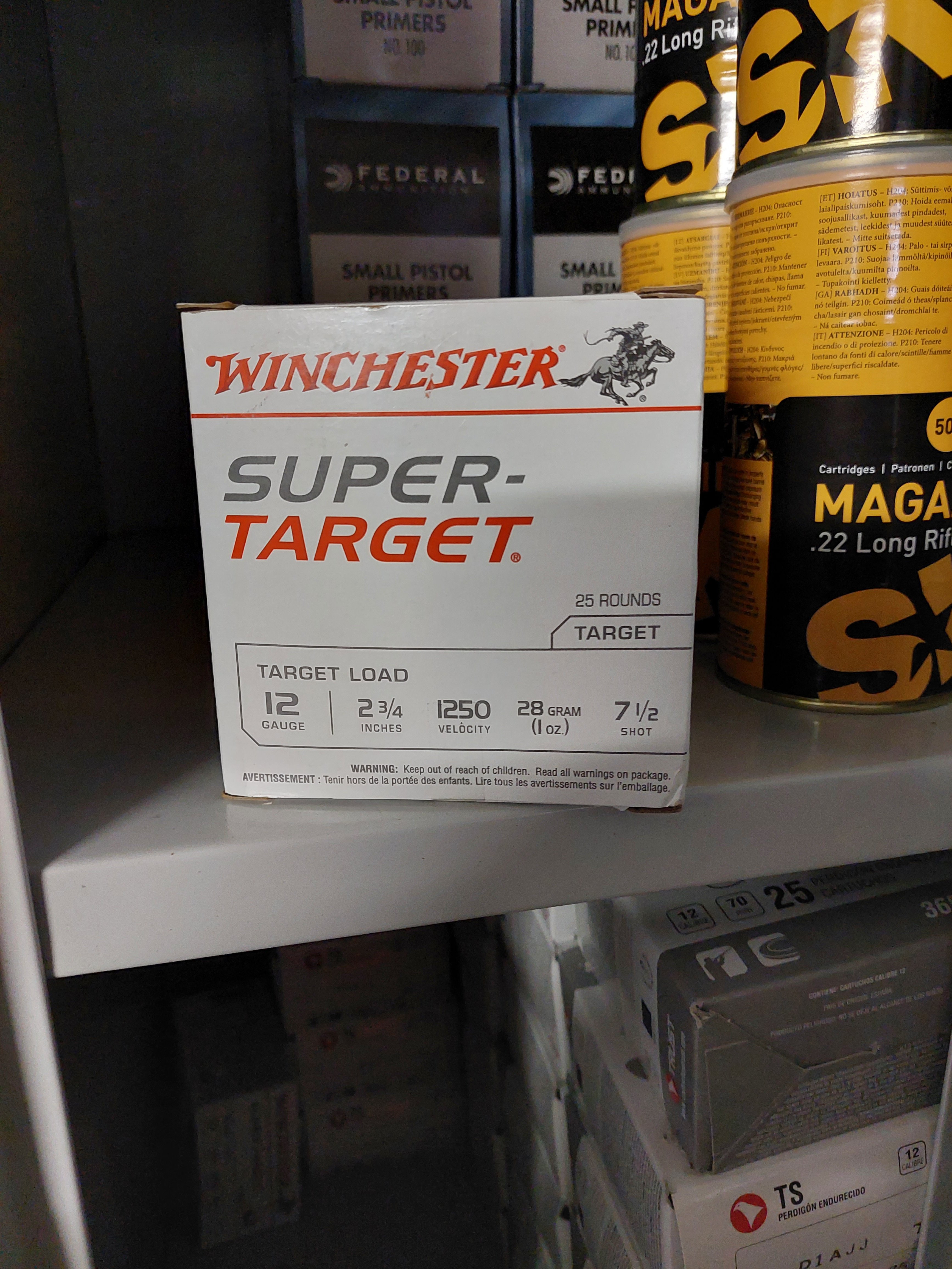

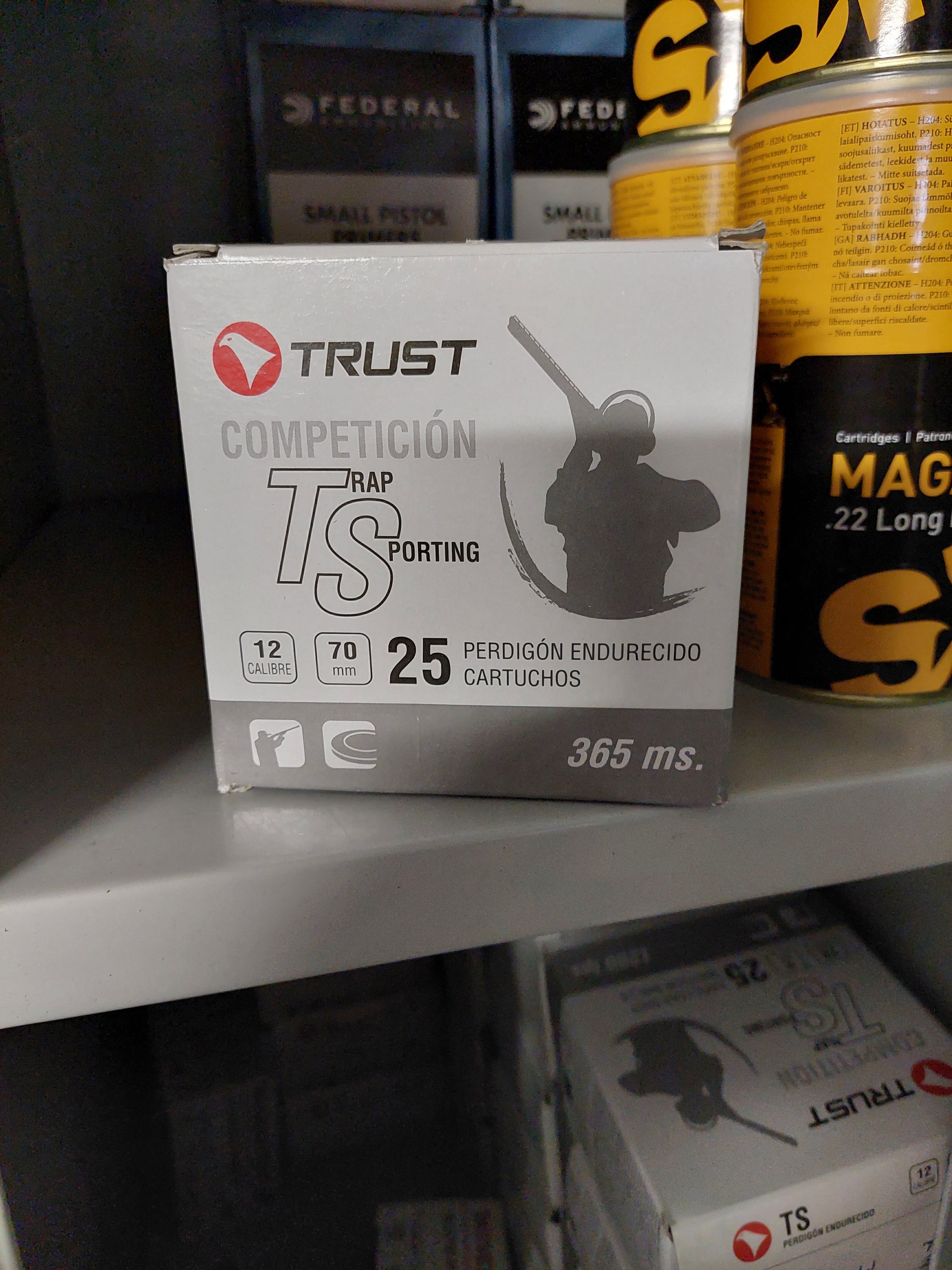

Buckshot Bear Posted September 25, 2021 Author Posted September 25, 2021 1 hour ago, Larsen E. Pettifogger, SASS #32933 said: What brand of shells can you get? Winchester has the LowNoise, LowRecoil. Fiocchi has a light 7/8 load. There are some light factory 12 gauge loads out there. Haven't been able to get any of them as yet because we're still in lockdown and my local shop has only what I've taken pics of below. Looking at prices for reloading components for 12g its not a big saving, I wouldn't bother only for being able to reduce the loads.
Larsen E. Pettifogger, SASS #32933 Posted September 25, 2021 Posted September 25, 2021 You are liable to start a riot by posting a photo of the small pistol primers in the background in stock at your local shop! Scarce as hen's teeth here.
Buckshot Bear Posted September 25, 2021 Author Posted September 25, 2021 17 minutes ago, Larsen E. Pettifogger, SASS #32933 said: You are liable to start a riot by posting a photo of the small pistol primers in the background in stock at your local shop! Scarce as hen's teeth here. LOL that's a few shelves of my ammo cupboard, I was lucky and scored some more the other day.....those Federal match primers $ made my eyes water some! And I was happy to get those .22's as well .
Larsen E. Pettifogger, SASS #32933 Posted September 25, 2021 Posted September 25, 2021 What was your address again?
