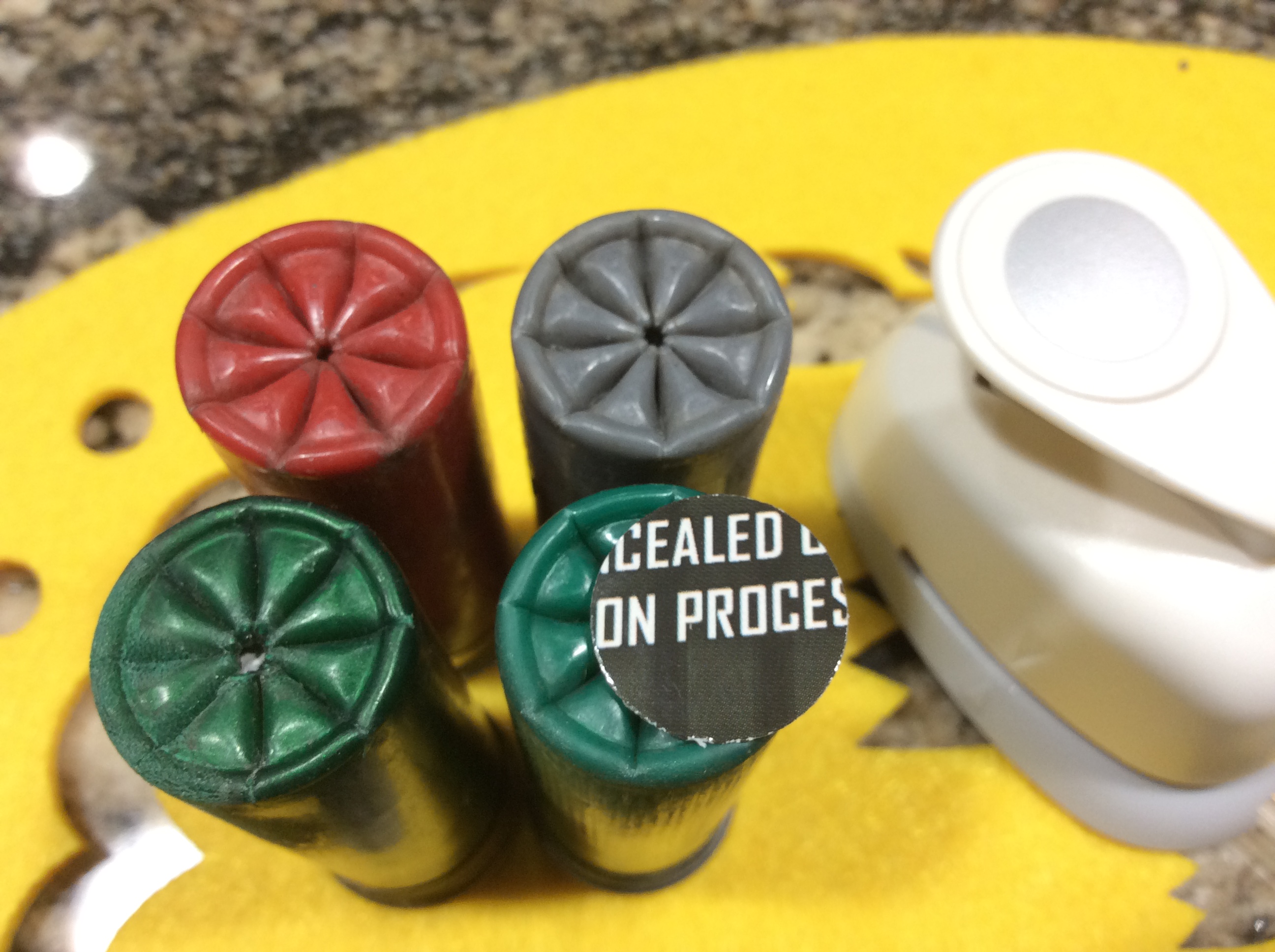

Sarival Slim Posted April 1, 2021 Posted April 1, 2021 I am now using the Dillon 900, like it best, had a RCBS Grand, liked it too and before that MEC 650, it worked also. Here is the cheat code that works for me in all three. 5/8” hole punch from Hobby Lobby or any craft store. Postcard thickness paper. Rule around here is anything that comes in the mail on postcard thickness paper is turned into overshot card. It is an extra step; place card over shot. I can place almost any hull without changing a thing and the crimp comes out fine. Some are prettier than others. (Disclaimer: I’m no expert in this field, I am a “good enough” guy. :))
Hogleg Hunter Posted April 1, 2021 Author Posted April 1, 2021 Sarival Slim, Where did you get the punch? Hogleg
Rattlesnake Slim Posted April 1, 2021 Posted April 1, 2021 Rumor has it that his wife picked it up for him at either Hobby Lobby or Michael's. I know he wouldn't be caught dead in either place.
Hogleg Hunter Posted April 1, 2021 Author Posted April 1, 2021 13 minutes ago, Rattlesnake Slim said: Rumor has it that his wife picked it up for him at either Hobby Lobby or Michael's. I know he wouldn't be caught dead in either place. He must not be a fly fisherman then. They have inexpensive fly tying materials. Besides, who would recognize me with sun glasses and my hat pulled down low.

Chancy Shot, SASS #67163 Posted April 2, 2021 Posted April 2, 2021 On 4/1/2021 at 10:17 AM, Hogleg Hunter said: Sarival Slim, Where did you get the punch? Hogleg At Hobby Lobby, look for "circle punch - 5/8" At Michaels, look for "Lever Punch, Circle by Recollections™" Chancy
