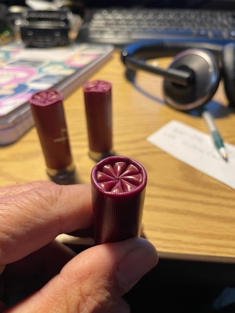

Diamond Jake Posted November 30, 2020 Posted November 30, 2020 Does anyone get more than one reload out of roll crimped hulls? I just started shotshell reloading, and my star crimps are horrible. My roll crimps perform a lot better, but the shot hulls stay a bit crimped and it's too hard to get the wads in for the second reload. (I'm using BP and fiber wads.)
J-BAR #18287 Posted November 30, 2020 Posted November 30, 2020 27 minutes ago, Diamond Jake said: I just started shotshell reloading, and my star crimps are horrible. (I'm using BP and fiber wads.) Describe horrible: domed, caved, leaking shot, pinwheeled...?? In my experience most crimp problems in black powder shells can be fixed by tweaking the powder charge up or down to get the column height just right. Blackpowder and subs are very forgiving that way. I also have always preferred 8-point to 6-point crimps.
Diamond Jake Posted November 30, 2020 Posted November 30, 2020 2 hours ago, J-BAR #18287 said: Describe horrible: domed, caved, leaking shot, pinwheeled...?? The proverbial pictures worth thousands of words: One is one of my best; two are of my worst. One is a typical roll crimp. I've read enough to know that the column height is the issue, but if I use only one fiber wad the column is too short, unless I load more powder and shot than I need for SASS matches. (I got some decent crimps with one fiber wad, but it was 75 gr FFG and almost 1 1/4 oz shot.) If I use two fiber wads (which I don't want to do for several reasons) the charge is lighter than I want.
John Kloehr Posted November 30, 2020 Posted November 30, 2020 6 minutes ago, Diamond Jake said: The proverbial pictures worth thousands of words: One is one of my best; two are of my worst. One is a typical roll crimp. I've read enough to know that the column height is the issue, but if I use only one fiber wad the column is too short, unless I load more powder and shot than I need for SASS matches. If I use two fiber wads (which I don't want to do for several reasons) the charge is lighter than I want. I'm still reading, learning, and studying. So this answer is from book lernin'. You can split the wads. Besides overall column height, my reading suggests the wad should be at least as tall as the distance between the end of the shell and the entry to the barrel. But then, my reading also suggests it really does not matter at SASS distances. But you can split the wads which might fix the crimp challenge. Try 1-1/2 wads.
Diamond Jake Posted November 30, 2020 Posted November 30, 2020 But my main question is still "How many people get more than one reloading with BP?" If most people find their hulls are too damaged from the heat of BP to be worth reloading a second time, then I'll just do roll crimp. Or, if the little tool that expands the mouth of the hull of shot roll crimped hulls works effectively I might do that. Come to think of it, the really bad star crimps in my pic with the ripped crimps may have been on their second reload with BP, making the plastic brittle.

Abilene Slim SASS 81783 Posted December 1, 2020 Posted December 1, 2020 I use once-fired AA hulls for both smokeless and real BP. Some could be reloaded again for smokeless, but I don’t bother because most have pinholes in the creases, which affects the final crimp. AA’s are useless after one load of real BP. Those who use Remington STS report more reloads because it’s a better hull. I don’t bother with ribbed hulls. I don’t give any thought to the number of reloads because the supply of once-fired AA’s is plentiful at our range. Lots of shooters don’t reload and I don’t mind picking thru the buckets. I have the tools for roll crimping, but it’s too time consuming for me unless I want a shortened shell. Star-crimp shells can go awry for a variety of reasons including hull condition, a worn crimp starter die or mis-adjusted press. Check the troubleshooting section of your owners manual. If you don’t have one, most can be downloaded online. There’s likely a YouTube video out there as well. Adding on, I load 40gr equivalent of 2f Goex under a pink Claybusters wad and 1oz #8 shot. Crimps are a whisker concave, but not enough to leak any shot. Press is an old Mec 650.
Abilene Slim SASS 81783 Posted December 1, 2020 Posted December 1, 2020 4 hours ago, Diamond Jake said: The proverbial pictures worth thousands of words: One is one of my best; two are of my worst. One is a typical roll crimp. I've read enough to know that the column height is the issue, but if I use only one fiber wad the column is too short, unless I load more powder and shot than I need for SASS matches. (I got some decent crimps with one fiber wad, but it was 75 gr FFG and almost 1 1/4 oz shot.) If I use two fiber wads (which I don't want to do for several reasons) the charge is lighter than I want. What kind of press was used for star crimp?
Diamond Jake Posted December 1, 2020 Posted December 1, 2020 45 minutes ago, Abilene Slim SASS 81783 said: What kind of press was used for star crimp? An old MEC600 jr that I got at an estate sale for $30. I only use it for depriming, pushing the wads in, and crimping. I measure powder and shot with Lee dippers. There were no crimp starters when I got the press so those are new.
Abilene Slim SASS 81783 Posted December 1, 2020 Posted December 1, 2020 15 minutes ago, Diamond Jake said: An old MEC600 jr that I got at an estate sale for $30. I only use it for depriming, pushing the wads in, and crimping. I measure powder and shot with Lee dippers. There were no crimp starters when I got the press so those are new. Here’s a link to a pre-1985 Mec Jr. https://www.mecoutdoors.com/Content/documents/600jr.pdf Read the sections about the crimp starter and final crimp carefully. Your good shell looks like item 4 in the troubleshooting guide. Suggest you back off a bit. The mashed crimps could be bad hulls. The opening of the hull should look uniform. If one or more of the creases vary too much, the crimp starter will mangle them. Also be sure that the crimp starter is free to move on its pivot. If this doesn’t work, try smooth sided hulls. Good luck!
