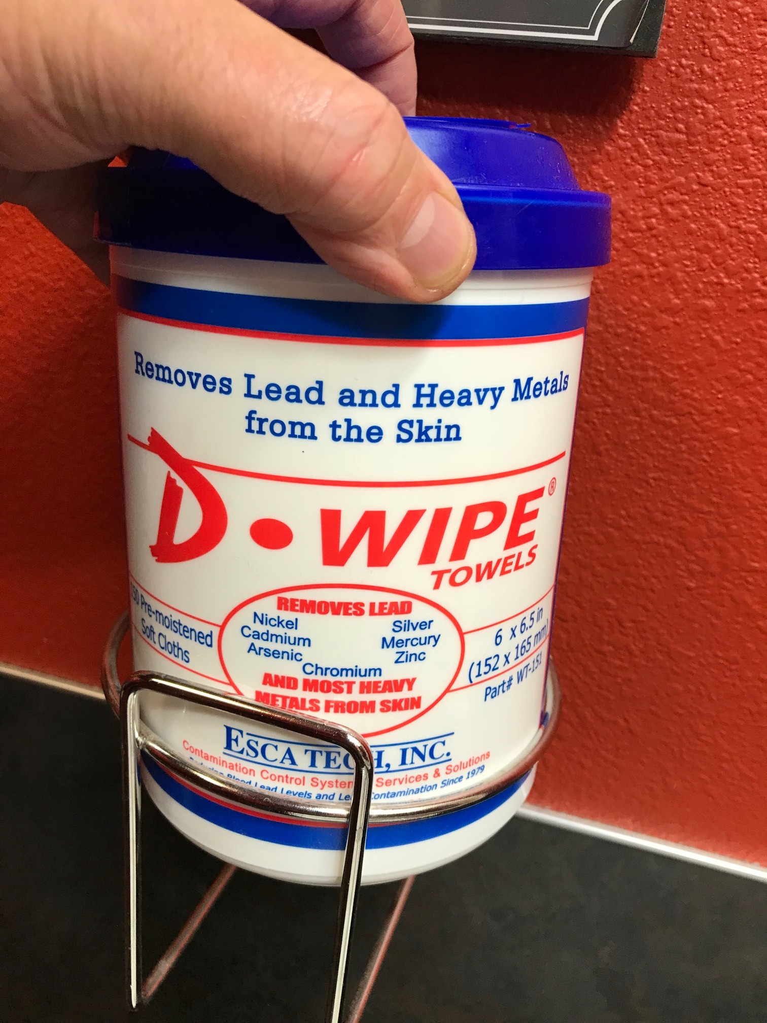

Pat Riot Posted March 14, 2018 Posted March 14, 2018 Well, I got my blood tested and I was surprised. My lead level is <2ug/dl. Less than 2 is good. I figured it would be much higher. I wash my hands a lot when handling brass and reloading. I use nitrile gloves most of the time when tumbling. I always make sure I have air flow when I dump brass and media for sifting and I started using a dust mask for that. Something I discovered at the indoor range I go to is these lead removing wipes. They are like handi-wipes for lead. Here is a photo of the container. I use these every time I shoot there. I need some for home.
