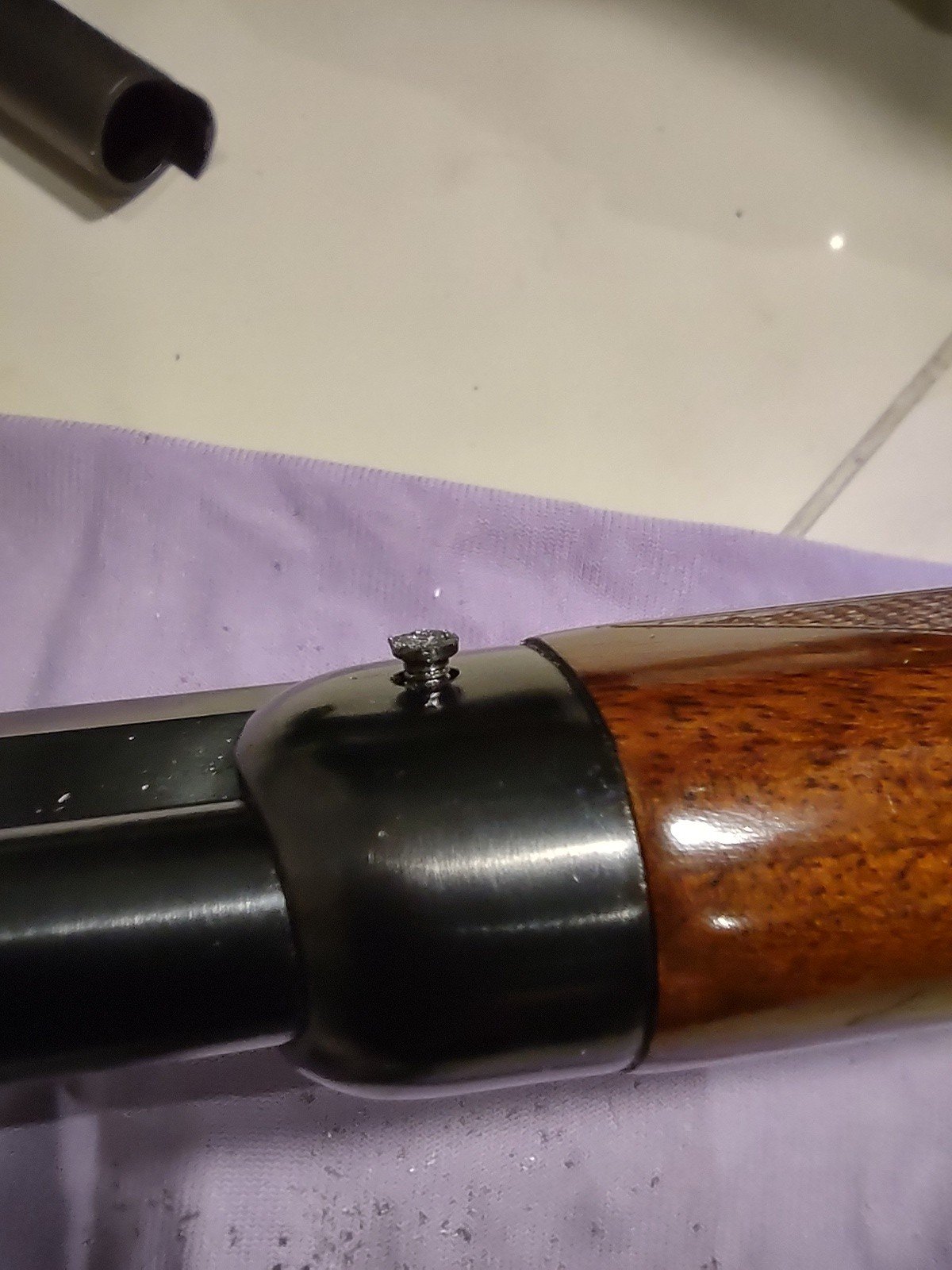

Orient Express Posted April 6 Share Posted April 6 (edited) I'm in in the process of refinishing my stocks as I need another project. I've done my stoeger and now moved into my Uberti 1873 rifle. The butt stock was easy to get off however the fore end proved challenging. It seems Luigi at the Uberti factory was feeling very frustrated when he assembled my foreend as the end cap screw was impossible to get lose and my gunsmithing bits just ate into the soft metal. I tried a soldering iron with oil, hitting with a rubber mallet and then resorting to left-handed drill bits and a drill run very slowly. Thankfully it was aligned enough not to cut into the end cap itself. Edited April 6 by Orient Express Quote Link to comment Share on other sites More sharing options...

Woody Shootem, SASS # 24816 Posted April 7 Share Posted April 7 (edited) I had the same problem on the same screw as the OP. I had to remove some material from the end of the nosecap (where it meets the wood; see picture) so that the hole and the threads lined up correctly. That was the root cause of the problem. Edited April 7 by Woody Shootem, SASS # 24816 Quote Link to comment Share on other sites More sharing options...

Woody Shootem, SASS # 24816 Posted April 7 Share Posted April 7 3 hours ago, Springfield Slim SASS #24733 said: So when the wood and metal don't match you remove metal? Seems backwards to me, seems the wood wasn't fitted properly at the factory. It was way easier for me to remove the metal from the forend cap with a belt sander and touch up with cold blue than to do all the work to reshape the wood then touch up the stain and varnish. Truth be told, I think the real problem is the hole in the forend cap was drilled in the wrong spot, but of course I couldn't do anything about that. My screw was actually cross threaded into the forend tennon block underneath it, and I had to replace the block as well as the screws. All good, now, though. Quote Link to comment Share on other sites More sharing options...

Colorado Coffinmaker Posted April 8 Share Posted April 8 Look closely at the OP's photo. The screw hole in the Fore End Cap and the Tenon Block are not aligned. This causes the threads to bind. If not corrected, the screws will simply bind again or worse, cross thread and ruin the Tenon Block as happened to Woody. Quote Link to comment Share on other sites More sharing options...
Hendo Posted April 8 Share Posted April 8 3 hours ago, Colorado Coffinmaker said: Look closely at the OP's photo. The screw hole in the Fore End Cap and the Tenon Block are not aligned. This causes the threads to bind. If not corrected, the screws will simply bind again or worse, cross thread and ruin the Tenon Block as happened to Woody. This was the problem with mine. I cleaned the threads up with a die and chased the threads in the tenon. (Had to, replacements were on backorder.) I put Loctite on the buggered screw and started it first, then made sure the "clean" side lined up and put it in, then tightened them both up. My backordered parts came in a couple of weeks later, so they're hanging on the wall for when I pull that cap off again. Quote Link to comment Share on other sites More sharing options...
