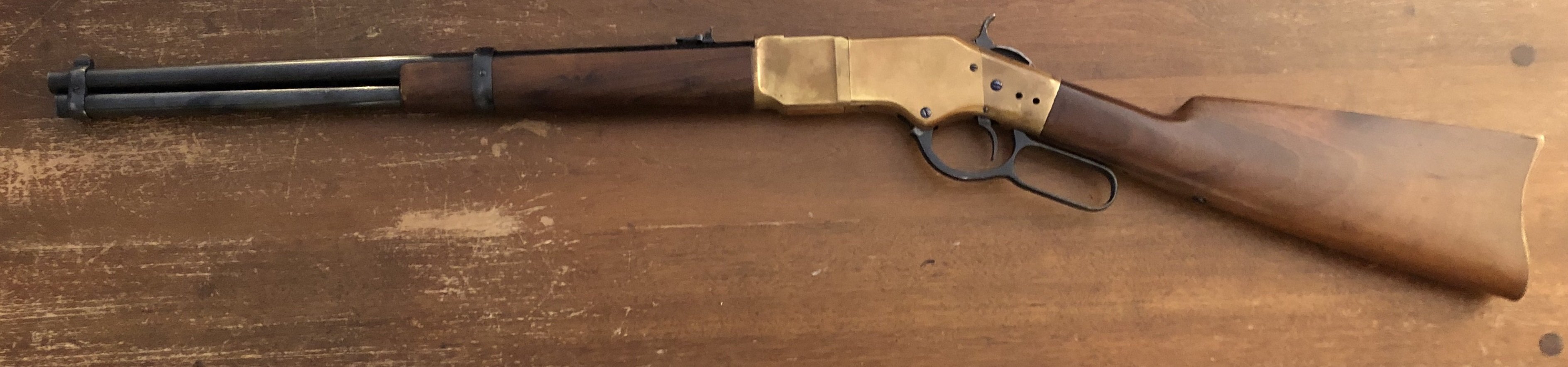

Chas B. Wolfson, SASS #11104 Posted January 17, 2022 Posted January 17, 2022 I recently purchased this very early Uberti/Navy Arms import 1866. Serial number is 914, production code XXVll which equates 1971. Factory engraved. 44WCF caliber. Uberti in Italy so far not willing to look into history. I am curious if anyone here has ever seen or owned a similar example. Thanks for any information provided. Regards, Chas B PS I am aware of lack of parts similar to newer production guns.
Tex Jones, SASS 2263 Posted January 17, 2022 Posted January 17, 2022 Although the original owner has passed, his son, Val Forgett III, heads Navy Arms, which is now located in W. VA. He might be able to give you some information on the carbine as it would have been a special item. Nice looking piece. I also had a low serial number carbine I bought at an auction many years ago. Like yours it had a lever safety, which was on the early models. The lever was bent and I sent it to Navy, who repaired it. Handy little carbine.
H. K. Uriah, SASS #74619 Posted January 17, 2022 Posted January 17, 2022 I also have a very early one by Navy Arms, and I find it to be a nice gun. The previous owner had removed the lever safety and had done, in my opinion, a far too aggressive action job to it. The hammer fell so slowly that it would not hit the primers hard enough to make them go bang. I took the gun to Happy Trails and asked him if he could return it to "more or less factory specs." He did. The action is still smooth, but it now goes bang, or boom, when I need it to. Lever safety is back. It does not seem to be short stroked. These very early ones, you will notice, have a kind of a notch in the receiver in the ejection port. That's because they made them very, VERY close to the specs of the originals, the ejection port of which is to small for .44-40's. Thus, the notch on these early ones that is not on the current productions. And, this is why the parts are not all that compatible with the new ones either. But, if I found another one in .45, I'd probably get it. They are nice guns.
Chas B. Wolfson, SASS #11104 Posted January 17, 2022 Author Posted January 17, 2022 The very first long gun Apple Annie started with in 1998 was an early Navy import '66 carbine in .38spl. Serial number was just below 900. She shot that gun for many years with zero problems. The previous owner finally talked her out of it. She replaced it with a Sante Fe Arms import '73 carbine, engraved side plates and nickled in .357mag. Again, never a problem. Fairly early as well but later dimensions. Tex Jones, thanks for the advice. I sent Navy an E-mail with above pics. Chas B
watab kid Posted January 17, 2022 Posted January 17, 2022 nice looking rifle , id not see one of these early ones before
Cypress Sun Posted January 17, 2022 Posted January 17, 2022 I hope you got a good deal on it...somebody scratched that thing all up.

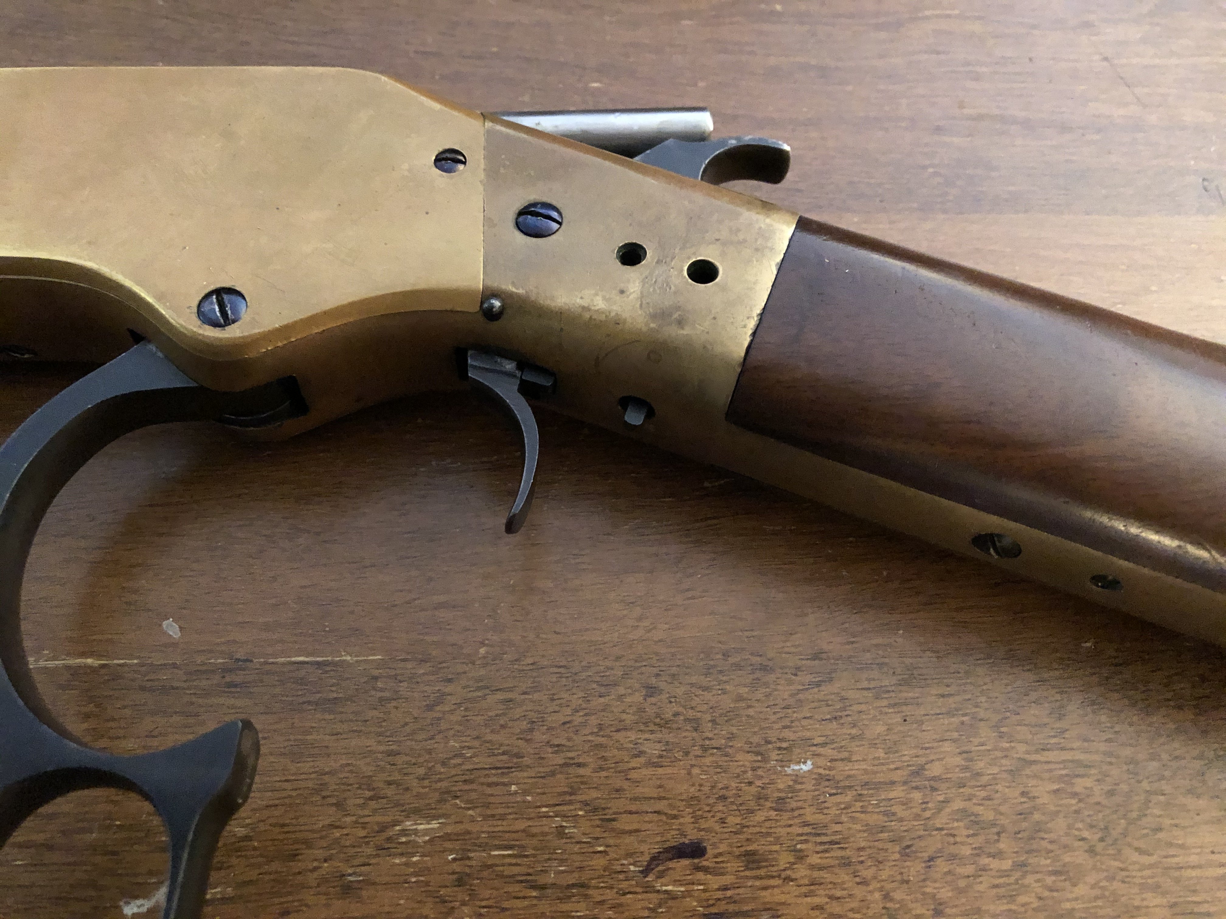

H. K. Uriah, SASS #74619 Posted January 17, 2022 Posted January 17, 2022 1 hour ago, watab kid said: nice looking rifle , id not see one of these early ones before I can't resist that comment. Here's some pics of mine. it has a 1200 range serial number. As you can see, mine is not as fancy as the the one that started the thread, and the saddle ring has been removed. Not been able to find a replacement. Here's a closeup of the lever safety. And here's the above mentioned notch in ejection port. Now you've seen 2 of them!

Kid Rich Posted January 17, 2022 Posted January 17, 2022 I have one in 44/40 also looks pretty fancy. kR
Randy Saint Eagle, SASS # 64903 Posted January 17, 2022 Posted January 17, 2022 4 hours ago, Cypress Sun said: I hope you got a good deal on it...somebody scratched that thing all up. Even the screws! Randy
H. K. Uriah, SASS #74619 Posted January 17, 2022 Posted January 17, 2022 2 hours ago, watab kid said: thats nice as well , see the saddle ring has been removed , by you ? why ? Removed by the previous owner. I don't know why. I'd like to replace it, but I've not been able to find one. I'm not sure the modern made ones have the same dimensions as these early Navy Arms ones.
Chas B. Wolfson, SASS #11104 Posted January 17, 2022 Author Posted January 17, 2022 8 hours ago, Tex Jones, SASS 2263 said: Although the original owner has passed, his son, Val Forgett III, heads Navy Arms, which is now located in W. VA. He might be able to give you some information on the carbine as it would have been a special item. Nice looking piece. I also had a low serial number carbine I bought at an auction many years ago. Like yours it had a lever safety, which was on the early models. The lever was bent and I sent it to Navy, who repaired it. Handy little carbine. Navy Arms contacted me today. Unfortunately, when Val passed on and the original company closed, all records were turned into the BATF. Thus the current company has no way of researching this gun. I am hitting a brick wall on this one. Chas B

watab kid Posted January 18, 2022 Posted January 18, 2022 7 hours ago, H. K. Uriah, SASS #74619 said: Removed by the previous owner. I don't know why. I'd like to replace it, but I've not been able to find one. I'm not sure the modern made ones have the same dimensions as these early Navy Arms ones. hope you find one that fits , i too would want it back like it was suposed to be , but i understand that we cant always control how things come to us , shame previoous owner didnt save original bits to pass along when sold - i do that if i alter something

Palouse Posted January 19, 2022 Posted January 19, 2022 On 1/17/2022 at 6:52 AM, Chas B. Wolfson, SASS #11104 said: ...1866. Serial number is 914, production code XXVll ... I am curious if anyone here has ever seen or owned a similar example. The staple is "J"-shaped, threaded on long leg. When installed, tip of short leg sits in forward hole. Long leg extends far enough through rear hole for small nut to be threaded onto shank and tightened from back and inside of receiver. Maybe any Uberti 66 or 73 staple will fit? Removed the staple from my early 66 'cause I don't like floppy-noisy-obtrusive things hanging from my firearms. Serial numbers seem to be consecutive and mixed with Henry versions, running to high-40,000s, or about 1980, when the carrier was lengthened and notch dissappears. When were first Uberti 1873 rifles advertised? 1980? The Judge ran a Santa Fe 1866 in .38spl, with a brass plated (or all-brass) magazine tube. I have a 44-40 Henry rifle with receiver notch and lever safety, early serial number.
