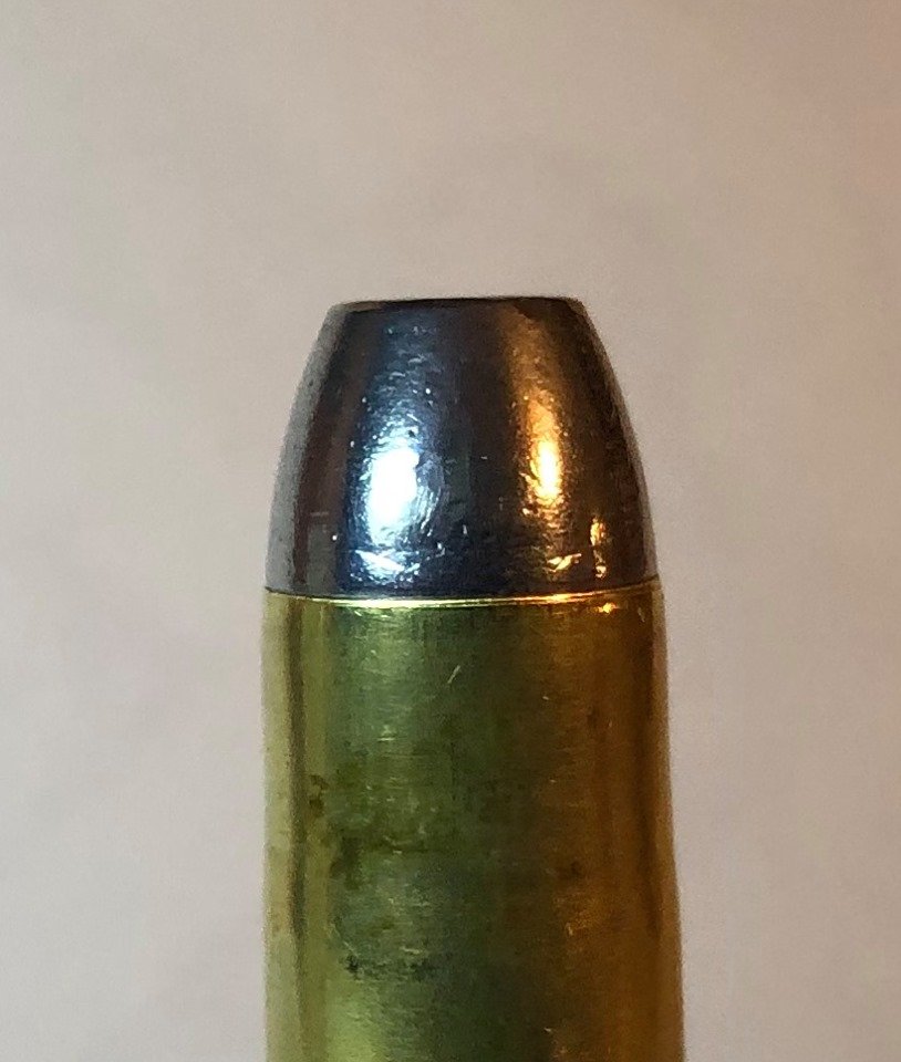

Savvy Jack Posted December 1, 2019 Posted December 1, 2019 Same bullet, 43-214A, cast with wheel weights, pulled after being crimped with a Redding 44-40 Profile Crimp Die

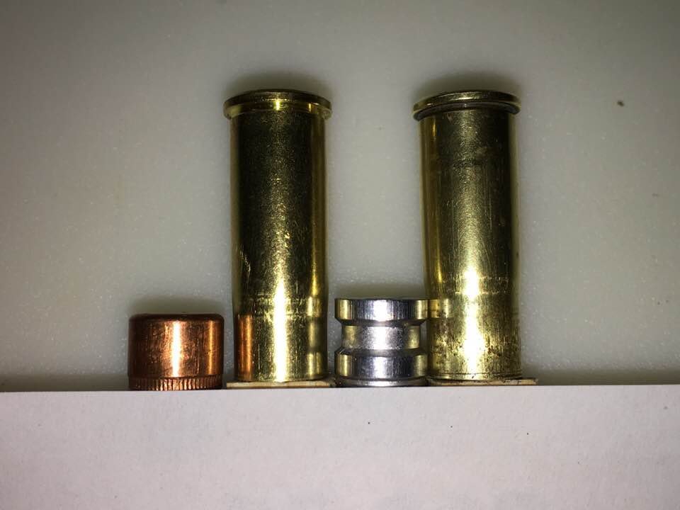

Savvy Jack Posted December 2, 2019 Posted December 2, 2019 If you are interested in seating depths...if using the lead bullet in the case to the left, the only neck retention is on the forward driving band if your theory is to crimp above the forward driving band on the 427098 bullets. The neck on the case to the right has been extended from .33" to .40" for proper neck retention on deep seated 427098 bullets. This is not needed if crimped just below the top of the forward driving band and properly crimped with the Redding profile crimp into the soft lead. Case necks need to be sized .03" longer than bullet seating depth to give needed base support in addition to the crimp. This is consistent with industry practice in loading lead bullet ammunition in other calibers, such as the .38 Special ~John Kort

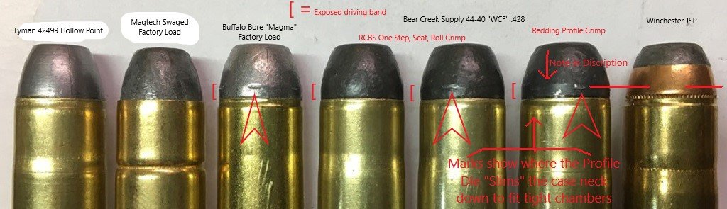

Savvy Jack Posted December 4, 2019 Posted December 4, 2019 This is the best I can explain the Redding Profile Crimp in comparison to other crimps. In my opinion the Redding crimp works in two parts working together;... 1. For lead bullets without a crimp grove, the first part "roll" crimp works best. The roll is so shallow it is more like an exaggerated taper crimp that forms to the O'give curvature (Bullet Profile), rolling enough to squeeze into the soft lead. 2. The "second part" is evident when crimping the small diameter (.4255) Winchester and (.426) Remington JSP bullets. Just like any other die, the amount of the crimp needed is be adjusted by screwing the die in further. The number of turns the die is turned in from the .428" 43-214A crimp setting to the .4255" Winchester JSP "U" crimp setting is only 5/8 of a turn. In the photo below the difference in the "two part" crimp should be evident. First is the roll crimp into the start of the crimp grove. This crimp is nice and snug (in addition to the smaller resizing die size case neck) on the curve of the canular's bottom edge. This first part, the roll crimp, prevents the inertial dislodgement from recoil when used in revolvers. The second crimp (really only one crimp step) is a "U" shape that forms to the inside of the curved canular groove. This "U" shaped formed crimp prevents the bullet from telescoping into the magtube of a rifle due to the pressure from the mag tube spring. The 44-40 Redding Profile Die does not work well with any 44 caliber lead or jacketed bullet that does not have an original 44-40 O'give profile. When using the popular 200gr Oregon Trail Laser Cast bullet, this die may hit the exposed forward driving band. When the Profile Die is used properly, a canular in the case below the bullet's base is not needed. ALWAYS test a batch of your handloads before shooting. This can be a learning process but I promise you will like it once you get the hang of it. I hope this helps. EDITED: The one thing I failed to add was to make sure you resize your cases to the smallest size available and expand to the smallest size available when using the .4255/.426 JSP bullets. The RCBS Cowboy dies do not resize or expand to the smallest size needed to give good neck retention with the smaller diameter bullets.
