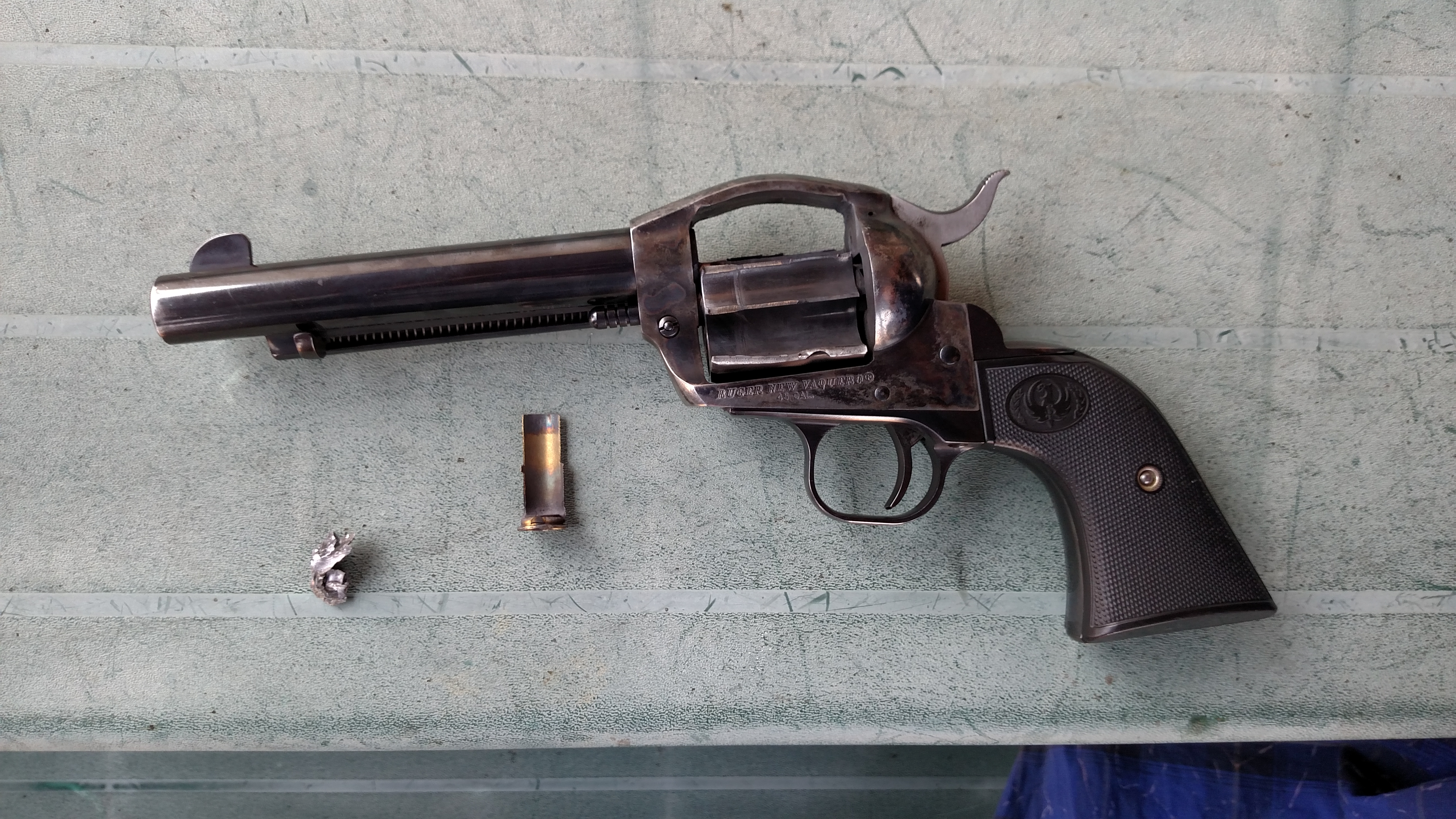

Charlie T Waite Posted September 12, 2017 Posted September 12, 2017 Caution should always be observed when reloading to insure you do not overload or double charge the cartridge. We had this happen to a shooter at a match on sunday. He was not injured as these were Rugers and not another brand, nut notice I said "lucky"! He also destroyed the internal workings of his 76 73 rifle. These were 45 colt cartridgies. Be careful out there and always double check before you seat the bullet. When in doubt, weigh the powder throw & check it against reliable loading data. By the way a bunch of us looked but could not find the rest of the parts. Charlie

Charlie T Waite Posted September 12, 2017 Author Posted September 12, 2017 It was a 73, I fat fingered the keyboard and will correct it. He said he was using trailboss when we ask. Since I have never used it I don't know, but from what I have heard it couldn't be that. Some were thinking it was toght group.
Garrison Joe, SASS #60708 Posted September 12, 2017 Posted September 12, 2017 Well, almost certainly not TB - it would be hard to double charge and not see case overflowing. Does that shooter load or even have on his loading bench a jug of Bullseye, by any chance? Although TiteGroup is also a very high nitroglycerin content double base powder, so it has almost the same type of concern as Bullseye. Good luck, and glad the shooter survived with all his digits. Praise the Lord for that. GJ Yes, reloading is just about the same as rocket science. You have to pay attention, or you will pay the piper.

Charlie T Waite Posted September 12, 2017 Author Posted September 12, 2017 We didn't have a Chrono with but his loads were extremely hot. There were no squbbed bullets. We found 2 pieces of the brass case, 1 long brass sliver and a perfectly round base containing the primer. Also what appeared to be part of a shaved bullet. There was some nice demples in the steel as well. His rifle broke after 2 rounds on the 1st stage so he spotted and picked up brass. The MD had told him his rounds were to hot. He fired 1 test round after the match and that was when his rugar blew the cylinder.so that was the only loaded round in the gun when this happened. We told him not to fire anything in his other pistol until he had it checked to see if he had damaged it during the 1st stage as well. My whole point was that care needs to be taken when reloading, check, double check triple check even ask for help. this is our game and as much as we love it, it is not we all know that safety comes 1st. Charlie

Charlie T Waite Posted September 13, 2017 Author Posted September 13, 2017 All, This is from the MD at the match -"What happened in this case, was that the shooter had been using TrailBoss but then switched over to TiteGroup. However, he did not adjust his powder bar. We measured and found 16.2 grains in one case. Far, far exceeding any maximum load" Again, the MD handled everything correctly, The shooter was offered other guns and ammo to use but declined. Hope this ends some of the speculation about double bullets. Charlie
