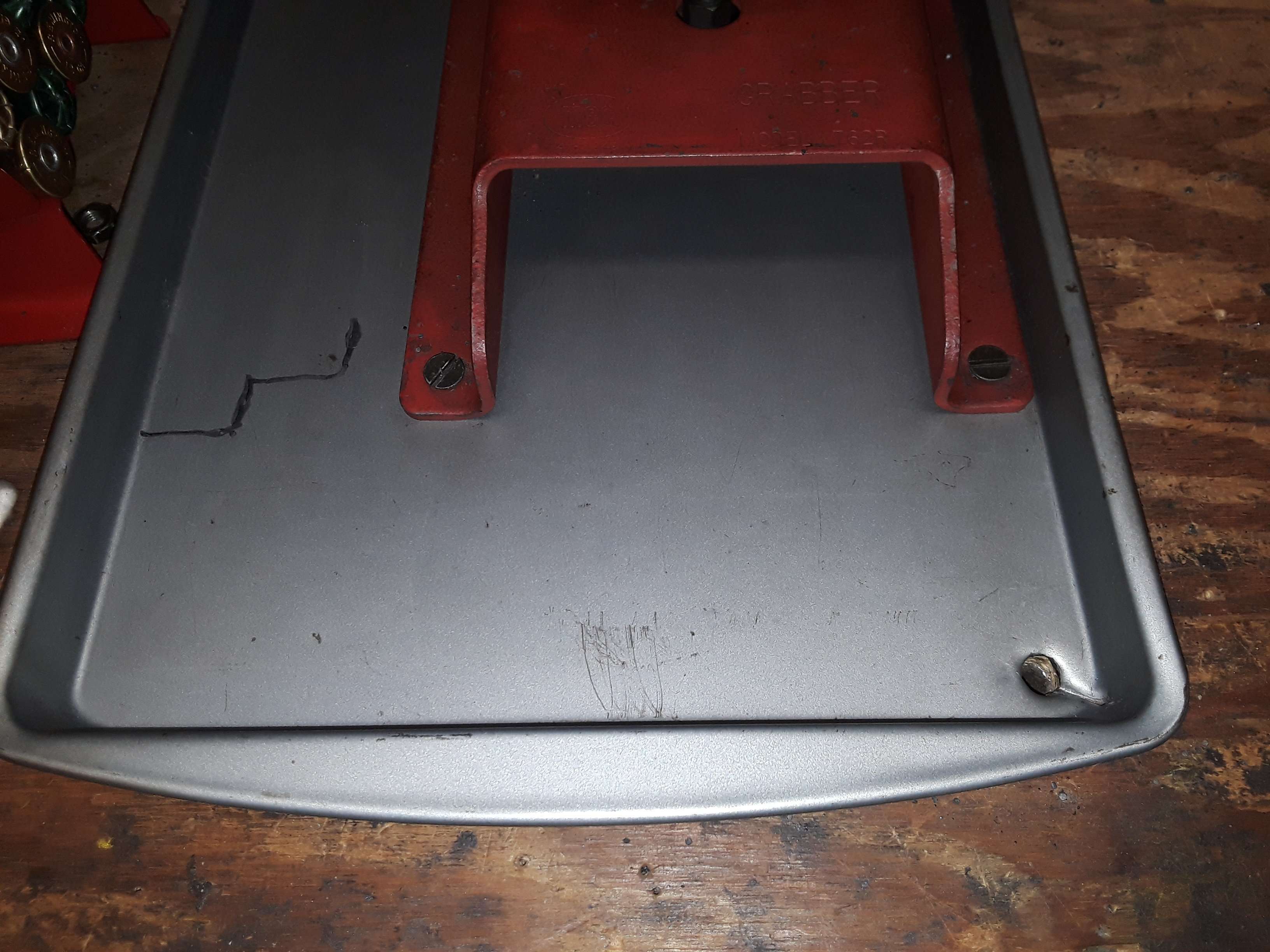

Reverend P. Babcock Chase Posted June 27, 2023 Posted June 27, 2023 Howdy Sedalia and others, Plus one for the cookie sheet deal. The guy I got my first shot shell press from told me about the cookie sheet and I went a step further by hanging the edge of the sheet beyond the edge of the bench and drilling an approx 1'2 inch hole in a corner of the sheet which I plug with a cork. I just sweepi the shot into the hole with a cup under it. Works great and saves a bunch of time when (not if) you spill some shot. Rev. Chase
Lucky R. K. Posted June 27, 2023 Posted June 27, 2023 Here is the setup I use for all my shotgun presses. When I have a spill I just sweep everything into the hole. There is a bottle below that receive3s everything. I use a mesh screen to separate everything. Lucky
Eyesa Horg Posted June 27, 2023 Posted June 27, 2023 2 minutes ago, Lucky R. K. said: Here is the setup I use for all my shotgun presses. When I have a spill I just sweep everything into the hole. There is a bottle below that receive3s everything. I use a mesh screen to separate everything. Lucky Just curious, is there a reason you didn't center the press on the pan? As the inevitable seems to happen every now and then, I've been thinking about putting one under my Grabber as well.
J.S. Sooner, SASS #73526 Posted June 27, 2023 Posted June 27, 2023 35 minutes ago, Eyesa Horg said: Just curious, is there a reason you didn't center the press on the pan? As the inevitable seems to happen every now and then, I've been thinking about putting one under my Grabber as well. I use a metal picture frame around my Mec presses. Buy at a craft store, thrift store or cheaper from a yard sale. It's flat on all edges, sits flat on my bench top, and when I need to clean up a spill all I do is pull one corner off the bench to sweep everything into a container.
Lucky R. K. Posted June 28, 2023 Posted June 28, 2023 23 hours ago, Lucky R. K. said: Here is the setup I use for all my shotgun presses. When I have a spill I just sweep everything into the hole. There is a bottle below that receive3s everything. I use a mesh screen to separate everything. Lucky Notice the black magic marker marks on the left side of the tray. they indicate the area where I line up 25 shotgun hulls ready to be loaded. In other words it gives me room to lay out hulls to be loaded readily at hand. Lucky
