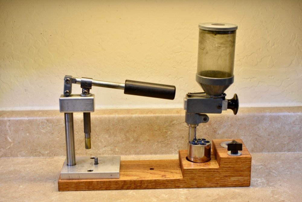

Larsen E. Pettifogger, SASS #32933 Posted January 1, 2021 Posted January 1, 2021 Here's cylinder in the gun charger. Body is an OLD Dillon manual measure. I made the rest.

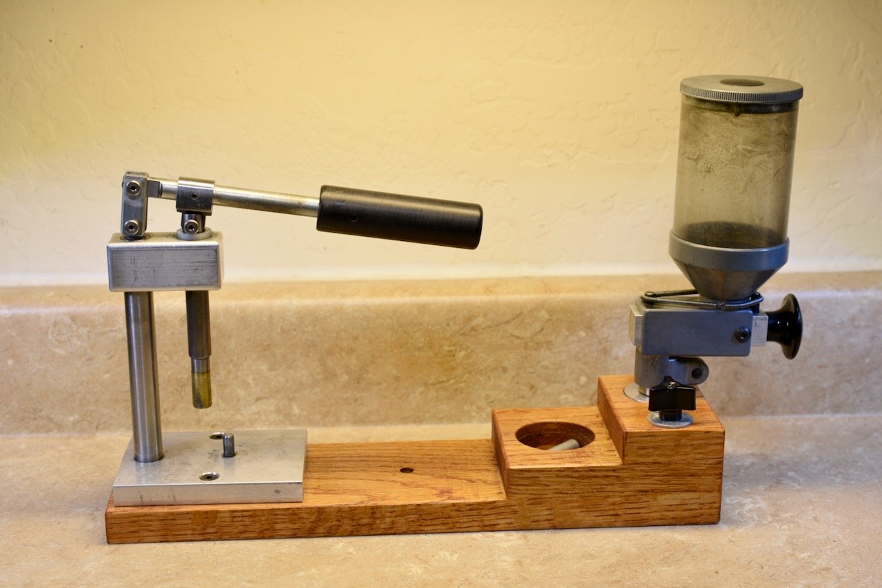

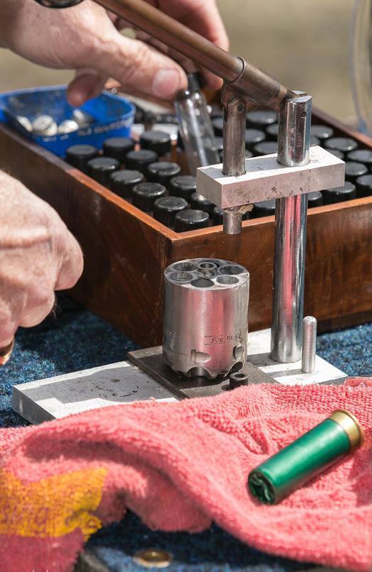

Larsen E. Pettifogger, SASS #32933 Posted January 1, 2021 Posted January 1, 2021 Here is my cylinder out of the gun setup. The whole thing fits in a tray on top of the cart. Five quick pulls of the powder charge bar and the cylinder is charged. Then place the balls over the chambers move the cylinder to the seater and seat them. The link on the left of the ball seater keeps the rammer verticle. The top of the rammer is pinned to the shaft and does not move. The movement is in the link. Very smooth. I hate those seaters that rely on a bushing that slides on the rammer arm.

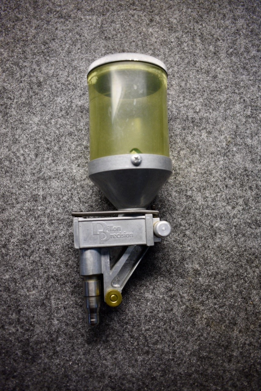

Warden Callaway Posted January 1, 2021 Author Posted January 1, 2021 46 minutes ago, Larsen E. Pettifogger, SASS #32933 said: Here's cylinder in the gun charger. Body is an OLD Dillon manual measure. I made the rest. Aha!, I got it, you converted it to pull to pick up the next charge and spring back to drop. I have two of these measures but wouldn't want to give up one to make one like you show.
Larsen E. Pettifogger, SASS #32933 Posted January 1, 2021 Posted January 1, 2021 Just now, Warden Callaway said: Aha!, I got it, you converted it to pull to pick up the next charge and spring back to drop. I have two of these measures but wouldn't want to give up one to make one like you show. Correct. I spent a lot of time on EBay and found three of the old measures.
Warden Callaway Posted January 1, 2021 Author Posted January 1, 2021 10 minutes ago, Larsen E. Pettifogger, SASS #32933 said: Correct. I spent a lot of time on EBay and found three of the old measures. One came with my 450. I found a second at a flea market table in a gunshop. I use them both.
Larsen E. Pettifogger, SASS #32933 Posted January 1, 2021 Posted January 1, 2021 Compare this photo to the three above. The link has moved to accomodate the bullet seating stem. The two screws in the link are shoulder bolts so the friction surfaces are on ground smooth round areas rather than on the threads.
Tequila Shooter Posted January 1, 2021 Posted January 1, 2021 I guess I’m the odd man out, if I don’t use the rammer on the pistol I use this Squishes all the chambers at one time.

Colorado Coffinmaker Posted January 2, 2021 Posted January 2, 2021 YESSSSSSSSSSSSSS !!! APP and Black MZ make things SO much easier. No muss, no fuss, lotta smoke. Gotta Love it. NowI just gotta find one of those old Manual Dillon Powder Measures. Could use an RCBS I suppose, but them things weigh a TON!!!
