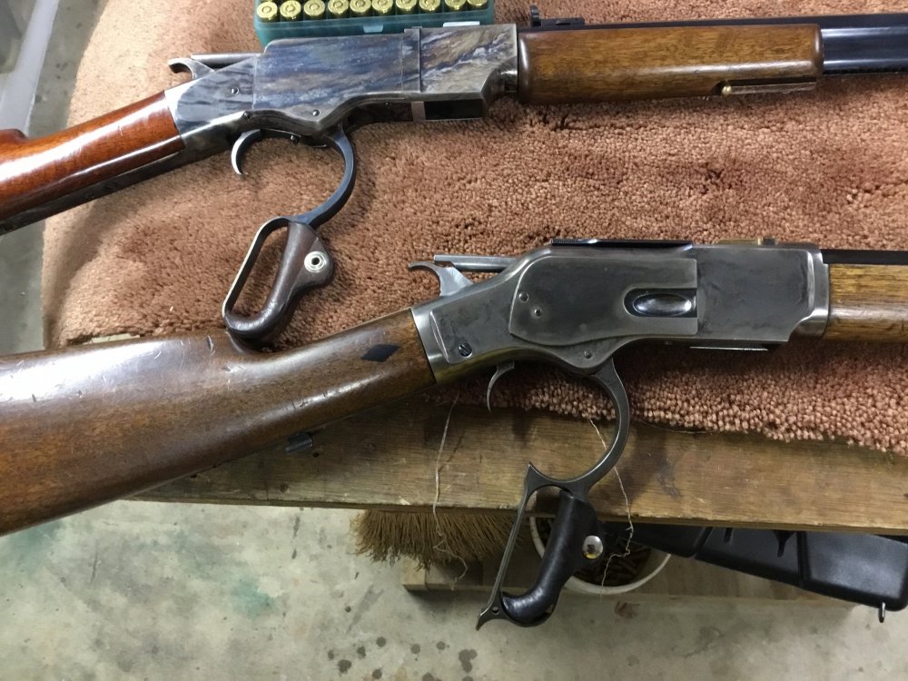

Cypress Sam, SASS #10915 Posted August 27, 2019 Posted August 27, 2019 Short stroked Henry compared to short stroked ‘73.
Driftwood Johnson, SASS #38283 Posted August 27, 2019 Posted August 27, 2019 3 hours ago, Cypress Sam, SASS #10915 said: Short stroked Henry compared to short stroked ‘73. That's some fancy tricked out Henry, with its buttoned on leather lever wrap and the short little wooden fore end. The stroke is shorter than on mine. When Happy Trails installed the short stroke in mine he asked if I wanted the 'wicked' short stroke or just a 'regular' short stroke. I said regular. No, I have no idea what specific short stroke links he used. Anyway, I see the tab of the follower extending down at the end of the slot in your wooden fore end. Are you using some sort of spacer stick so the follower will push the last round onto the carrier?
Phantom, SASS #54973 Posted August 27, 2019 Posted August 27, 2019 27 minutes ago, Driftwood Johnson, SASS #38283 said: That's some fancy tricked out Henry, with its buttoned on leather lever wrap and the short little wooden fore end. The stroke is shorter than on mine. When Happy Trails installed the short stroke in mine he asked if I wanted the 'wicked' short stroke or just a 'regular' short stroke. I said regular. No, I have no idea what specific short stroke links he used. Anyway, I see the tab of the follower extending down at the end of the slot in your wooden fore end. Are you using some sort of spacer stick so the follower will push the last round onto the carrier? Careful on the legality of that mod.

Cypress Sam, SASS #10915 Posted August 28, 2019 Posted August 28, 2019 20 hours ago, Driftwood Johnson, SASS #38283 said: That's some fancy tricked out Henry, with its buttoned on leather lever wrap and the short little wooden fore end. The stroke is shorter than on mine. When Happy Trails installed the short stroke in mine he asked if I wanted the 'wicked' short stroke or just a 'regular' short stroke. I said regular. No, I have no idea what specific short stroke links he used. Anyway, I see the tab of the follower extending down at the end of the slot in your wooden fore end. Are you using some sort of spacer stick so the follower will push the last round onto the carrier? Driftwood, Yes there is a wooden spacer stick like the one you pictured in other posts so that the follower will push the cartridges onto the lifter. I made another follower that has a 3/16” brass rod that fits the slot in the sliding wood fore end better than the thumb-button on the stock follower, function is the same though. I was was just trying to respond to Charlie McNeil’s original post asking if an 1860 Henry can be short-stroked. I’ve already been soundly trashed in a previous post by Coffinmaker, Phantom and others about what they consider questionable modifications to my Henry (which I DON’T use in competition in that configuration). But the question was about short strokes, answer - yes, Henrys can be short-stroked.
