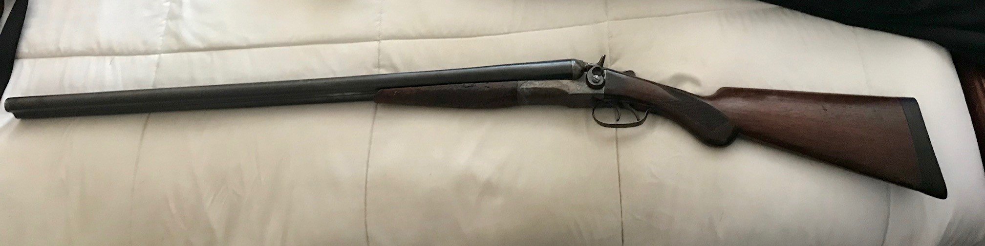

Kansas City Munny Posted August 15, 2019 Posted August 15, 2019 I recently acquired a Central Arms Co. model 3012 double that I'm fairly sure was produced by J. Stevens around 1918-1919. The barrels are pretty long, but I may shoot Classic Cowboy from time to time and need a hammered double. The bore is bright ans shiny and it seems to function as it should. Barrels are marked "High Pressure Compressed Steel, Barrel and Lug Forged in One Piece". UPDATE - I had a shop measure the chambers with a chamber gauge and they measure just over 2-3/4". The smith was confident that the Winchester AA Light Target loads I'm normally shooting will work just fine in this piece. Again, not sure about the forcing cones as this was just a quick look over and chamber measurement while chatting with the shop guys. Another idea is to shoot it with the Aguila Mini Shot Shells. They're 1-3/4" long, and are readily available in lead # 7-1/2, 8 and 9 shot. Does anyone shoot these in CAS? Will they actually knock down a knock-down target? Any thoughts?

Warden Callaway Posted August 15, 2019 Posted August 15, 2019 It's made well into the smokeless powder era and should have steel barrels. Seeing that it has shiny barrels, it was not likely ever shot with black powder. The chambers are likely not compatible with modern folded crimp shells with plastic wads. But a gunsmith can lengthen the chambers and improve the forcing cone. You did good. One of the few post Damascus and black powder hammer guns to be made. The only negative is the hammers are too short and far apart for double cocking.

Trooper Ozzy Posted August 16, 2019 Posted August 16, 2019 Just run magtech all brass hulls cut to correct length or cut down and roll crimp plastic. That will eliminate chamber length problems.
Warden Callaway Posted August 16, 2019 Posted August 16, 2019 2 minutes ago, Trooper Ozzy said: Just run magtech all brass hulls cut to correct length or cut down and roll crimp plastic. That will eliminate chamber length problems. That's what I do with my old shotguns. But I have a few Stevens that I had the chambers recut and it reduced the recoil noticeably.
Colorado Coffinmaker Posted August 16, 2019 Posted August 16, 2019 KC Munny ...... An excellent find. Actually superb actually. I ... Like Warden Callaway have a "thing" for Hammer Doubles. I don't necessarily champion Damascus guns, but guns like yours are just the ticket. You may wish to have the forcing cones lengthened as that will cut felt recoil appreciably. Nice Find.

Kansas City Munny Posted August 16, 2019 Author Posted August 16, 2019 Thanks for all of the great feedback. I'll either give it a good once over or have a smith inspect it and maybe lengthen the forcing cones as suggested since that seems like a pretty good idea. I'll also read the rule book on hammers. Maybe there is a way to make it a little faster to run...

Warden Callaway Posted August 20, 2019 Posted August 20, 2019 Shorter barrels will make it handier around props. But a lot of folks like long barrels because they tend to point better. Sacrilegious? I probably wouldn't cut them but it's not like it's a Parker or fine English double. One thing to mention. Because it's a hammer double, cutting it down won't change how it opens. Cutting the barrels on guns with internal hammers can mess up how it opens and how far it stays open.

Kansas City Munny Posted September 4, 2019 Author Posted September 4, 2019 UPDATE - I had a shop measure the chambers with a chamber gauge and they measure just over 2-3/4". The smith was confident that the Winchester AA Light Target loads I'm normally shooting will work just fine in this piece. Again, not sure about the forcing cones as this was just a quick look over and chamber measurement while chatting with the shop guys. Another idea is to shoot it with the Aguila Mini Shot Shells. They're 1-3/4" long, and are readily available in lead # 7-1/2, 8 and 9 shot. Does anyone shoot these in CAS? Will they actually knock down a knock-down target? Any thoughts?

Colorado Coffinmaker Posted September 5, 2019 Posted September 5, 2019 NAH. Lots of really good opinions. Personally, I never met barrels too short. I happen to like 18 1/4 inch. Should it happen at some later date you feel you need a tighter choke, just have choke tubes installed. If you pattern a gun at CAS distance with open chokes you'll be surprised at just how small the pattern really is.
