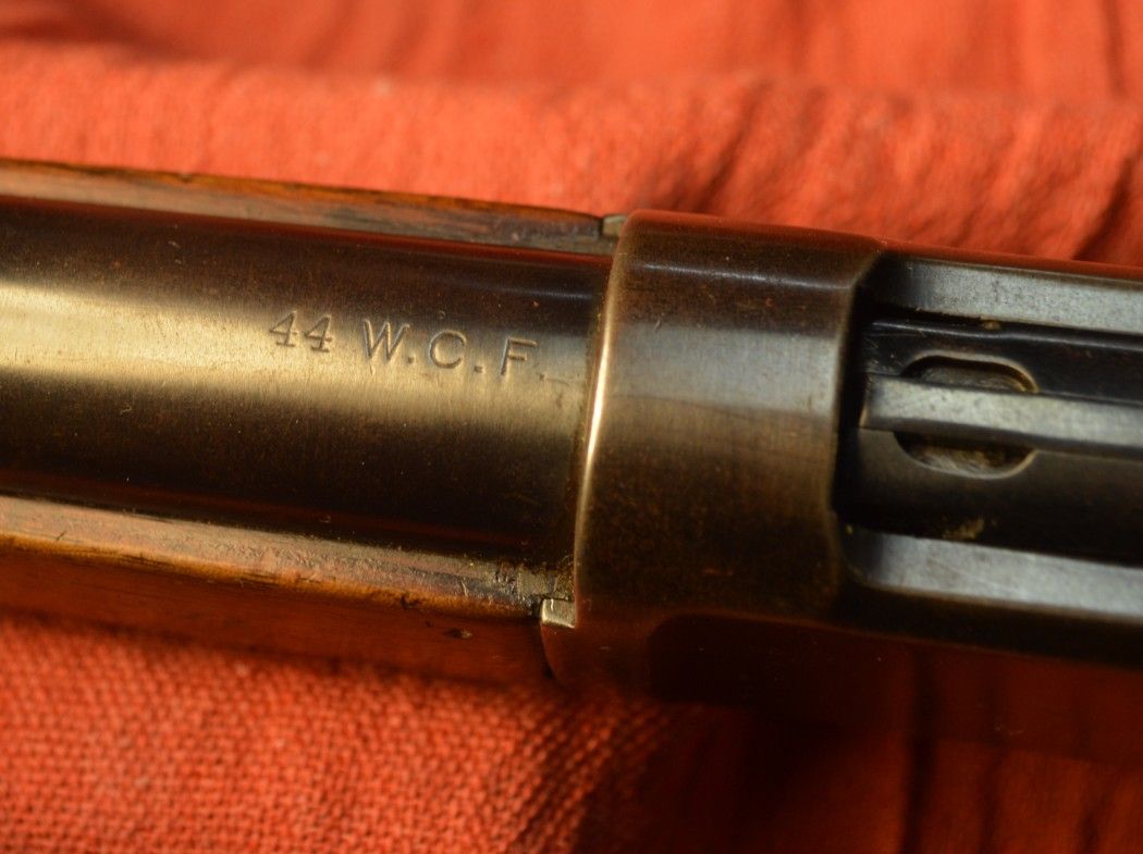

Bull Skinner Posted July 15, 2019 Posted July 15, 2019 The simplest solution is shoot 44-40. Much less grief and work than 45 Colt or any straight wall case. And I totally agree that calling black powder hoaky euphemisms like”holy black” grate on my nerves. If ya gotta use another name for it, gun powder is a good one. That’s what it’s been called for hundreds of years.
Stopsign32v Posted July 15, 2019 Author Posted July 15, 2019 9 minutes ago, Bull Skinner said: The simplest solution is shoot 44-40. Perfect, I'll just throw 44-40s into this rifle.
Bull Skinner Posted July 15, 2019 Posted July 15, 2019 The point is, the work, grief and expense of getting a 45 Colt chambered rifle to shoot BP efficiently will pay for the cost to trade the rifle for one in 44-40. Don’t ask how I know this. Been there and done that. Consequently I own 3 rifles chambered in 44-40. Two of them were obtained by trading my 45 Colt rifles for them. Best money I ever spent.

Stopsign32v Posted July 15, 2019 Author Posted July 15, 2019 10 hours ago, Bull Skinner said: The point is, the work, grief and expense of getting a 45 Colt chambered rifle to shoot BP efficiently will pay for the cost to trade the rifle for one in 44-40. Don’t ask how I know this. Been there and done that. Consequently I own 3 rifles chambered in 44-40. Two of them were obtained by trading my 45 Colt rifles for them. Best money I ever spent. What work and grief is there to get the 1866 to shoot 45 Colt black powder? Sounds like no extra grief to me.

Driftwood Johnson, SASS #38283 Posted July 15, 2019 Posted July 15, 2019 Howdy Again Talked to two pards yesterday who shoot Black Powder 45 Colt loads in their rifles. One shoots a '73 and takes the sideplates off a few times a year to clean out any fouling. The other shoots a Henry and anneals his brass. I seem to recall he said he has never had the side plates off. I could be wrong. Of course, removing the side plates from a Henry is more of a pain than removing them from a '73 or '66.
Driftwood Johnson, SASS #38283 Posted July 15, 2019 Posted July 15, 2019 12 hours ago, Bull Skinner said: he point is, the work, grief and expense of getting a 45 Colt chambered rifle to shoot BP efficiently will pay for the cost to trade the rifle for one in 44-40. Don’t ask how I know this. Been there and done that. Consequently I own 3 rifles chambered in 44-40. Two of them were obtained by trading my 45 Colt rifles for them. Best money I ever spent. You pays your money, you takes your choice. I have never owned a rifle chambered for 45 Colt. Except one that I won in a raffle and promptly sold to help pay for my 44-40 Henry. My experience with 44-40 goes back to my first rifle I used in CAS almost 20 years ago, an original Winchester Model 1892 chambered for 44WCF (44-40). Yes, the marking is a little bit faded because the rifle was refinished at some point. Which made it more affordable than an unrefinished original '92. There were no rifles chambered for 45 Colt during the 19th Century, that is a modern variation, but that's a whole 'nother story. So early on I learned to load 44-40, and I always say it is a bit 'fussier' to load than 45 Colt. Not difficult once you have your dies set up correctly, but I always say the thicker brass of 45 Colt will take more abuse than the thinner brass of 44-40. I have to pay more attention loading 44-40 than 45 Colt. A little bit of inattention and I will probably ruin a round. In my experience 45 Colt is more forgiving. So yes, 44-40 (and 38-40) are perfect for shooting Black Powder in a rifle because the thin brass swells better at the relatively low pressures we are shooting at than the thicker brass of 45 Colt. (No, it has nothing to do with the bottleneck shape, high pressure gas has no problem going around corners.) Oh yeah, and because of the tapered shape there are no carbide dies available for 44-40, so you have to use a bit of case lube on the cases, which you don't have to do with the carbide dies that are available for 45 Colt. Will I ever own a rifle chambered for 45 Colt? Probably not because I like 44-40 so much. But you have to pay your money and take your choice.
