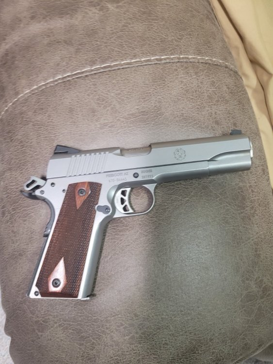

Buckshot Bear Posted January 29, 2023 Posted January 29, 2023 G'day fella's I bought a new Ruger SR1911 .45acp and need some advice. I've tried for a while to get into the Wild Bunch Forum (heaps of help from PWB who is a credit to this forum and SASS as a whole) but still no luck and have sent two emails to admin and still also no luck. So hope this is ok to post here just to get some help. Got the pistol, bought brass (LPP) and dies, looking at getting 230gr round nose projectiles (Hi-Tek coated). Are 230gr recommended? What's a good powder charge to have the pistol cycle well? Any other hints or tips? Here's a pic of the pistol -

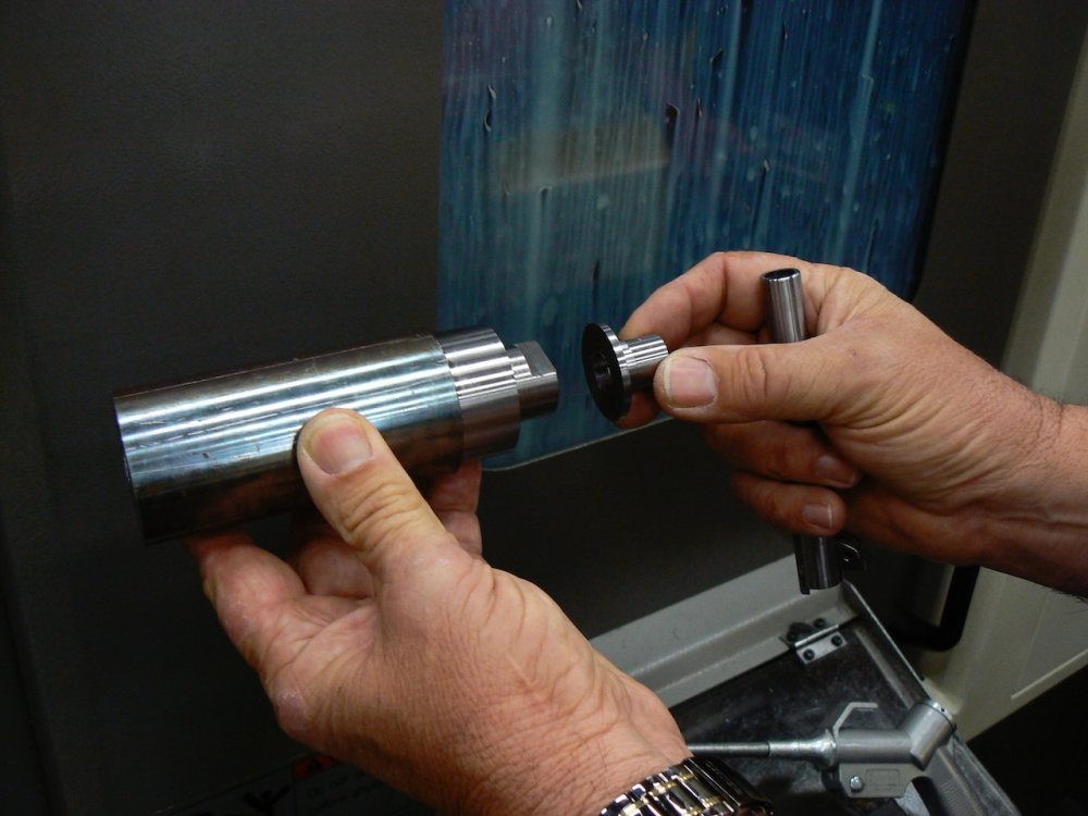

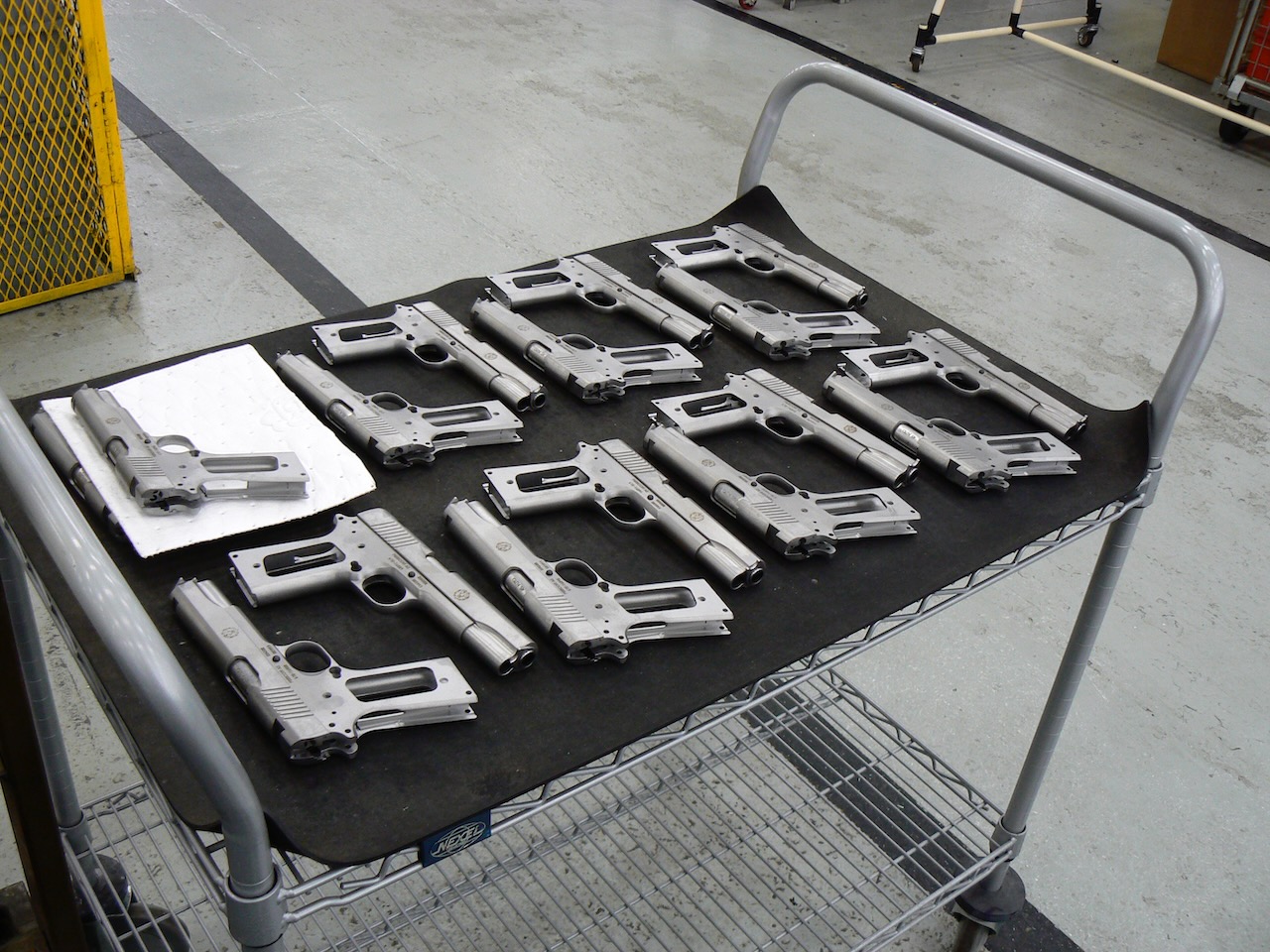

Larsen E. Pettifogger, SASS #32933 Posted January 30, 2023 Posted January 30, 2023 A few pictures you might enjoy. I took another tour of the Ruger plant in Arizona when the 1911 came out. At that time the Ruger rep said the 1911 had the tightest tolerances of any handgun they produced. The slides are machined from round bar stock. The preliminary machining of the frame. The barrel is also machined from a piece of round bar stock. In an initial operation the part that will become the barrel bushing is parted off from the main bar. The bushing and barrel stay together for all subsequent machining operations. They are a matched set. Final machining of the barrel. The finished slides are selectively fitted to a frame and then proceed together for subsequent finishing and final assembly.
