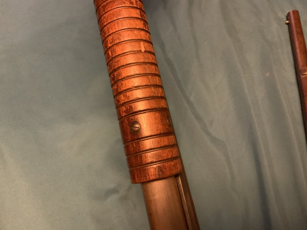

I would avoid a "C", first it had the 3 screw forend, and they were prone to failure. They can be worked on, but they are a bit convoluted and new wood is not available.

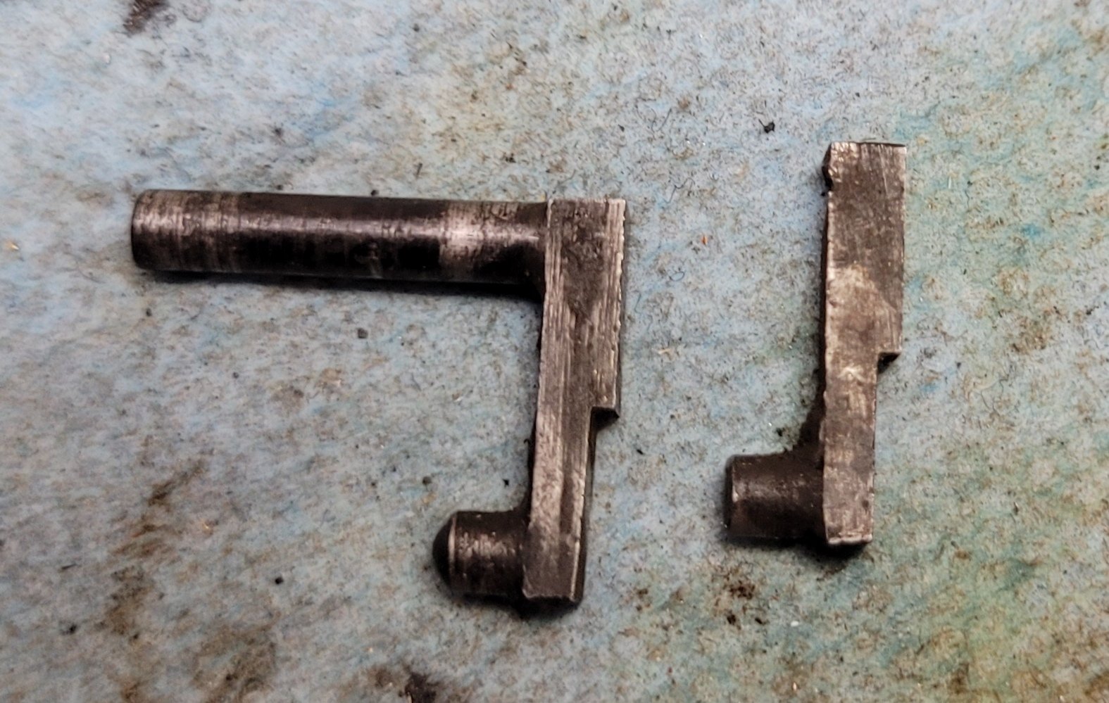

Sometime before the "E" series the firing pin interlock leaf spring was replaced with a coil spring, which is less prone to break. The firing pin interlock is a safety feature and should be checked. The gun will still work if the spring breaks. Easily checked without any tools, two hands will do.
Check for an empty chamber and magazine, With the action closed, cock the hammer fully. Now try and open the action, it should not open until you press the release button on the right side, up from the trigger about an inch. Open the action a bit, so there is about a 1/4" clearance between the carrier and bolt. With your little finger push on the firing pin, it should be locked, and sticking proud of the bolt by about 1/8". with the fingers on your left hand push up on the carrier slowly, maintaining pressure on the firing pin with your little finger. The firing should unlock just before the action is in full battery. While you're in this region test the bolt release. In half cock the bolt is locked, the release will not release the bolt. It will release the bolt when fully cocked. With the action closed, push the pump fully forward and release it. Now lower the hammer fully. If you pull back on the pump handle the action will remain locked close. Now push forward on the handle and the action will unlock. Beware, this feature is often defeated for competition. The common issue with this action is that dirt will accumulate under the interlock lever on the lifter. If the interlock doesn't work smoothly, there is a small part that connects the button to the lever that breaks, fairly often.
Broken part on the right, good part on the left.
Where that little stinker hides.

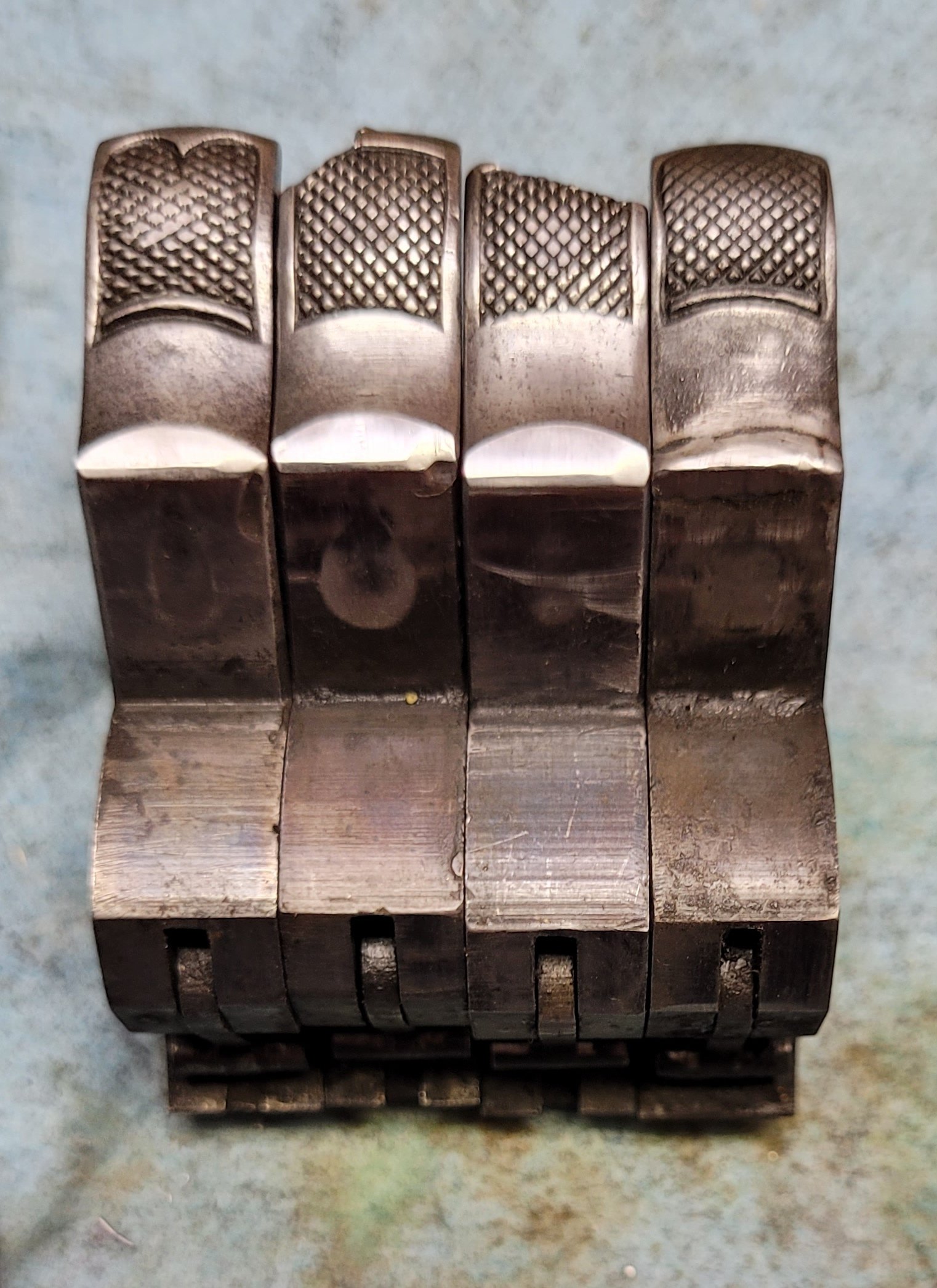

One common failure on 1897s is that the hammer will follow the bolt, fails to cock the hammer. This is usually due to lots of wear. Two places to check ar the wear point on the top of the hammer, wear on the bottom of the bolt and how much wiggle is in the bolt when the action is open. 1/4" up and down movement would be too much, 1/8" somewhat normal. Look at the wear point on the hammer, it may be welded (repaired) already, not a good sign. Mixing and matching parts is a better way to fix this.
The square shows one wear point that is an issue and can contribute to hammer follow. The oval shows the point where the bolt rides on and cocks the hammer. This particular gun had the start of hammer follow, I corrected it by replacing the bolt.
These used hammers are from L to R, good hammer, very little wear, second hammer has a battle scar or two, but still good, the third has some wear, the last hammer has been welded, typical mediocre job.

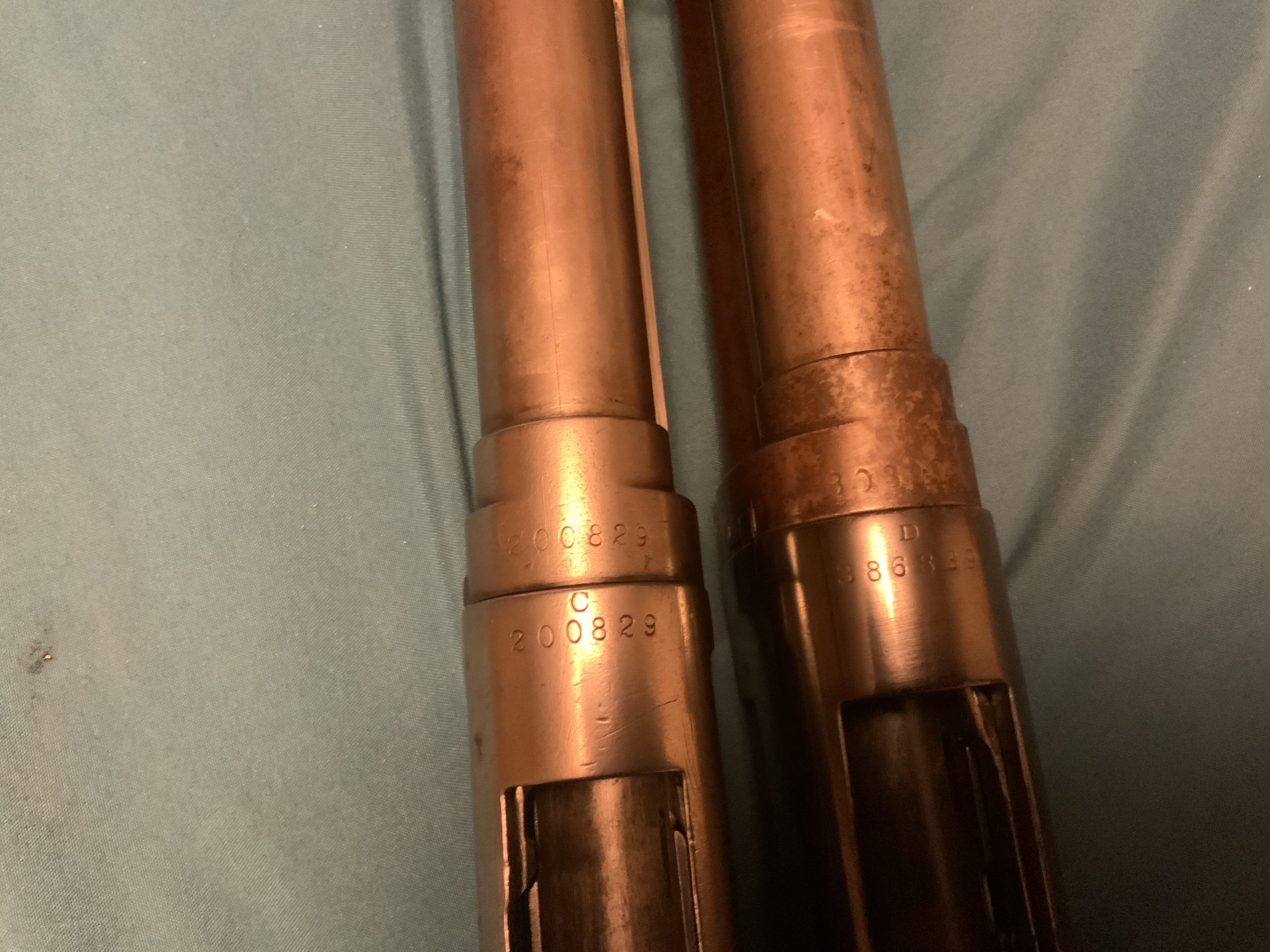

One looks on the frame where barrel attaches, next to the serial number.  A stand-alone letter on a Win 97.
Example of a C series:
23 minutes ago, H. K. Uriah, SASS #74619 said:
Sorry to ask this, but how do you tell if it's an E or D or a whatever "series?"
It’s stamped above the serial number on the bottom of the receiver. The forearm in the picture is a 3 screw forearm.
