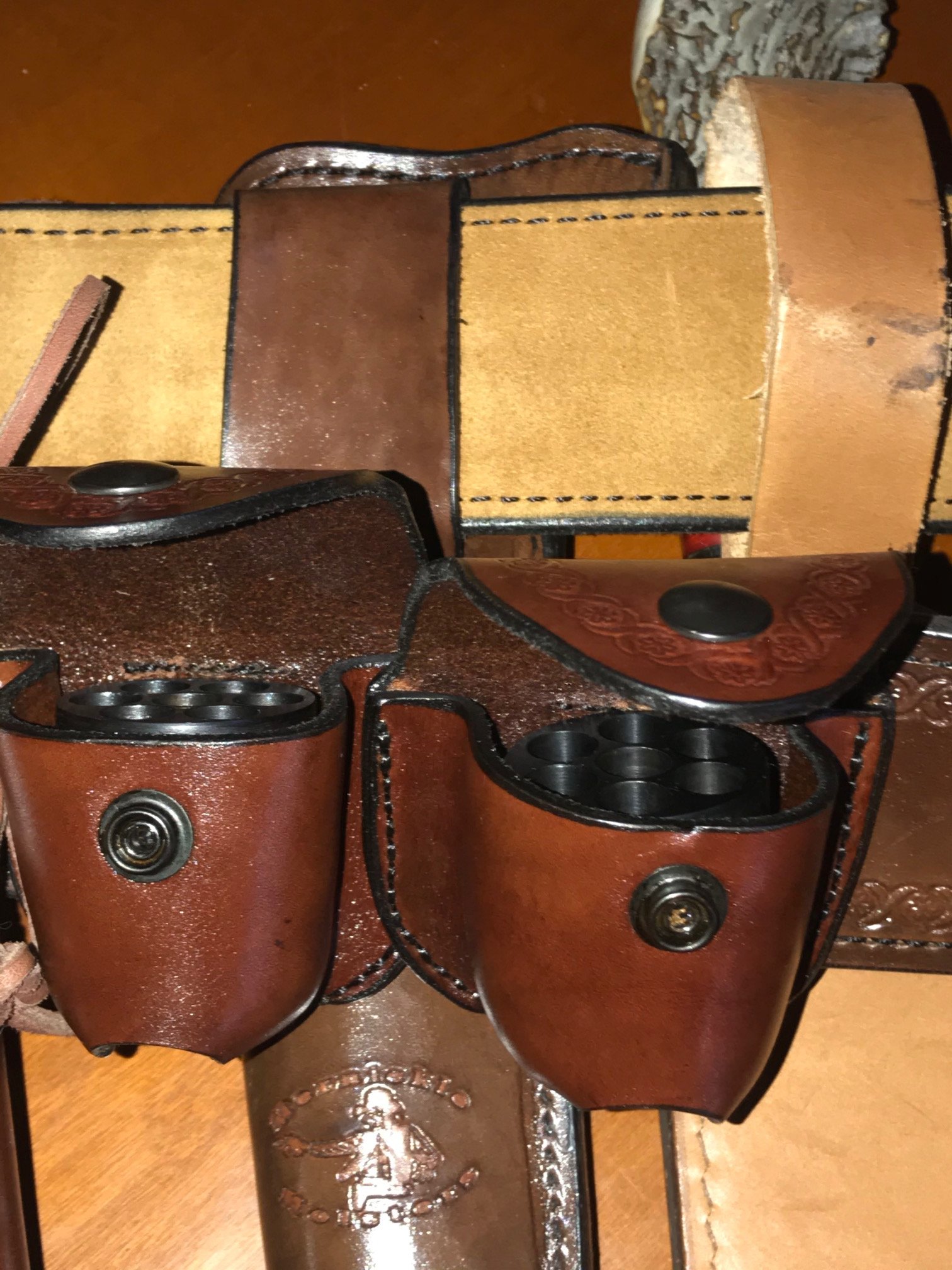

Major Crimes Posted April 29, 2021 Posted April 29, 2021 6 hours ago, TNtrapper said: Does anybody make a leather belt pouch especially for cylinders? The one I use is repurposed from an old black powder pouch. Mernickle made mine. They fit my Uberti .36 and Pietta .44 cylinders. https://www.mernickleholsters.com/shop/Cap-and-Ball-Spare-Cylinder-Pouch-p248161539
