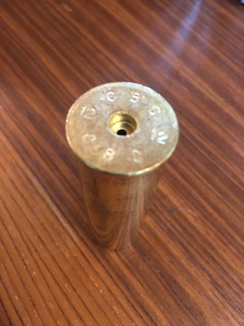

John Kloehr Posted June 24, 2020 Author Posted June 24, 2020 OK, found the thread: And confirmed from various sites I need large pistol primers (the mention of "large rifle primers" was acknowledged as a typo in the thread). But I recall some recommendations for certain brands being better than others, either for ignition of BP or for slicked guns which might strike softer (not hard primers). Then I need wads and overshot cards, shot, and powder. Oh goodie, more research and then searching for product.

Edward R S Canby, SASS#59971 Posted June 24, 2020 Posted June 24, 2020 42 minutes ago, John Kloehr said: OK, found the thread: And confirmed from various sites I need large pistol primers (the mention of "large rifle primers" was acknowledged as a typo in the thread). But I recall some recommendations for certain brands being better than others, either for ignition of BP or for slicked guns which might strike softer (not hard primers). Then I need wads and overshot cards, shot, and powder. Oh goodie, more research and then searching for product. Take a look at Ballistic Products for shotgun reloading supplies. Try to buy shot locally. Shipping costs for lead shot are high. Lots of vendors sell smokeless powder. You might try one of the BP subs until you are ready to buy a case of real black powder. I can buy APP or 777 a jar at a time at local sporting goods stores.

The Original Lumpy Gritz Posted June 24, 2020 Posted June 24, 2020 1 hour ago, John Kloehr said: OK, found the thread: And confirmed from various sites I need large pistol primers (the mention of "large rifle primers" was acknowledged as a typo in the thread). But I recall some recommendations for certain brands being better than others, either for ignition of BP or for slicked guns which might strike softer (not hard primers). Then I need wads and overshot cards, shot, and powder. Oh goodie, more research and then searching for product. Any brand LPP is fine for BP shotgun loads. No need to drill for 209's. Real BP is easier to ignite than smokeless. OLG
John Kloehr Posted June 25, 2020 Author Posted June 25, 2020 45 minutes ago, The Original Lumpy Gritz said: Any brand LPP is fine for BP shotgun loads. No need to drill for 209's. Real BP is easier to ignite than smokeless. OLG You are clearly a fan of Holy Black. I truly respect that. Give me some time to get there. Any concern about magnum large pistol primers? Will they increase pressures? And poking around somewhat aimlessly at all of the places sold out of primers... And powder... Learned there are DOT HazMat fees for shipping these items. One vendor was charging $35/pound hazmat fee. Midway charges a single $11.99 fee up to (I think it was) 5 pounds. Had too much tequila to order now, also FFg or FFFg for this venture? Looks like FFFg will go off a lot faster? And can I order any powder that is Pyrodex independent of brand name or are there differences? Hopefully I am asking all the right stupid questions rather than learning the hard way. Will also talk to a reloading friend tomorrow if he has time to put up with me

Tyrel Cody Posted June 25, 2020 Posted June 25, 2020 1 hour ago, John Kloehr said: You are clearly a fan of Holy Black. I truly respect that. Give me some time to get there. Any concern about magnum large pistol primers? Will they increase pressures? And poking around somewhat aimlessly at all of the places sold out of primers... And powder... Learned there are DOT HazMat fees for shipping these items. One vendor was charging $35/pound hazmat fee. Midway charges a single $11.99 fee up to (I think it was) 5 pounds. Had too much tequila to order now, also FFg or FFFg for this venture? Looks like FFFg will go off a lot faster? And can I order any powder that is Pyrodex independent of brand name or are there differences? Hopefully I am asking all the right stupid questions rather than learning the hard way. Will also talk to a reloading friend tomorrow if he has time to put up with me I've always been told to use FFg for larger calibers(44,45) and FFFg for smaller calibers. Personally I like FFFg in my 44's, burns a tad cleaner. Pyrodex is a BP sub that will start rusting your guns before you leave the range; avoid it. Grafs or Powder Inc. are good sources for the real thing. You want Goex or Schuetzen. Grafs house brand(rebranded Goex) is good stuff too; I use reneactor in my shotguns and FFFg in my rifles and handguns regardless of caliber.
The Original Lumpy Gritz Posted June 25, 2020 Posted June 25, 2020 You can use mag LP primers. Just no need to. Don't over think this..... OLG
John Kloehr Posted June 25, 2020 Author Posted June 25, 2020 5 hours ago, The Original Lumpy Gritz said: You can use mag LP primers. Just no need to. Don't over think this..... OLG I was looking at what is available. Until I found the mag primers, I did not even know there would be such a thing.
