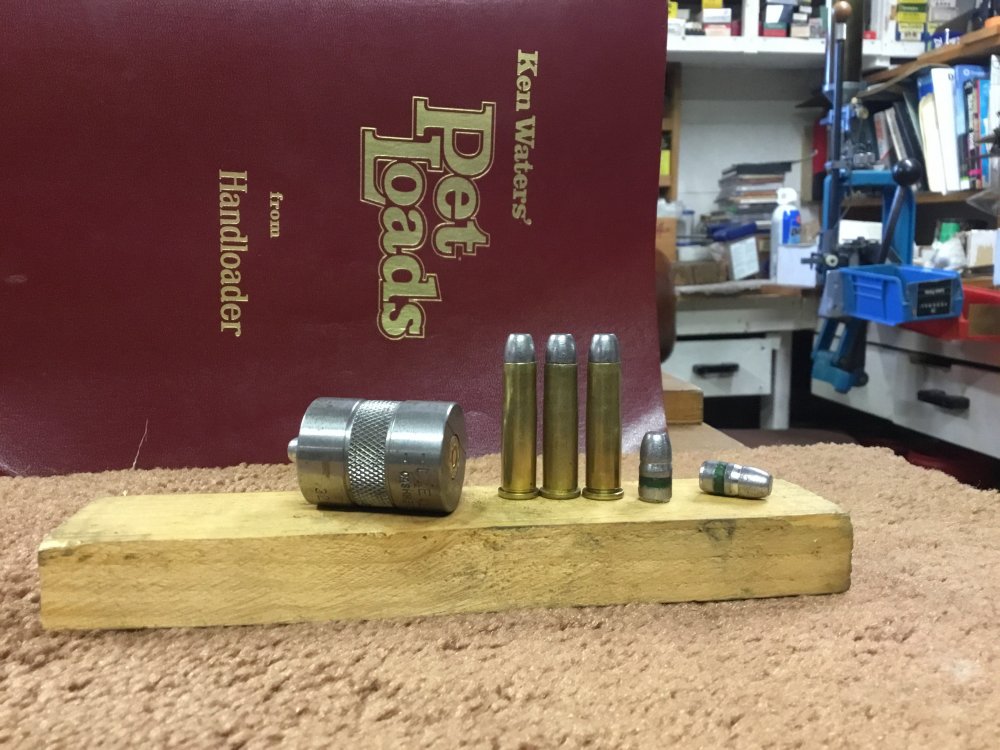

Cypress Sam, SASS #10915 Posted May 20, 2019 Author Posted May 20, 2019 Here is a picture of my Wilson chamber checker, a couple of bullets showing crimp groove, and three loaded rounds (Starline in the middle, R-P on outsides). You can see how much shorter the Starline is: 1.305” R-P vs. 1.265” Starline. TJB It doesn’t have to be Rocket Science to stump me. 12 hours ago, Texas jack Black SASS#9362 said: Rocket science this is not.

levi littleton Posted May 20, 2019 Posted May 20, 2019 7 hours ago, Cypress Sam, SASS #10915 said: Here is a picture of my Wilson chamber checker, a couple of bullets showing crimp groove, and three loaded rounds (Starline in the middle, R-P on outsides). You can see how much shorter the Starline is: 1.305” R-P vs. 1.265” Starline. Ken Water's book is a good one isn't it? Had it at least 30 years and still use it as a reference all the time. I understand how you got to where you are. BTDT and came to different solutions. I think you are having a couple of issues. First would be the improper mag tube size for proper stacking in the tube. It needs to me smaller that what 32-20 Uberti's are delivered with . Not the best but the 38 size works OK and is reliable. I've thought about making one for the actual Winchester .32 specs. Might have to get around to that. Money well spent and my impression it is mandatory in a .32 Uberti. http://www.cowboygunworks.com/rifleupgrades.html The 115gr bullet you are using is the original Winchester bullet and perfect for the '73. Plenty of groove there to crimp on. You are using a traditional roll crimp right? The 100gr bullet others have suggested does have a shoulder and a nice crimp groove but it is also short in the base and makes the cartridge OAL too long for a '73 to be reliable IMO. So right bullet in your reloading room now. .313" is the proper size. I've switched to the coated bullets from lead and lubed to eliminate the hassle of lube in the dies and on my hands. Makes everything a lot cleaner and they shoot just as good if not better. I understand the longer brass should give you more neck to crimp on. But after using Win and Remington brass I found way more failures with them than with Starline. My take is the Starline is either annealed better or it is thicker brass. Either way once I stopped using Win and Rem my failure rate went to zero with everything else being equal. Finally I found that I needed to grind off the bottom my dies to use on a Dillion shell plate. That in turn allowed for a longer neck with the shoulder pushed back when I resize and a obviously a tighter roll crimp as the tie goes deeper. You can see the outline of my .313" bullets in the neck but they also drop in and out of my cylinder I use for a chamber check. I want my crimp to be just shy of crushing the cases. Which is why I only want one size OAL length on brass in my tumbler. Check out the difference between you neck and ammo compared to mine using the same bullet and how much longer the 100 grain bullet with a shoulder is for OAL in the same Starline brass. The 100gr bullet is fine in or Colts and the '92s but won't run in a '73 because the OAL is too long. My suggestion...and I know it is a PIA to adjust everything but is cut some off the dies, buy 100 Starline and see if you have better results. I suspect you will. We load and shoot 10s of thousands of 32-20 a year with the same 115gr. bullet/Starline receipt. A big part of our problem at one point was having all three brands of 32-20 brass in the shop. I don't now and seldom have a issue with the .32s. these are the kinds of groups the ammo is capable of
Guest Texas jack Black SASS#9362 Posted May 20, 2019 Posted May 20, 2019 3 hours ago, levi littleton said: I understand how you got to where you are. BTDT and came to different solutions. I think you are having a couple of issues. First would be the improper mag tube size for proper stacking in the tube. It needs to me smaller that what 32-20 Uberti's are delivered with . Not the best but the 38 size works OK and is reliable. I've thought about making one for the actual Winchester .32 specs. Might have to get around to that. Money well spent and my impression it is mandatory in a .32 Uberti. http://www.cowboygunworks.com/rifleupgrades.html The 115gr bullet you are using is the original Winchester bullet and perfect for the '73. Plenty of groove there to crimp on. You are using a traditional roll crimp right? The 100gr bullet others have suggested does have a shoulder and a nice crimp groove but it is also short in the base and makes the cartridge OAL too long for a '73 to be reliable IMO. So right bullet in your reloading room now. .313" is the proper size. I've switched to the coated bullets from lead and lubed to eliminate the hassle of lube in the dies and on my hands. Makes everything a lot cleaner and they shoot just as good if not better. I understand the longer brass should give you more neck to crimp on. But after using Win and Remington brass I found way more failures with them than with Starline. My take is the Starline is either annealed better or it is thicker brass. Either way once I stopped using Win and Rem my failure rate went to zero with everything else being equal. Finally I found that I needed to grind off the bottom my dies to use on a Dillion shell plate. That in turn allowed for a longer neck with the shoulder pushed back when I resize and a obviously a tighter roll crimp as the tie goes deeper. You can see the outline of my .313" bullets in the neck but they also drop in and out of my cylinder I use for a chamber check. I want my crimp to be just shy of crushing the cases. Which is why I only want one size OAL length on brass in my tumbler. Check out the difference between you neck and ammo compared to mine using the same bullet and how much longer the 100 grain bullet with a shoulder is for OAL in the same Starline brass. The 100gr bullet is fine in or Colts and the '92s but won't run in a '73 because the OAL is too long. My suggestion...and I know it is a PIA to adjust everything but is cut some off the dies, buy 100 Starline and see if you have better results. I suspect you will. We load and shoot 10s of thousands of 32-20 a year with the same 115gr. bullet/Starline receipt. A big part of our problem at one point was having all three brands of 32-20 brass in the shop. I don't now and seldom have a issue with the .32s. these are the kinds of groups the ammo is capable of Bingo RIGHT ON

Garrison Joe, SASS #60708 Posted May 21, 2019 Posted May 21, 2019 Just by looking at the pics of the loaded rounds, I can see the crimp is being formed correctly on the Rem-Peters and not formed at all on that Starline. The cartridge case length is the reason - your crimp is set well for R-P length! Crimp misses the Starline completely! Either: 1. split your cases by brand, or more accurately by case length, and then readjust your crimp die when you load the longer or shorter brass, or 2. toss out (as suggested above) one of the brands of brass. Perhaps donate them to a fellow 32-20 shooter, or 3. trim all the R-P down to the minimum length of the Starline brass. Using a tighter neck expansion will help...and for you, it might (or might not) be enough to prevent collapsing. But uniformity in case dimensions is important to reliable loads. With that much difference in case length, no one single crimp die will properly crimp all your loads with one setting. Yes, you are right that the mag tube diameter has nothing to do with collapsing bullets into the cases. Good luck, GJ
