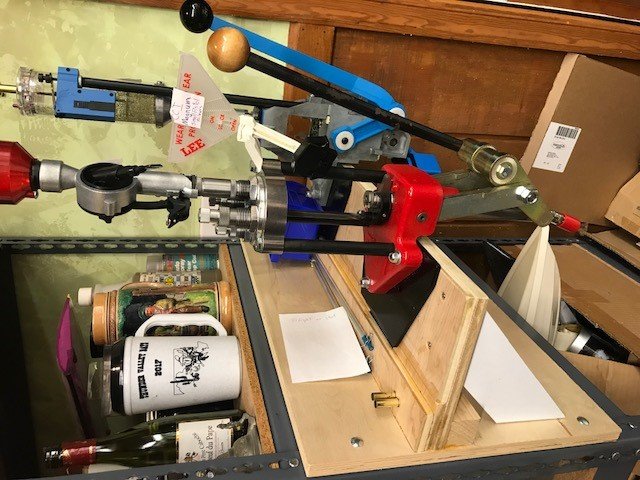

BLACKFOOT SASS #11947 Posted June 1, 2018 Posted June 1, 2018 I have a small bench for my presses, 16x39 inches. Have a 650 with case feeder, a Lyman T Mag and a Lee Turret press mounted on it along with a Hornady powder measure. Yes, it's tight but it works! Actually it is a jewelers bench that I made a few years ago when I was doing some silver work. Blackfoot

Joe Cross, SASS #13848 L Posted June 1, 2018 Posted June 1, 2018 I have each press, 550B, MEC 500, and an RCBS single stage, mounted (bolted or clamped) on portable tool tables. They can easily be moved around to suit my needs, but are usually occupy the same space all the time since I like my current setup. The bigger the table and area, the more stuff that accumulates and gets in the way. I like to keep only the items I need for the task at hand and avoid clutter. Other tools like a case trimmer, or extra press can be set up as needed. Joe Cross

Canton Chris Posted June 1, 2018 Posted June 1, 2018 I have the Inline Fabrication quick change system as well. I have 8 presses and tools mounted on plates and it is a snap to change them. I have a base mounted on a Frankford Arsenal portable loading bench that l use when I’m traveling and have two bases mounted at my bench at home. I really am glad I switched to this system and would never go back to the old way!
Red Eye Jim Posted June 1, 2018 Posted June 1, 2018 +1 for Frankford Arsenal portable bench. I've attached the Dillion 550C with a strong mount after modifying the base a little bit. I suspect I'll get another bench if I get another press, as I only have so much room in my study/office...
