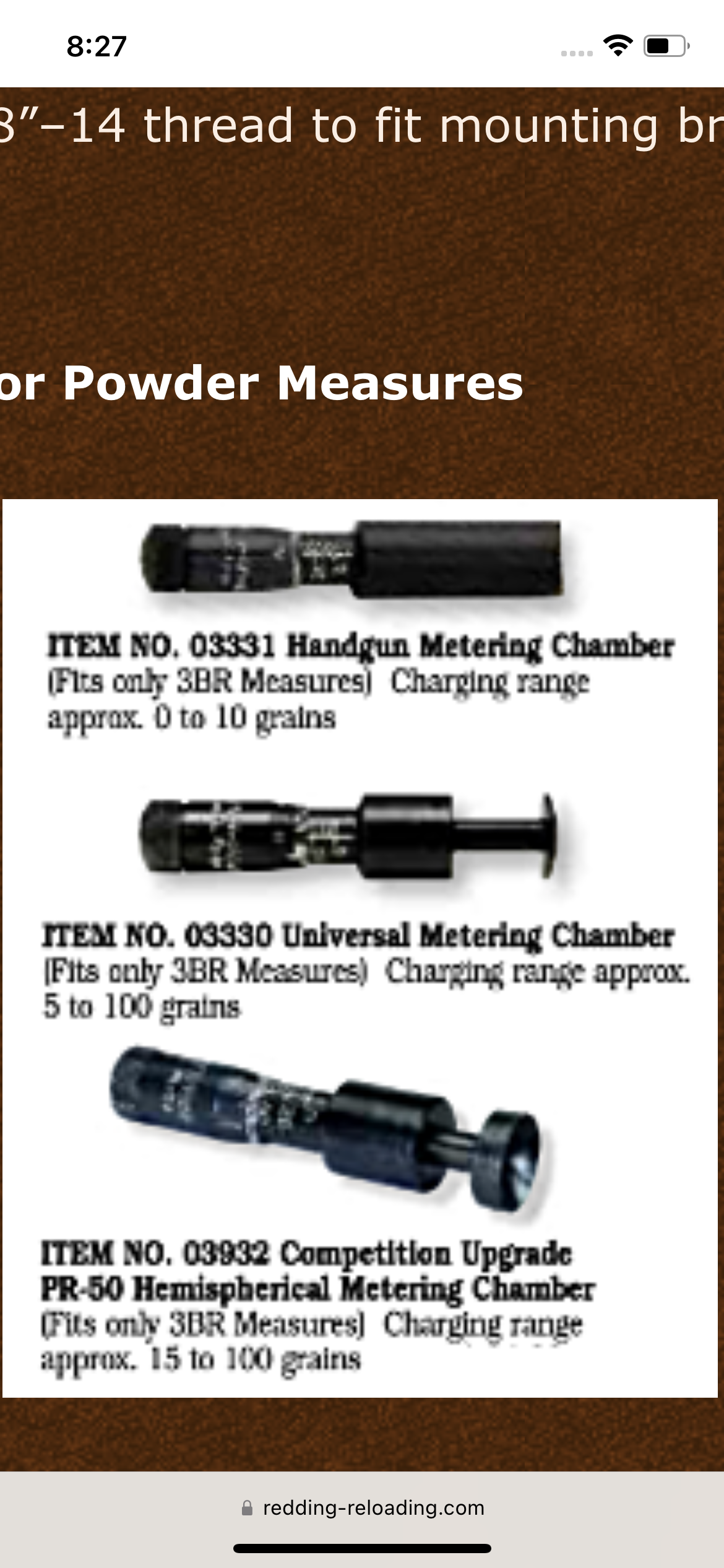

Sinola Kid Posted July 17, 2022 Posted July 17, 2022 Redding BR3 with the handgun metering option. Very good for 1-3 grains of 231, clean shot, or any other very fine type powder. use this for 2.5 gr 231 loads and 1.8 gr loads for pocket pistol 32s&w. not great for flakes like red dot though
Sam Sackett Posted July 17, 2022 Posted July 17, 2022 Plus 1 for the Redding #3. The newer ones have small and large metering chambers. I have 3 of the old original #3’s that had a standard metering chamber. The micrometer adjust is really nice. It allows recording a setting and going right back to the exact charge when I set up that caliber again. I have had no issue running 2 grains of Bullseye. This measure does not really like stick powder, but for flake and ball I’ll take it any day. Sam Sackett
Quiet Burp Posted July 17, 2022 Author Posted July 17, 2022 Hi Appreciate the answers......just to double check is this the one that is recommended for down to 1.5grains and 3.5grains and also suitable for rifle powders with the other 'insert' ??? It doesn't say "Model 3BR" https://safarifirearms.com.au/redding-model-3-powder-measure-with-both-chambers-sku-03200r/
Sam Sackett Posted July 17, 2022 Posted July 17, 2022 Here is a link to the Redding powder measures on the Titan website. They list the 3BR with the universal only and also one with both the universal and pistol measures. https://www.titanreloading.com/product-category/redding-reloading-equipment/redding-powder-handling-equipment/ Hope this helps. Sam Sackett
