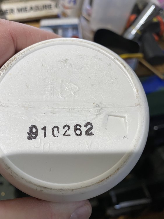

Cahawbakid Posted February 10, 2022 Author Posted February 10, 2022 Well, I’m still not sure about it’s exact shelf, but it’s at least this long. This bottle is OLD. I loaded 10 rounds today 45CS, Federal Lp primer,1.3 cc by volume. I didn’t put them across the Chrono but they were consistent and snappy no Puffffffff on any of them
Cowtown Scout, SASS #53540 L Posted February 10, 2022 Posted February 10, 2022 1 hour ago, Cahawbakid said: Well, I’m still not sure about it’s exact shelf, but it’s at least this long. This bottle is OLD. I loaded 10 rounds today 45CS, Federal Lp primer,1.3 cc by volume. I didn’t put them across the Chrono but they were consistent and snappy no Puffffffff on any of them That is not APP it is the old Clean Shot. So it is old.

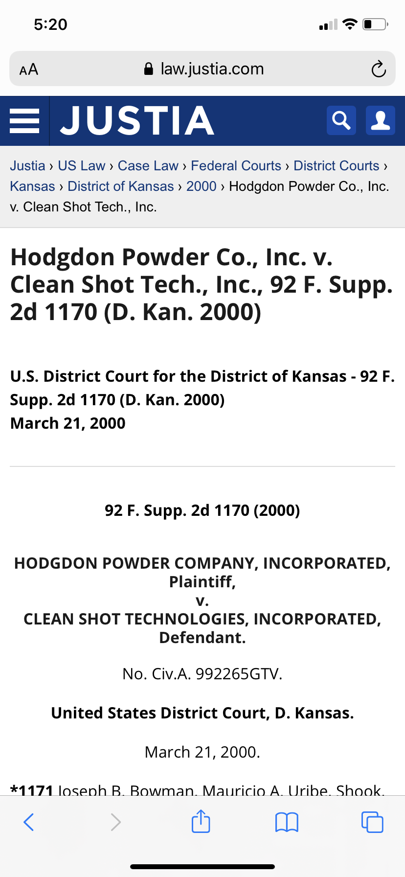

Cahawbakid Posted February 10, 2022 Author Posted February 10, 2022 Same thing ,minus law suit over the name or something to that effect. Perchlorate based propellant

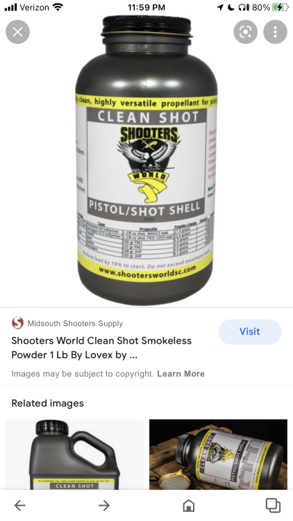

The Original Lumpy Gritz Posted February 10, 2022 Posted February 10, 2022 Agree 110%, that is not APP. OP, what made you think it was APP, when the label clearly shows otherwise. OLG
Cahawbakid Posted February 10, 2022 Author Posted February 10, 2022 Help your self, same stuff. I also want no confusion with the fine Lovex product being currently sold in the US under a similar name
Scarlett Posted February 11, 2022 Posted February 11, 2022 APP OWNS the name Clean Shot and it was what is now APP… chemical components etc may not be exact. Those OLD bottles ought not confuse anyone. ShootersWorld Clean Shot SMOKELESS powder, imported from Czech Republic, manufactured by Lovex, has been around for 6 years. Picture of one pound jar for reference. Info below jar is from Midsouth Shooter Supply website. Hugs! Scarlett PS FULL disclosure… I am a distributor for Shooters World and the SASS Rep for APP. NOTE* Shooters World LLC imports, distributes and supports Lovex propellants in the United States. Reloading data has been generated both with European CIP and American SAAMI methods. Both organizations recognize mutual safety in the assessment of pressures and velocities, despite their different methods. When loading with Shooters World propellants, please utilize only data published by Shooters World LLC or Lovex. Comparisons to other propellants are meant strictly to convey relative burn rates, and have no bearing upon specific recipes. All available reloading data may be found by following the links below, highlighted in RED.
