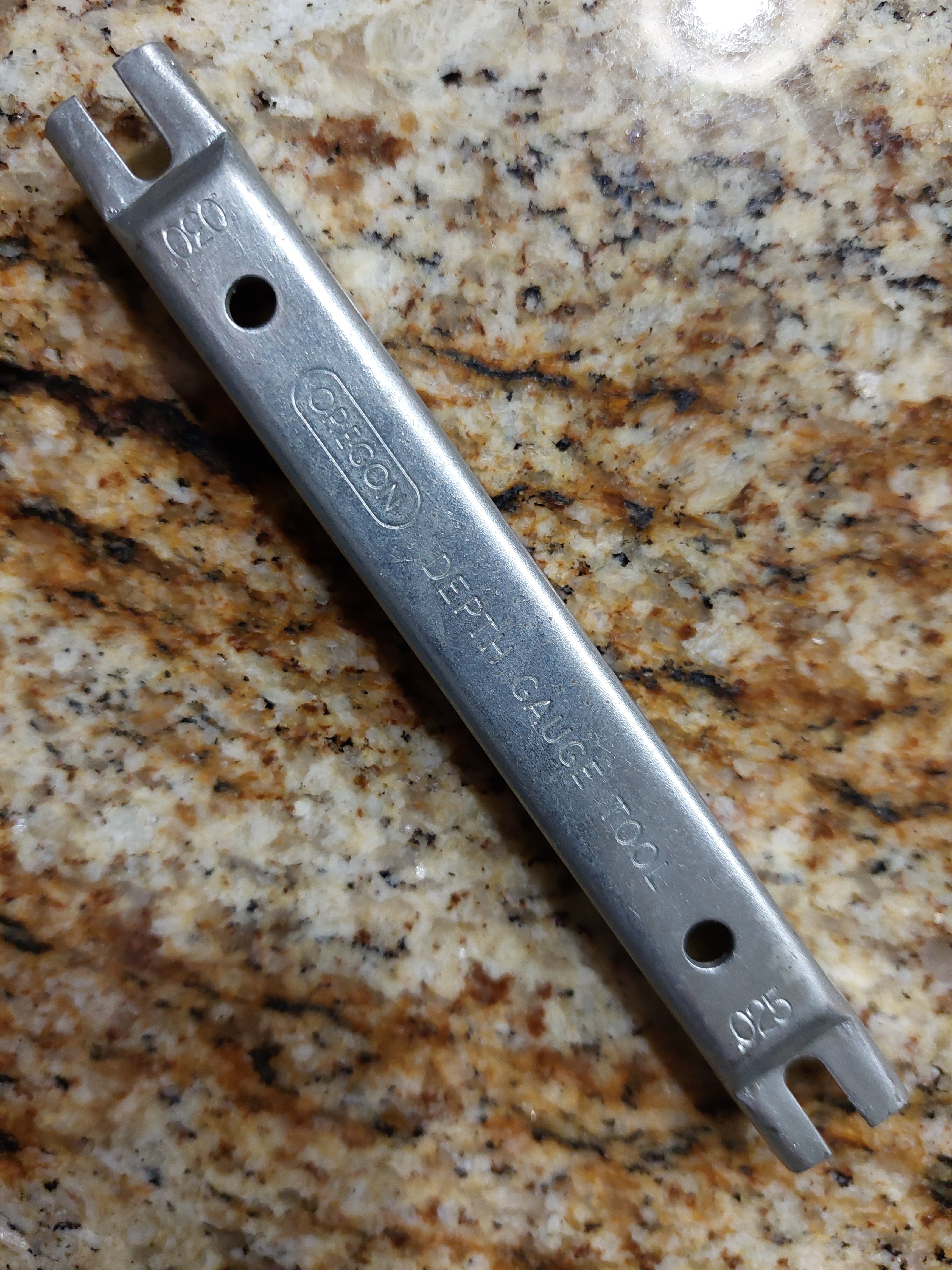

Preacherman Posted November 8, 2021 Posted November 8, 2021 I like to use a chain saw sharpening depth Guage. Works great with a vise, of course.

Sedalia Dave Posted November 10, 2021 Posted November 10, 2021 On 11/7/2021 at 7:05 PM, Preacherman said: I like to use a chain saw sharpening depth Guage. Works great with a vise, of course. What model gauge is that?
Preacherman Posted November 10, 2021 Posted November 10, 2021 Or another, I don't think it matters, just an Oregon tool. Get at home depot, Lowes, etc.
