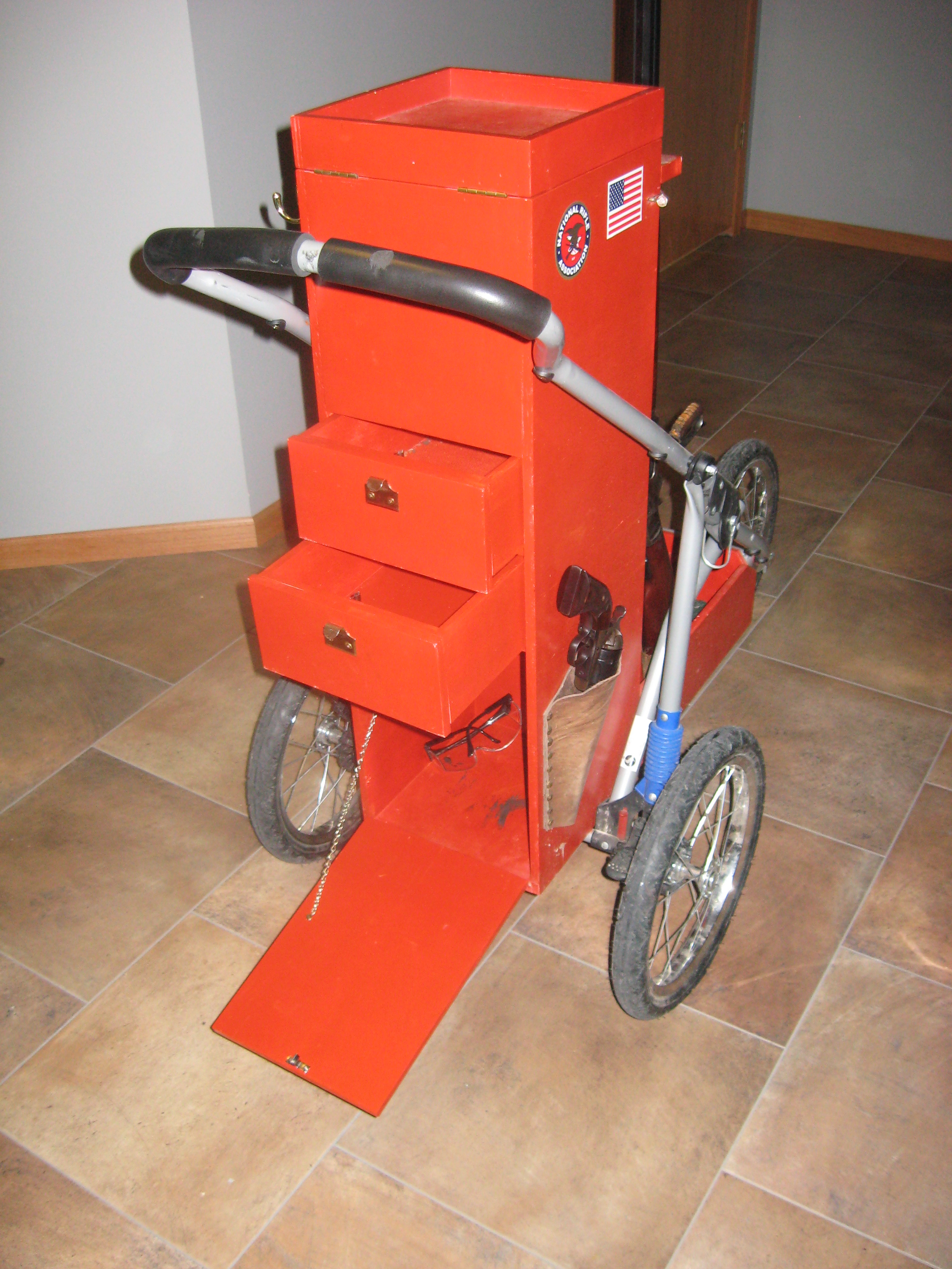

Chancy Shot, SASS #67163 Posted April 13, 2021 Posted April 13, 2021 I used the red one for several years. The top compartment was used for ammo. The drawers and bottom compartment for stuff. The big disadvantage was it does not fold. I drive a minivan and it worked great. I could load it by myself with everything on board. Chancy

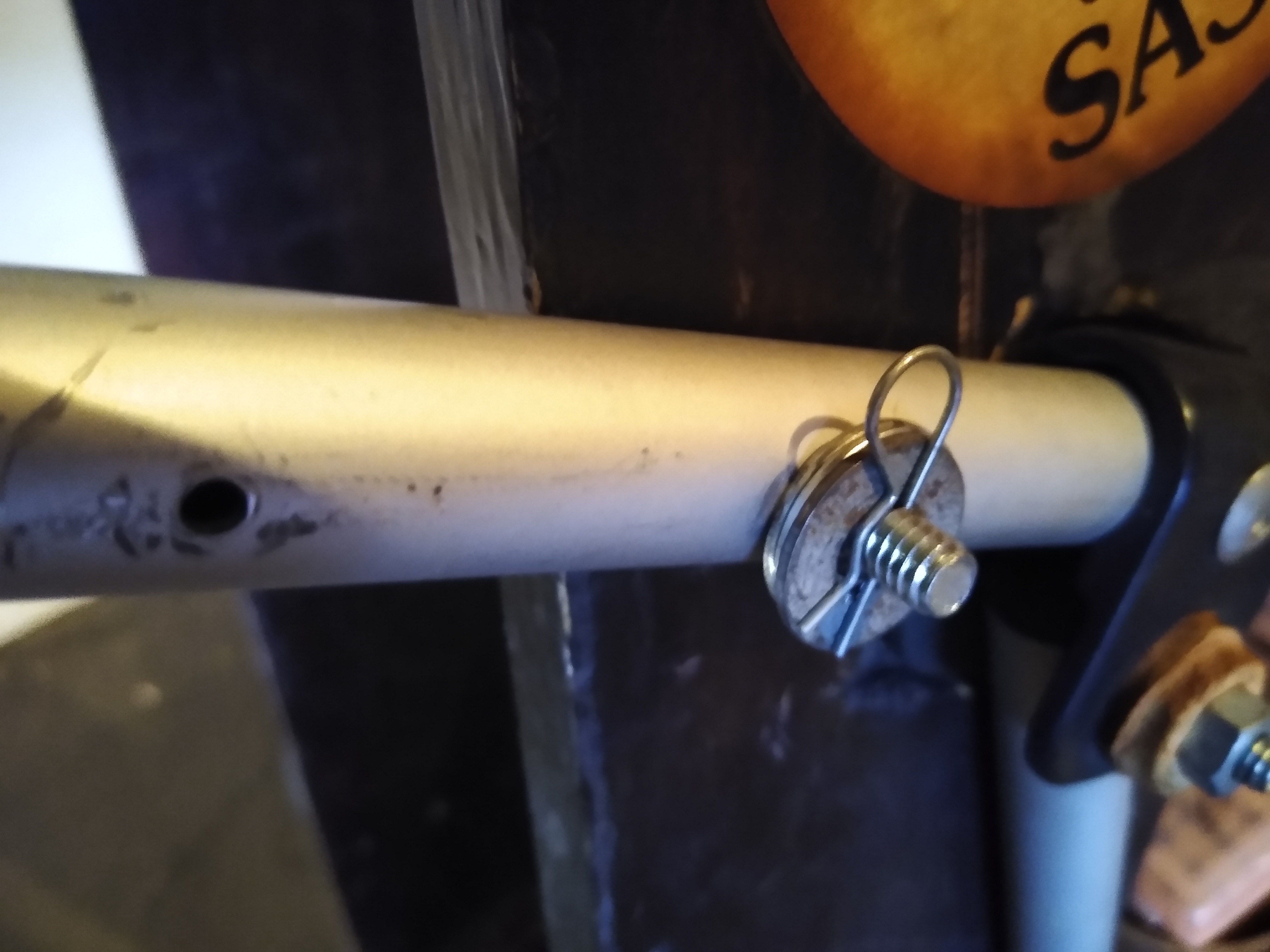

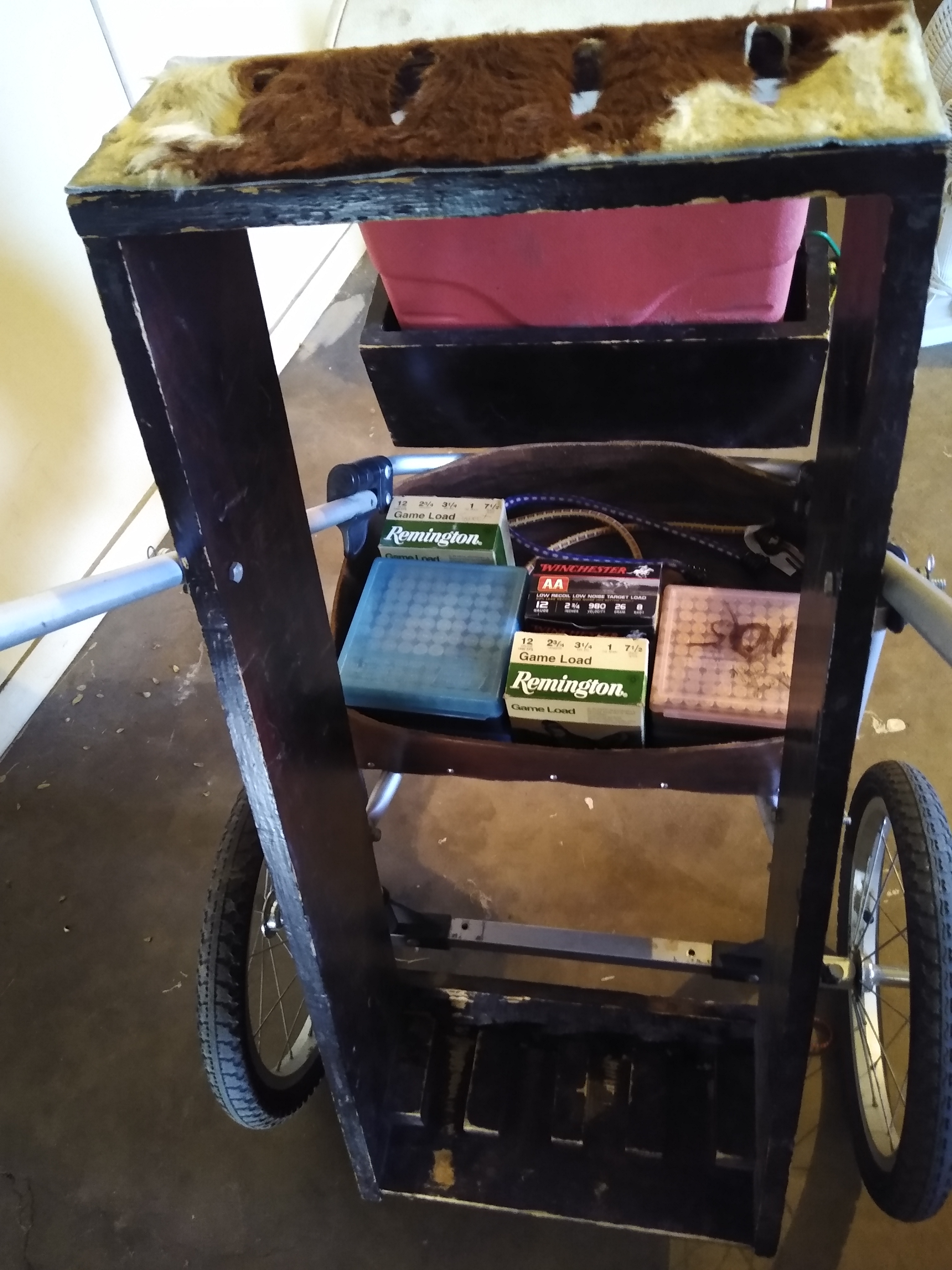

Go West Posted April 15, 2021 Posted April 15, 2021 This jogger was $20 and the rest was cobbled from scrap wood and leather. The frame holds 4 long guns and is connected to the chassis with bolts drilled with a small hole and quick release pins lock it in place. I used two bolts on top and one on the bottom. The removable tray is wood with leather sides and holds ammo. The cooler box also comes off and the cart folds down. This will fit in a subcompact car trunk with your gun bags, chairs, etc. The large wheels will roll over anything. I attach canvas bags to the handle for empties. I no longer disassemble this since we got a truck and bungee it in the bed. The cowhide top board has holes for the barrels and the bottom board has small wooden blocks to keep the butts separated. I've toyed with the idea of a redesign for aesthetic purposes, but haven't got around to it. I may drill a hole or two for squib rods.

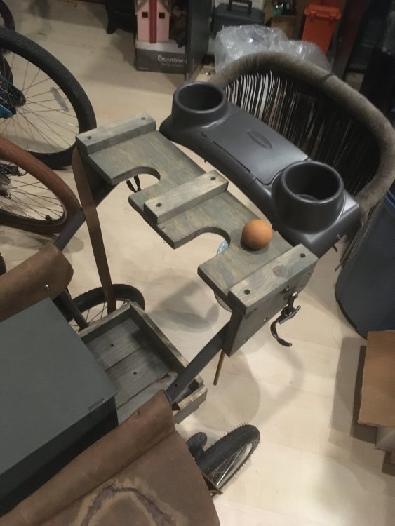

Mister Badly Posted April 26, 2021 Posted April 26, 2021 This is the barrel holder on my baby trend $30 stroller. Four tie wraps hold it on
Mister Badly Posted April 26, 2021 Posted April 26, 2021 That's my butt holder. Lol. Had to flip the axle to let it hang down straight.
Mister Badly Posted April 26, 2021 Posted April 26, 2021 Attaches with 2 carriage bolts and threaded knobs. Other than flipping the axle this is a bone stock unmolested stroller
Mister Badly Posted April 26, 2021 Posted April 26, 2021 This piece sits in front of the uprights and rests on the diagonal bars
