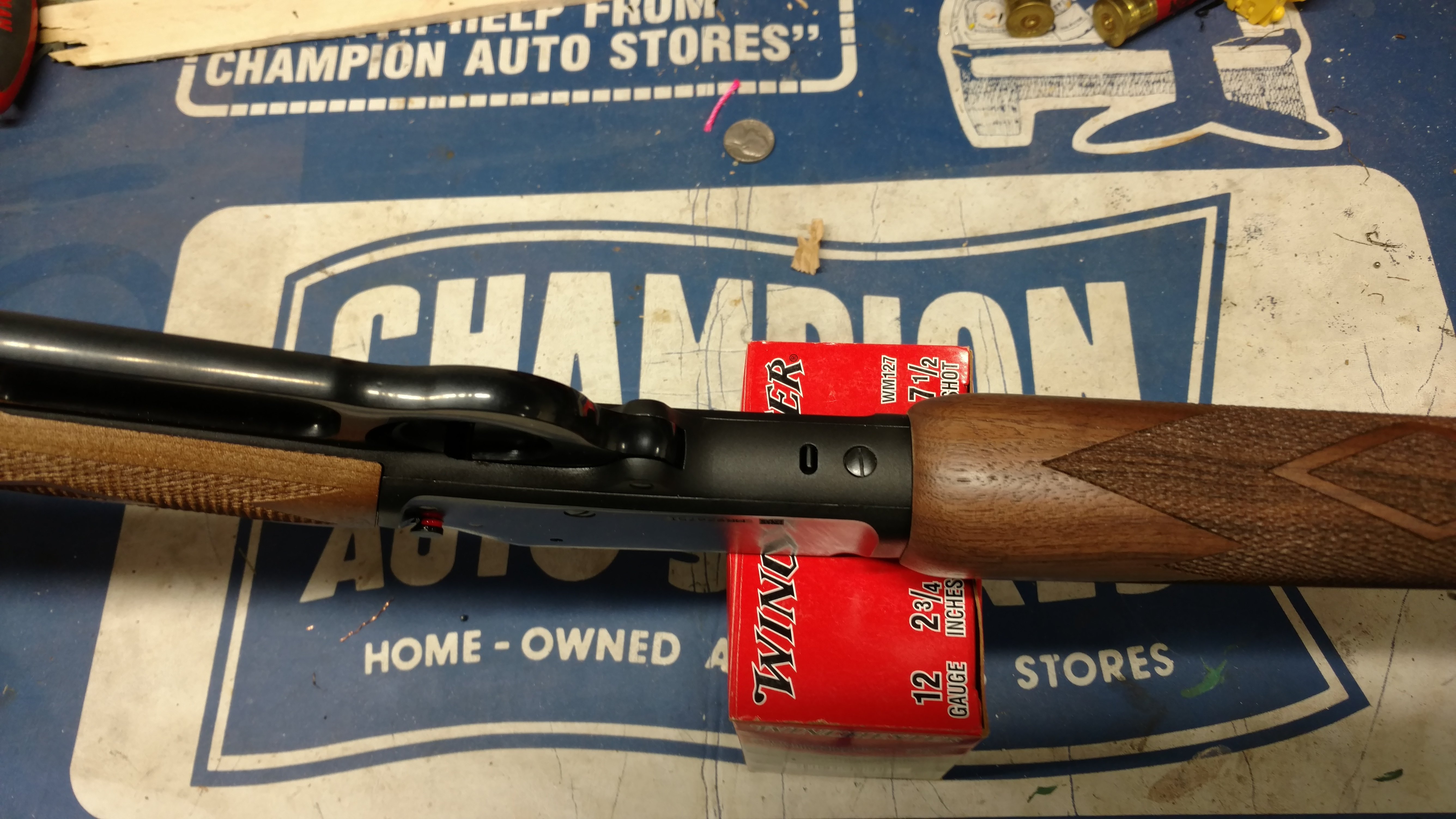

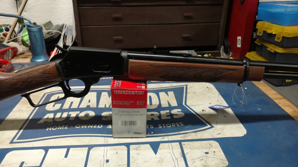

JP McLintock Posted May 1, 2020 Posted May 1, 2020 The Mrs. Just picked up her new production Marlin 1894cs, in 357. The fit, finish, and function seem to be very good. I'll post some pictures after I can get some good photos and a range session.
The Original Lumpy Gritz Posted May 1, 2020 Posted May 1, 2020 13 hours ago, a d texaz said: JP please post pics asap. AD Along with functionality and details of your ammo. OLG
JP McLintock Posted May 2, 2020 Author Posted May 2, 2020 Had the Marlin to the range tonight, run about 50 rounds through it, a couple failure to eject, but I think the Mrs. wasn't using enough authority when cycling the action., The picture of the target was the first few shot at about 30 yds. Olg, 3.5 gr Clay's, 125 gr rnfp, 1.440 OAL, I did notice that some of my dummy rounds that were a bit shorted didn't feed as well, and 357 snap caps fed just fine. According to the date code it's March 2020 production. The checkering isn't that crisp, but I think it's laser cut.
