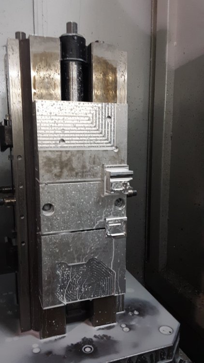

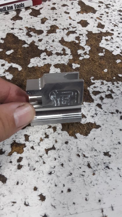

evil dogooder Posted July 11, 2019 Posted July 11, 2019 New parts just in time for mn state this weekend They won't be hard coated in time but I'll be able to do a little test and evaluation tomorrow during side matches
Red Eye Jim Posted July 11, 2019 Posted July 11, 2019 Lifters, right? Remind me again why these are better than my stock ones. (I've got a .357 carbine and a .45 short rifle)
The Original Lumpy Gritz Posted July 11, 2019 Posted July 11, 2019 7075T6 I hope. ED-Is this your machine? Really suggest a mil spec hard anodize. OLG
evil dogooder Posted July 11, 2019 Author Posted July 11, 2019 1 minute ago, Red Eye Jim said: Lifters, right? Remind me again why these are better than my stock ones. (I've got a .357 carbine and a .45 short rifle) Less resistance, plus I'm making some for originals that you just can't get anymore. We plan to offer complete stainless steel 73s eventually so we need to learn how to make the parts

evil dogooder Posted July 11, 2019 Author Posted July 11, 2019 4 hours ago, The Original Lumpy Gritz said: 7075T6 I hope. ED-Is this your machine? Really suggest a mil spec hard anodize. OLG I've got a few different ones made. From brass to titanium , aluminum and some alloys. They will be hard anodized when I'm happy with how the design is. Not my machines. My boss had given me free reign to start working on guns and parts. We have the paperwork in to manufacture them so whenever it gets back from the gov. We will be ready to sell. We already make parts for some gun companies.

Doc Shapiro Posted July 12, 2019 Posted July 12, 2019 I could use an aluminum lifter for a .38 '73. What do you charge for those? Are they drop in, or do they need some fitting? Note, I'm not scared of some fitting. Shoot me a PM. Doc
evil dogooder Posted July 12, 2019 Author Posted July 12, 2019 7 hours ago, Doc Shapiro said: I could use an aluminum lifter for a .38 '73. What do you charge for those? Are they drop in, or do they need some fitting? Note, I'm not scared of some fitting. Shoot me a PM. Doc Doc right now we are looking for 5 people to demo one and give us feed back on them.. if your interested in this send me a PM. We are still tweaking a few dimensions to make it a drop in fit for any rifle. The last one off the line yesterday at 4:23. With a little filling to the channel with a jeweler's file i had it in the rifle and working by 4:28. Just in time to punch out for the day. This morning I swapped it out in three rifles. It fit and functioned as is in all three. When up and running we expect the price for a hard anodized aluminum .38 to be around $50 ish

Doc Shapiro Posted July 12, 2019 Posted July 12, 2019 1 hour ago, evil dogooder said: Doc right now we are looking for 5 people to demo one and give us feed back on them.. if your interested in this send me a PM. We are still tweaking a few dimensions to make it a drop in fit for any rifle. The last one off the line yesterday at 4:23. With a little filling to the channel with a jeweler's file i had it in the rifle and working by 4:28. Just in time to punch out for the day. This morning I swapped it out in three rifles. It fit and functioned as is in all three. When up and running we expect the price for a hard anodized aluminum .38 to be around $50 ish I tried to send you a PM and got a message that you can't receive messages. Once you have one ready for testing, let me know. Doc
Cheyenne Ranger, 48747L Posted July 12, 2019 Posted July 12, 2019 ED how long does it take to machine one, from start to finish? any off-machine work before? (probably get it to the overall dimensions)
