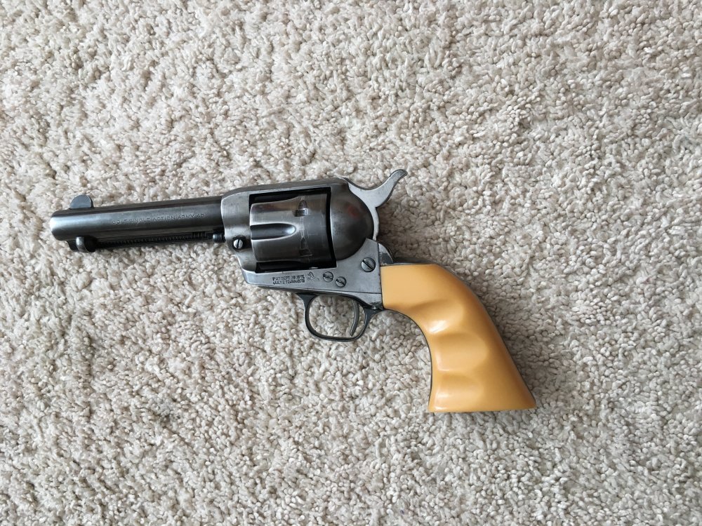

H. K. Uriah, SASS #74619 Posted April 26, 2019 Posted April 26, 2019 Sorry, I can't resist. Behold, a Greener, a big loop 92, and a pair of Colts. I need to redo this pic
