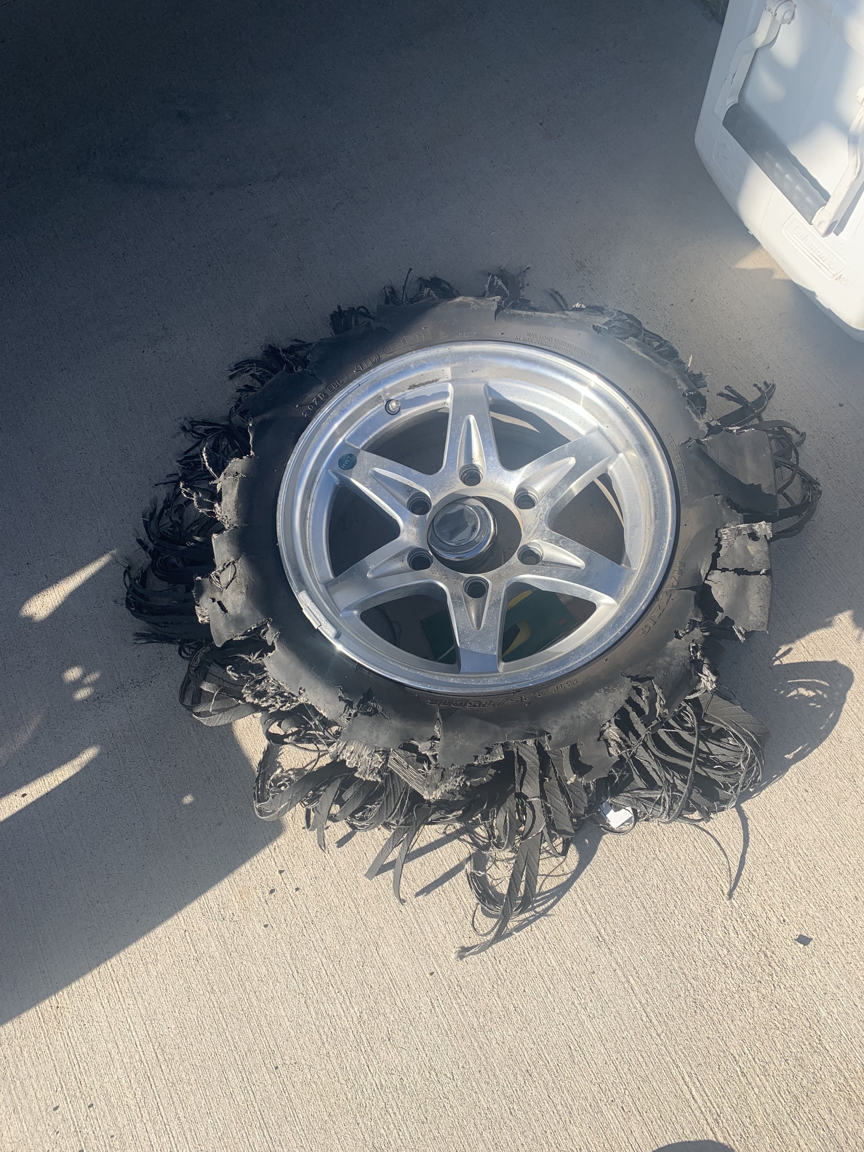

Big Sage, SASS #49891 Life Posted August 1, 2023 Posted August 1, 2023 I have several trailers (26" Travel Trailer, 20' covered utility trailer, 18' boat trailer and a 20' tilt bed gravel/dirt hauler) and I am tired of all the BS out there about tire life. Everywhere you look everyone say replace them every 5 years. I think it's a marketing ploy by the sellers to get you to buy new tires sooner. My travel trailer is a 2012 26' Denali that I bought new. It is always stored indoors when not in use. I just returned from a 600 mile round trip for a weeks fishing. The state highway was being repaired for about 20 miles. It is gravel and rocks and I drove no faster than 15 mph. I blew a trailer tire that I think a sharp rock punctures. I run Maxxii 10 ply tires that I bought new in 2014 (yep 2014!) and they have a little less than 35,000 miles on them. The remaining 3 are in great shape (about 60% tread remaining, no bulges or sidewall cracks) and I am going to replace the ruined one only. Heaven forbid!!!!!
Old Man Graybeard Posted August 1, 2023 Posted August 1, 2023 They deteriorate in time...doesn't make any differance stored inside or tires covered. A friend of mine just found out the hard way. He blew two on one trip. Chinese tires are one of the worst. My friends tires looked like new...no checking or nothing. When it comes to trailer tires especially...looks can be decieving.

Texas Joker Posted August 1, 2023 Posted August 1, 2023 Tires NEED to be run to keep the chemicals intermixed. rubber that isn't run up to speed often like trailer tires can degrade faster. 5-7 years is normal tire life regardless of available tread. Not to put too fine a point on it your 10 year old 10 ply tire failed and it's a sharp rocks fault?
The Original Lumpy Gritz Posted August 1, 2023 Posted August 1, 2023 Old tires develop hard spots and that's the main source of tire failure. Is the price of 3 tires worth the damage those old tire will cause?

Chas B. Wolfson, SASS #11104 Posted August 2, 2023 Posted August 2, 2023 The industry standard is replacement at six years old. Many tire retailers will not repair a tire with a date code over six years due to liability. That should tell you something right there. What the rest of us do regarding tire replacement on an RV follows the standard of four year replacement. As previously stated, tires on an RV will not retain structural integrity due to typically long periods of non use. The majority of RV tire failures occur due to internal degradation and not due to any external visual signs. So please consider this. It is one thing to have a tire failure while driving slow through road construction. It is a totally different situation when traveling at highway speeds. Not only are you putting yourself at risk, but have you thought about others close to you on the highway? It is not guaranteed that you will be able to have control of your rig if a blowout happens. And what if pieces and parts of the blown tire hit another vehicle, which can include a motorcycle, and cause that vehicle to loose control possibly leading to injury or death. Take a moment to consider the implications to others with regards to your "thriftiness". And boy howdy, the lawyers for the victims will have a field day with the date codes on those tires. Good luck with that. Not to mention having to live with that the rest of your life. Industry standard for wheel bearing service/repack is 8,000-10,000 miles. I am not even going to ask. Happy trails, Chas B
