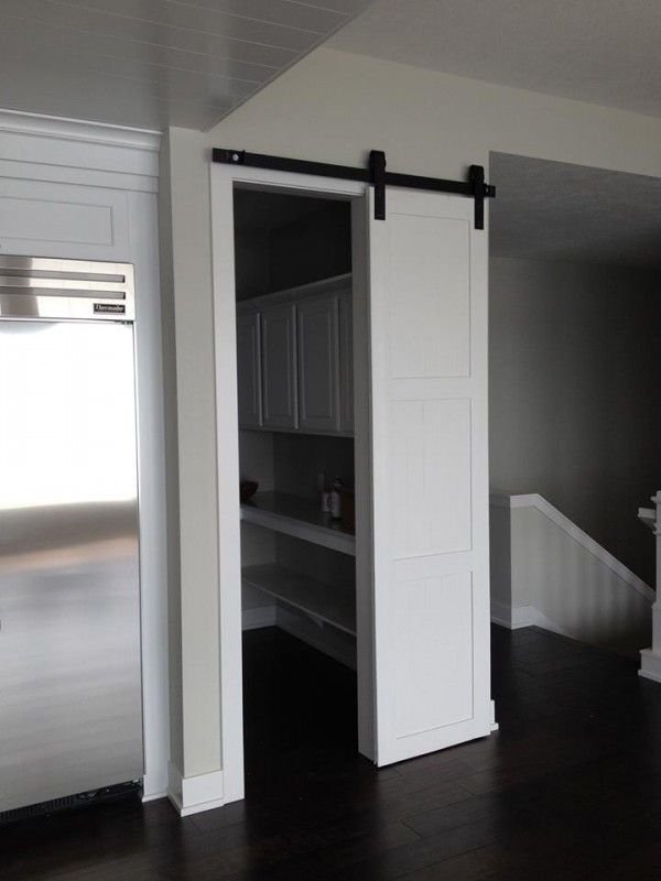

Joe LaFives #5481 Posted November 26, 2021 Posted November 26, 2021 I like the Pocket door Idea, Also a lot of folks are installing "barn doors" which are external.
