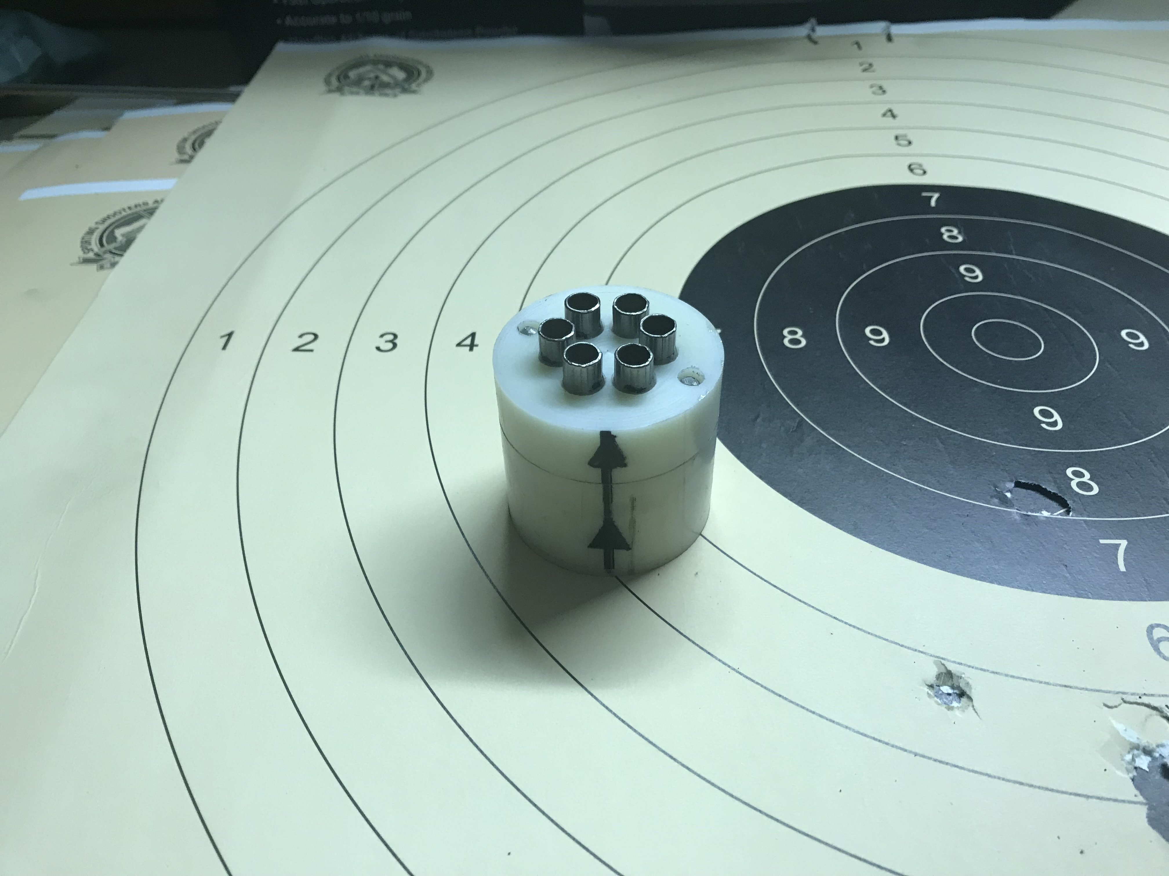

Major Crimes Posted November 2, 2020 Posted November 2, 2020 This is a speed loader a friend made for me. Diamond Curley has the metal version now

Diamond Curly SASS#57086 Posted November 2, 2020 Posted November 2, 2020 1 hour ago, Major Crimes said: This is a speed loader a friend made for me. Diamond Curley has the metal version now I like my speed loader . Thanks again Major Crimes
doc roy l. pain Posted November 2, 2020 Posted November 2, 2020 10 hours ago, Major Crimes said: This is a speed loader a friend made for me. Diamond Curley has the metal version now Can you lay a cylinder over that and tip it up to load all five chambers with powder at once? Like to find out more about this

Major Crimes Posted November 3, 2020 Posted November 3, 2020 11 hours ago, doc roy l. pain said: Can you lay a cylinder over that and tip it up to load all five chambers with powder at once? Like to find out more about this Yes that's how it works. The cavity holds 20g of black (you can make it to what you want) you then place the cylinder on the top and turn it all upside down to fill the chambers in the cylinder. The really clever bit is if you use filler then you have three segments and you put the filler in first then put the next segment on and fill that with BP. Then you put the top on, place the cylinder on and tip it all upside down. As most of the guys are saying when you use straight powder there isn't a big time saving but to some it helps. These were made for target shooting not Cowboy so that's why it has 6 chambers. You can make them with whatever you want (or put a foam ear plug in the 6th chamber). The plastic version is a little less maintenance heavy as it doesn't rust.
