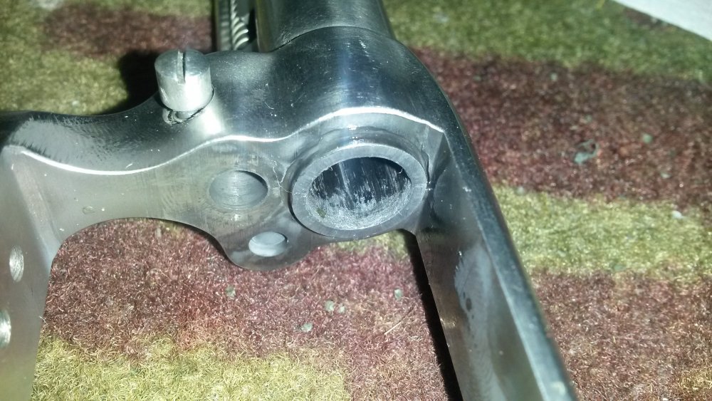

Brazos Bo Posted October 22, 2019 Posted October 22, 2019 I was curious if the coated bullets made a difference in regard to the lead build up I had been fighting with, so I decided to see for myself. 30 rounds with Coated bullets and 30 rounds lubed bullets. This was the results. Hands down winner was the coated bullet. See pics below.
Eyesa Horg Posted October 22, 2019 Posted October 22, 2019 1 hour ago, Brazos Bo said: I was curious if the coated bullets made a difference in regard to the lead build up I had been fighting with, so I decided to see for myself. 30 rounds with Coated bullets and 30 rounds lubed bullets. This was the results. Hands down winner was the coated bullet. See pics below. That is exactly the issue I had with hard cast bullets as in Chey-Cast. Went to Ringer Bullets and Missouri with a BHN of 12 and no more leading at all. Also good luck with Desparado Cowboy, but too much lube on em kept clogging my seating die. I now use coated and haven't had an issue except for fouling in the middle of my pistol barrels. Not sure if it's the coating or if I'm over crimping and getting blow by B4 the bullet obturates. It cleans out easy, so it's not lead. I'm using C45S cases with a taper crimp & wonder if I'm crimping too much and shrinking what little bullet there is in the case. Using 160gr. bullets. Softer bullets make an amazing difference in leading at our velocities.

watab kid Posted October 23, 2019 Posted October 23, 2019 that is a noticeable difference , thanks for the info and the photos , it made it far more understandable ,
