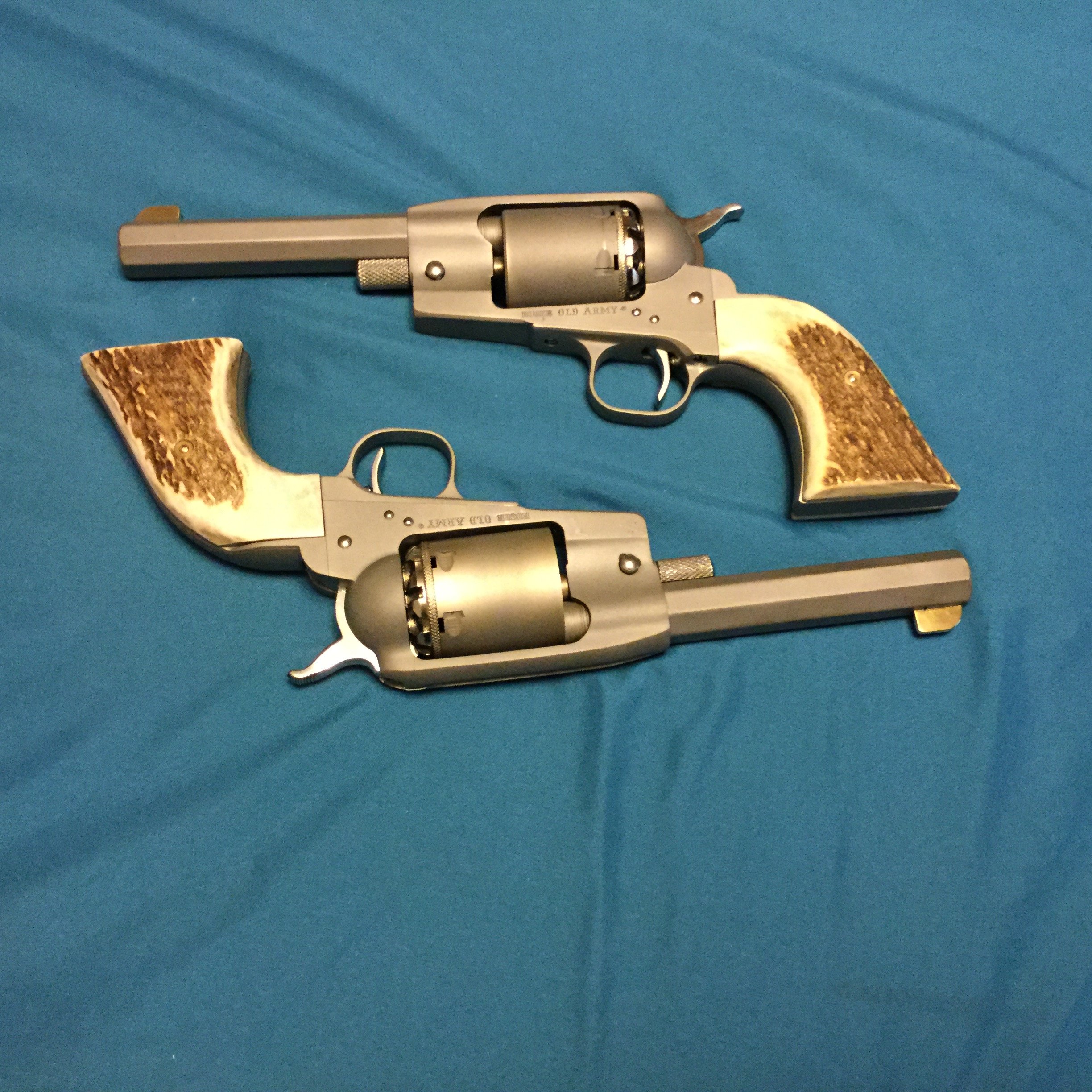

Warden Callaway Posted June 20, 2024 Posted June 20, 2024 Not mentioned is the Ruger Old Army with conversion cylinders. I have a pair but have not shot them yet.

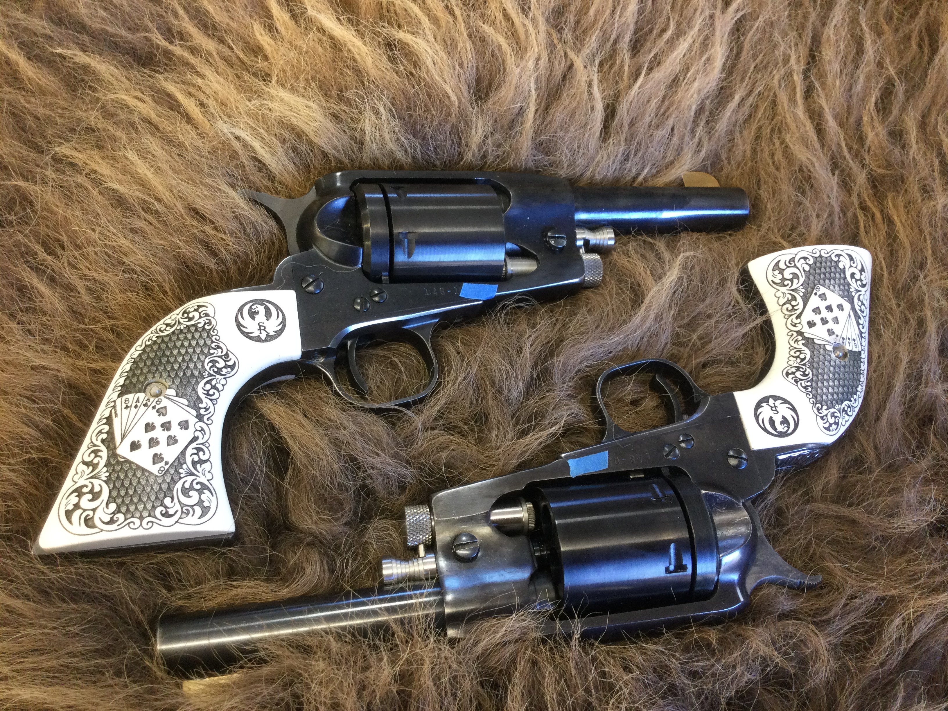

Yul Lose Posted June 21, 2024 Posted June 21, 2024 5 hours ago, Warden Callaway said: Not mentioned is the Ruger Old Army with conversion cylinders. I have a pair but have not shot them yet. Very nice, here are a couple of pairs of mine.

Texas Jack Black Posted June 21, 2024 Posted June 21, 2024 11 hours ago, Yul Lose said: Very nice, here are a couple of pairs of mine. Very nice
