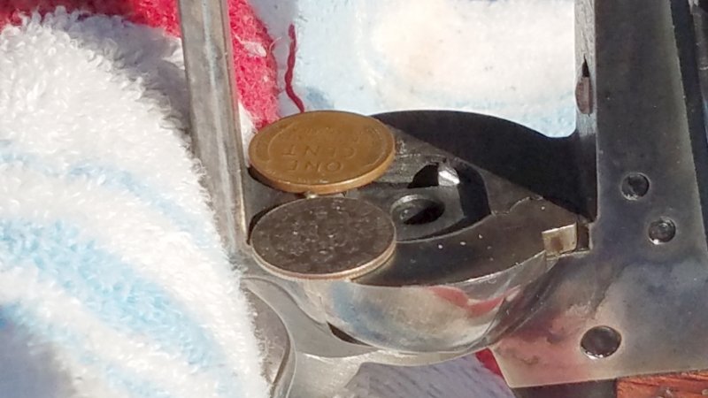

Warden Callaway Posted October 12, 2023 Posted October 12, 2023 Firing pin protruding measure for 11 cents. Taller than a dime, shorter than a penny. Endshake is being able to push cylinder forward and back. Shouldn't more than the slightest amount. If it push to the point it clanks, it's likely too much.

Dred Bob Posted October 15, 2023 Author Posted October 15, 2023 On 10/12/2023 at 3:18 PM, Warden Callaway said: Firing pin protruding measure for 11 cents. Taller than a dime, shorter than a penny. Endshake is being able to push cylinder forward and back. Shouldn't more than the slightest amount. If it push to the point it clanks, it's likely too much. thanks for the pic. very helpful. I shipped it to Taylor Friday so I can't compare it now. The cylinder was tight and I did try to swap it with another cylinder although that wouldn't help if it was the frame
