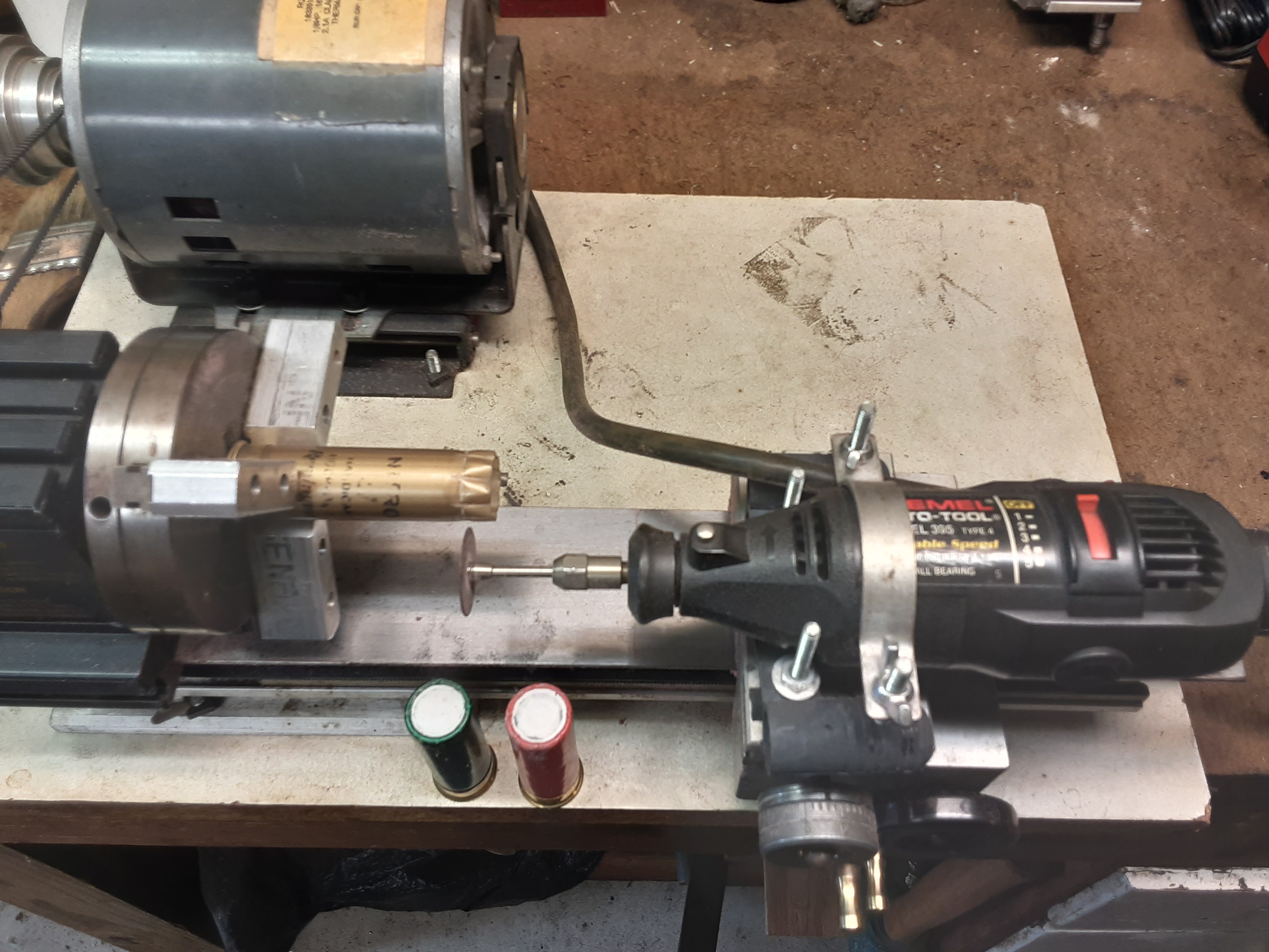

Abilene, SASS # 27489 Posted January 14 Share Posted January 14 Recently there was a topic about salvaging components from shotshells, and several tools were mentioned which cut the hull open. Seems like one of those might be good for cutting off the crimp folds. Quote Link to comment Share on other sites More sharing options...

Lucky R. K. Posted January 17 Share Posted January 17 On 1/14/2023 at 6:29 PM, Abilene, SASS # 27489 said: Recently there was a topic about salvaging components from shotshells, and several tools were mentioned which cut the hull open. Seems like one of those might be good for cutting off the crimp folds. This is what I use. 2 Quote Link to comment Share on other sites More sharing options...
