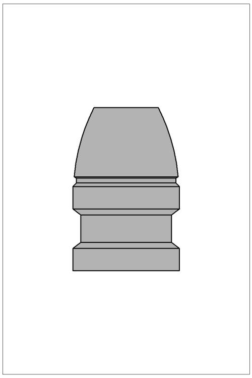

"Big Boston" Posted November 20, 2022 Posted November 20, 2022 I was reading a FB post and the poster was having some accuracy issues with a 44-40 rifle. He was using 3f Swiss and his bullet was a Accurate 43-215C, of big lube design. I've got no experience with BP or with this bullet, but I am curious about the inherent accuracy of this design. This bullet designs claim to fame is for shooting clean, is it also an accurate design? With BP, does anyone have an accurate load that they'd like to share. BB

Sedalia Dave Posted November 20, 2022 Posted November 20, 2022 Yep need a lot more information. One big variable is bullet diameter. Most modern rifles have bores much larger than the original SAAMI specification of .427". I think Uberti uses the same barrel bore diameter for .44 Special / .44 Magnum as they do for 44-40 I have and Uberti 1860 and an 1866 in 44-40. Both need bullets of at least .429" if cast of soft lead and .430" if out of harder lead to shoot accurately. .427" bullets (which seems to be what a lot of casters are selling) will cause leading in them at CAS velocities. Ruger pistols in 44-40 are well known to have undersized throats that can cause accuracy issues.

Thunder Creek Kid Posted November 21, 2022 Posted November 21, 2022 I use a .430 big lube bullet over 35 grains of 2f or 3f. Shoots good for me in a Winchester Miroku model 73 24”, a Winchester Miroku model 66 20” and a Uberti 73 in a 20” barrel.
Gunner Gatlin, SASS 10274L Posted November 21, 2022 Posted November 21, 2022 .429 BIG LUBE Toggle, 24" Uberti '73, 35gr GOEX 2F...works great. GG ~

Lucky R. K. Posted November 23, 2022 Posted November 23, 2022 Dick Dastardly's Mav Dutchman bullet with a case of real black powder or 3.5 grains of Red Dot will give excellent results at cowboy distances if the cowboy does his part. The rifle is a Uberti 1860 Henry with a 20-inch barrel. Bullet is sized to .431. Lucky
Buckshot Sheridan Posted November 24, 2022 Posted November 24, 2022 Shot a 3” group at 125 yards last time at the range. Using the same bullet design. The limiting factor wasn’t the bullet, but more likely the sights on my ‘73.
