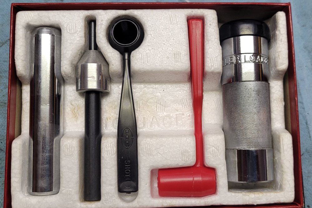

"Big Boston" Posted April 14, 2022 Posted April 14, 2022 Bought this kit just on the off chance my friend may sell me his 1901. 10 ga 2 7/8". Didn't come with the load card, but I have data from the older Lyman manuals. BB

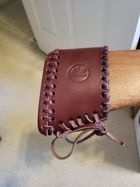

Horace Patootie, SASS #35798 Posted April 20, 2022 Author Posted April 20, 2022 Got my 10 gauge MEC today and this buttstock cover. Horace Order from Ballistic Products shipped today also. Horace
