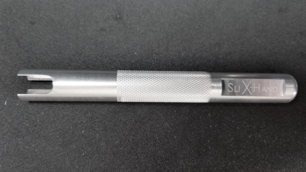

If you’re loading on the gun, another thing to save your hands is a SLIX hand or something like this that fits over the loading lever. A necessity for my 5” Navies.
Here are pics from the SLIX website:

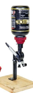

When I was shooting C&B, I tried the various flasks.  All seemed to have problems with the valve sticking.  Then I moved on to using the miniature plastic vials, filling them using a Lee Perfect Powder Measure.  Then I just skipped the plastic vials and loaded straight from the Lee unit mounted on my cart.  Much quicker and more accurate than a sticking valve flask.  They now make the Lee Perfect Powder Measure with an adapter that you can mount a larger jug of powder directly to so you can just upend it and dump the unused powder back in the bottle.  Of course, this requires that you remove the cylinder and can't recharge on the pistol, but I was using a Powder Inc bullet seater anyway so it didn't matter to me.  I liked wiping down the cylinder between stages anyway.  Scroll down the page below and you can see the bottle adapter.
https://leeprecision.com/perfect-powder-measure.html
On 1/1/2021 at 11:09 AM, Warden Callaway said:
Aha!, I got it, you converted it to pull to pick up the next charge and spring back to drop.  I have two of these measures but wouldn't want to give up one to make one like you show.
Lee Precision Perfect Powder Measure - New 2020 Model # 90058 | eBay
this looks promising for a cart mounted charger...
A large file handle works well also.

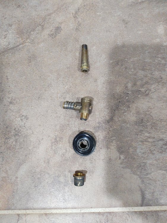

I was in the hardware store and picked up a couple of metric M10x1.0 hex nuts. I used a hole punch to cut hole in the cap of a Grafs black powder jug.  Extra nut on spout for show.
Does it work?
6 minutes ago, Tequila Shooter said:
Does it work?
It should.  I haven't tried it yet.  Maybe tomorrow.
I also picked up a couple of feet of plastic tubing to give cap shields a try. Cost 40 cents. I'll report back.
