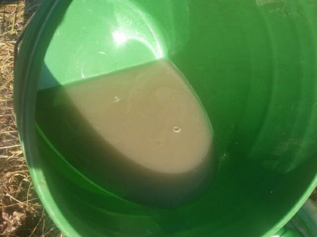

Warden Callaway Posted February 6, 2018 Posted February 6, 2018 I think reclaimed is just fine if it's clean and graphited I got some not knowing any better that was gray and filled with gray dust. I washed it a couple of times and it was still nasty. Here's what the water looked like. My local shot source, reclaimed, clean and graphited, is only $2/25 lbs less than new. Last time I priced it.
